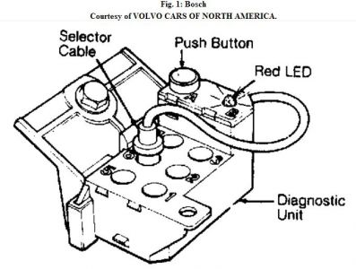

1990 Volvo 240 My car turns off when I press the gas.
THAYSELDEN
  • 1990 VOLVO 240
  • 4 CYL
  • FWD
  • 136,000 MILES
My car starts fine, but when I go to press the gas some tiomes it will shout off. What can this be?
Wednesday, August 12th, 2009 AT 6:52 PM

Hi thayselden,
Thank you for the donation.
Symptoms indicates a possible fault with the Mass Air Flow sensor or Throttle Position Sensor. I would suggest checking those.
Is the check engine light showing?

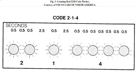

KHLOW2008
  • 41,814 POSTS
When the MIL shows, trouble codes would be stored and code retrieval would assist in understanding what is wrong. Here are the diagnostic procedures. Let me know the code that is retrieved.
SELF-DIAGNOSTIC SYSTEM DESCRIPTION
NOTE: Self-diagnostics for fuel system and ignition system are covered separately in this article.
The fuel injection system and ignition system feature a built-in self -diagnostic function for fault tracing. A common diagnostic unit, located in the engine compartment behind the left strut assembly, interfaces directly with either ECU. The diagnostic unit has a push button, a Red Light-Emitting Diode (LED) and a selector (coding) cable. See Fig. 1 .
https://www.2carpros.com/forum/automotive_pictures/192750_DiagnosticUnitAVolvo_1.jpg
Once the selector cable has been inserted in the correct slot, depressing the button once, twice or 3 times selects from one of 3 control (fault tracing) functions. Faults stored in ECU memory are read via a system of LED flashes. All fault codes have 3 digits, each capable of ranging from 1-to-4 digits. Since all codes have 3 numbers, each code requires 3 series of flashes. For easier reading, a 2.5-second interval separates each digit of the code.
Socket No. 2 in the diagnostic unit is used for fuel system testing. Socket No. 6 is used for ignition system testing.

1. Locate the diagnostic unit and remove its cover. Connect selector cable to socket No. 2. Turn ignition to ON position. Enter control function No. 1 (access codes) by pressing push button one time for at least one second and no more than 3 seconds. To enter control function No. 2, press push button 2 times for at least one second and no more than 3 seconds. To enter control function No. 3, press push button 3 times for at least one second and no more than 3 seconds.
2. Watch the Red LED and count the number of flashes in the 3-flash series. The flash series are separated by a 2.5 second interval. See Fig. 2 . Note all codes. Only 3 separate codes can be stored at once. If no codes are stored, the LED will flash a 1-1-1 to indicate the fuel system is operating properly.
https://www.2carpros.com/forum/automotive_pictures/192750_DiagnosticUnitAVolvoFig02_1.jpg
3. If a fault code is received, refer to the FUEL SYSTEM FAULT CODES table in this article. Depress push button again and check for additional codes. Depress push button a third time, if necessary. If the first code repeats, there are no other codes.
