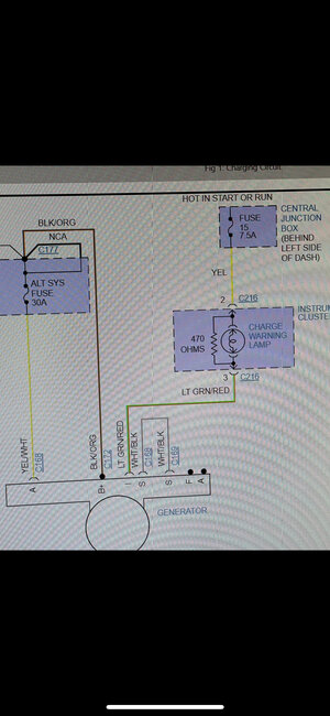

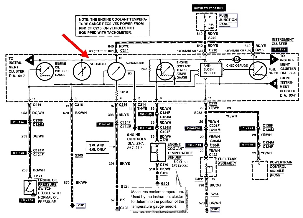

I removed my instrument gauge to replace them with aftermarket ones after an engine swap left my speedometer, tachometer and others not working.
Long story short, and still related to the factory wiring, the alternator is no longer charging, I believe because I have disconnected the voltmeter from the gauge cluster. I’m specifically curious if that is in fact, how the voltmeter works and if there’s a way to bypass the voltmeter gauge or if it is a necessary component of the charging system.

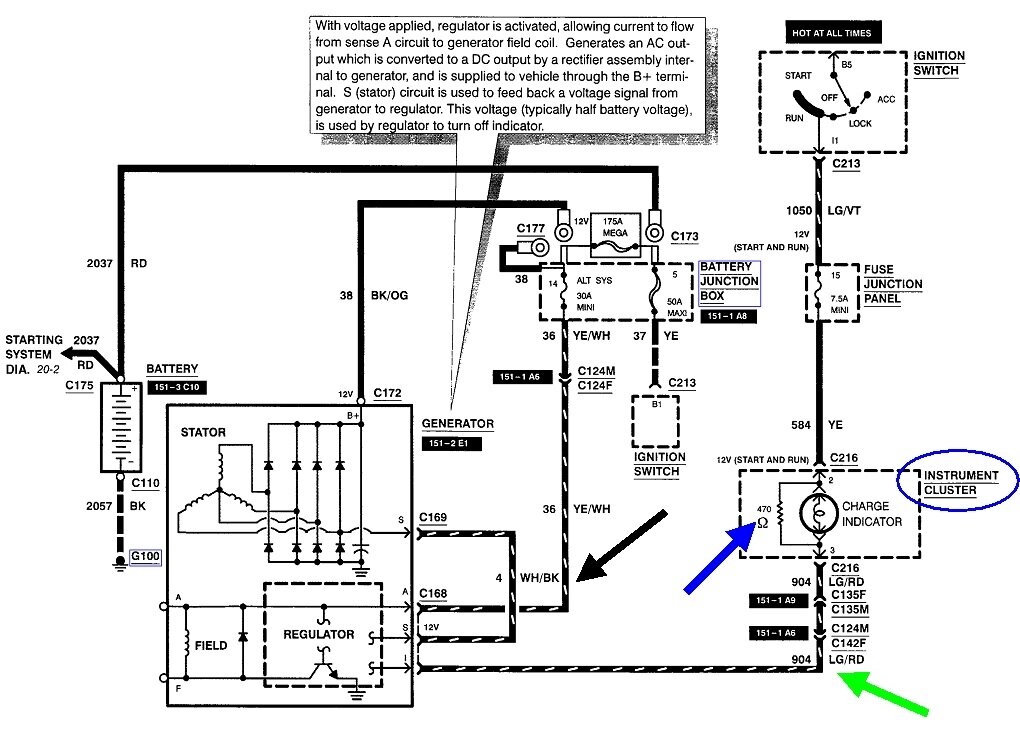

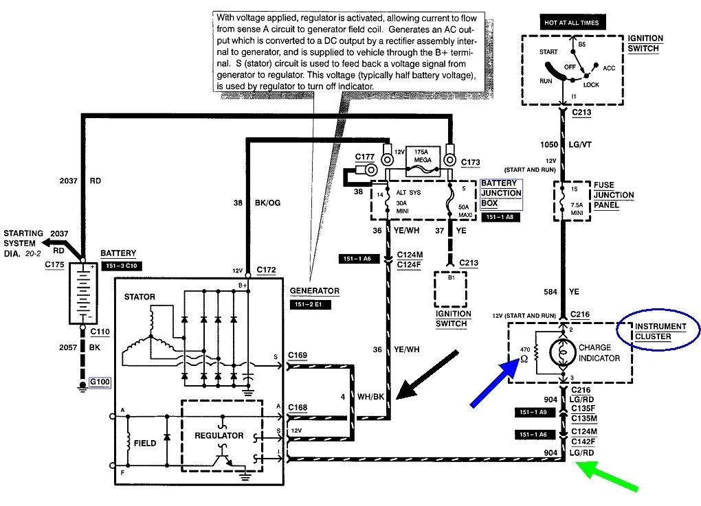

Not the voltmeter, but the instrument cluster is involved with the charging system on Ford and GM models. This first diagram shows the voltmeter just measures the voltage applied to the instrument cluster. The second one shows the entire charging system and the "Battery" warning light circuit coming from the instrument cluster. The third one repeats that bulb circuit in the instrument cluster.
What is needed to get this charging system started is a small amount of current flow through the warning light and then through the generator's internal voltage regulator. That's the wake-up signal that tells the regulator to turn on and start running the generator. Once that happens, a sample of the generator's output voltage, roughly 7 volts, appears on the white / black wire in the three-wire plug on the back of the generator. That tells the regulator the system is working and to put 12 volts back out on the light green / red wire to turn the "Battery" light off.
You also must have 12 volts all the time on the yellow / white wire in that three-wire plug. To be accurate, all of these voltages must be taken with that connector plugged in. Back-probe through the rubber weather seals next to each terminal to take the readings.
If you don't want to use a "Battery" light, or if the original one burns out, there is also a 470 ohm resistor, (blue arrow) that will pass enough current to get this system up and running. A 470 ohm is a very common value in electronics circles, but the value here is not critical. GMs use a 510 ohm resistor for the same purpose. Any value down to even 100 ohms will work fine. To prevent draining the battery, one end of that resistor must connect to any place that gets 12 volts with the ignition switch turned to "Run". The other end goes to that light green / red wire at the instrument cluster connector or at the three-wire plug on the back of the generator.
Normal operation is to start by measuring the voltage on that light green / red wire with the ignition switch on "Run", engine not running. You'll find very close to 2.0 volts. The other ten volts is across the lit up warning light, and / or across the 470 ohm resistor. Next, with the engine running, you will find full system voltage is on the light green / red wire. That should be between 13.75 to 14.75 volts. That will turn the "Battery light off because now there's full system voltage on both sides of it. The difference is 0.0 volts so the bulb turns off.

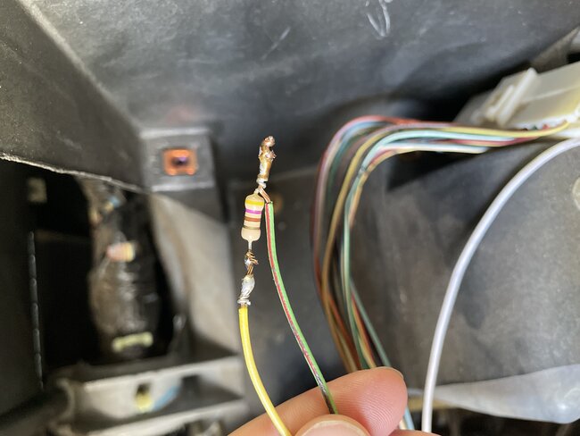

Beautiful. Thanks so much. My engine wire harness is from a 1998 Explorer 5.0, so I’ve only got a yellow/white and Lt-grn/red on the voltage regulator of the alternator. The lt grn red still goes to the charge indicator light so I will bypass from that to the fuse side utilizing a 100-470ohm resister and hopefully we’ll be back in business.
It was running fine with the 5.0 before removal of the gauges so this should work fine. Thanks again!

Just wanted to update you and let you know this worked perfectly. Appreciate the help my friend.

Dandy solder job on the resistor. The yellow band stands for "4"; the purple band is for "7"; and the brown band is for one zero, so you have a 470 ohm resistor. I recognize the light green / red wire, but tell me about the yellow one. If that is a piece of wire you added to run to somewhere else, that is wonderful. If that yellow wire is the one in the three-wire connector, that will cause a constant drain on the battery because it has 12 volts on it all the time. That end of the resistor needs to be connected to something that only gets 12 volts when the ignition switch is in "run".
A common glove box bulb draws around half an amp, (500 milliamps). That can run a battery near dead overnight if left on. By using Ohm's Law, (current equals volts divided by resistance), 12 / 470 = .0255 amps, or roughly 25 milliamps. That is actually within the industry-accepted maximum allowable IOD, or "ignition-off-draw" current of 35 milliamps. Chrysler says at that rate, a good, fully-charged battery will be strong enough to start an engine that has been sitting for three weeks. That current is the result of the multiple computer memory circuits drawing a very small amount of current. On the few vehicles I've actually tested, I've found the IOD current to be around 20 - 25 milliamps. Adding the 25 milliamps for the voltage regulator would not be overly significant, but I can't address whether the constant current through the regulator will cause a problem. Nothing happens to it if the ignition switch is left on for hours at a time, so you would think this wouldn't matter either. Remember, this story only applies if there's 12 volts on that yellow wire all the time. With all the work you've already done, you obviously are smart enough to find a suitable switched 12-volt wire to hook to.

Thank you! That yellow wire is actually for the charge indicator fuse, and is ground with the key off, and hot with the key in start/run. Funny enough, I was using it as the power supply for my aftermarket Speedometer. Cool information about the IOD, I had never heard about that.
