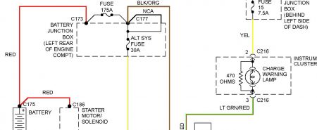

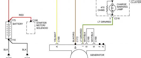

1999 Ford Ranger wont charge
120,000 MILES • 6 CYL • 2WD • AUTOMATIC
JIMMY_COTRAIN
replaced alt-the old 1 went out-now it wont charge at all-wondering if there is a fuse or fuse link i need to check/change-an if so where would the fuse be or the link-i dont have the owners manuel
Jun 27, 2010 at 10:05 AM
  • 75,988 POSTS
Inspect and test wiring for shorts/open also check all the fuses-see below
https://images.2carpros.com/forum/automotive_pictures/12900_a1_15.jpg
https://images.2carpros.com/forum/automotive_pictures/12900_a2_14.jpg
