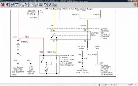

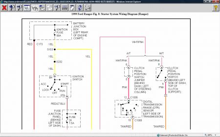

1999 Ford Ranger 6 cyl Four Wheel Drive Manual
Starter would not activate. When it did it turned slowly. Battery was fully charged, replaced starter with professionally rebuilt. Starter worked fine for several starts. Then it blew the 50 amp fuse in the distribution box. I checked wires from modular plug on firewall to distribution box and down to starter. All seem OK. What now? (Actually I replaced the wire.I stupidly used a jumper wire to replace the fuse. You guessed it, I melted the insulation from fuse to relay to the starter solenoid)

My guess is the new starter has a short. Have it bench tested.

Thanks for the quick reply. The 50 amp fuse is in the relay circuit, so short would have to be in solenoid/relay/ignition switch. It did test OK before installation. I've had some rebuilt items that were less than satisfactory in the past. Thanks again.

What does the relay connect to.
Saturday, August 16th, 2008 AT 8:24 PM
DJSTAUD
One side of ralay in the distribution box goes to fuse, the other side goes to modular plug on firewall (then to switch, I think). One side of the relay has wire to solenoid/relay on starter. I think its the same side that goes to the fuse. Will have to check that out later.

OK seems like youve tested a few. So try these, DTR and CPP jumper. Cables, it's all here, exactly where your problem is I hope you can locate with this info. Let me know!
