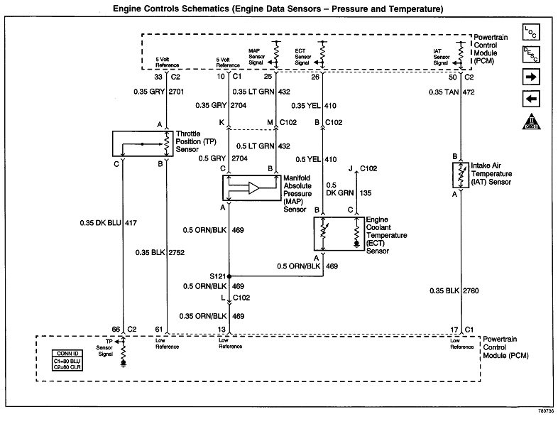

Voltage keeps raising on signal wire of TPS sensor
2002 BUICK CENTURY
150,000 MILES • 3.1L • V6 • 2WD • AUTOMATIC
FIXTHISONE
  • 34 POSTS

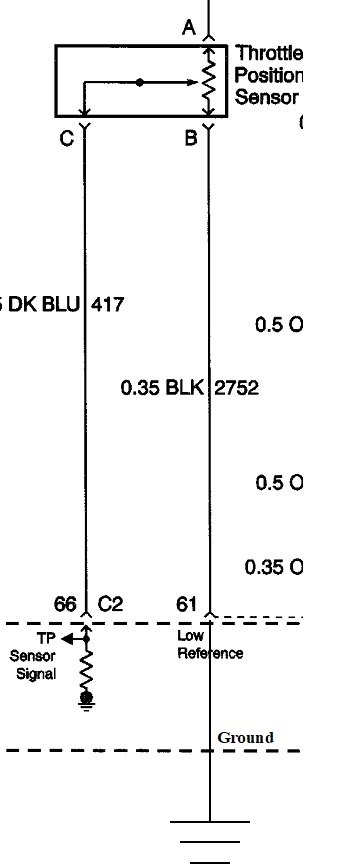

Parameters:
Engine cold
KOEO condition
TPS connector is unplugged.
Voltage measurements are being taken at the connector end and reader is plugged at OBD port under dash.
Reference wire voltage 5V
Ground 0V
Signal wire. Voltage starts around 0.8 V and slowing keeps going up.
No movement of throttle.
DTC reader keeps reading increased % of throttle.
turn ignition off Voltage reading goes to 0 volts.
Could this be a short to voltage? or is the PCM defective.
At least I can now duplicate the conditions in a constant manner.
Key on and the voltage starts to go up, key off voltage drops to zero.
Any suggestions as to what is causing this condition, that causes the voltage to increase slowly. After a few minutes the reader was showing around 43% throttle open when the throttle wasn't open at all ( should show 0%).
Thank you

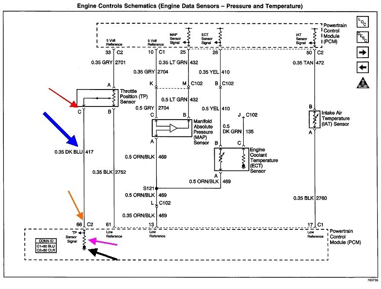

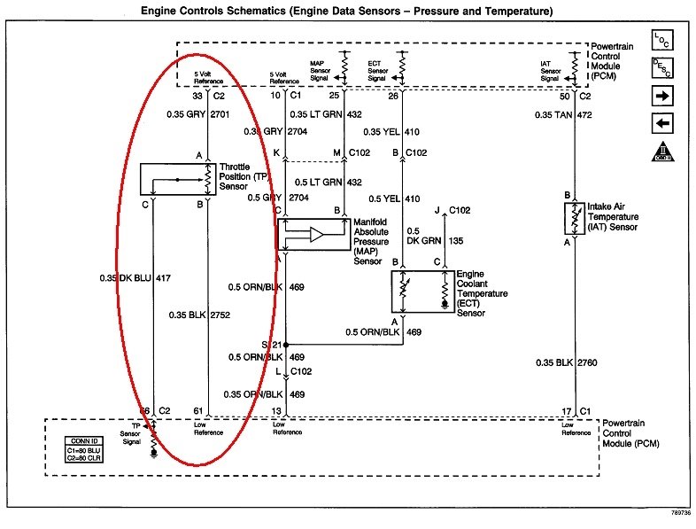

The voltage readings are meaningless if you have the TPS unplugged. That would be like saying you have good water pressure in your shower because it reads normal with the valve turned off and no water flowing. You have to measure water pressure when the faucet is turned on. If the pipe is 99 percent blocked with rust, you will still read full pressure until you turn the faucet on, then it will drop to almost nothing.
Voltage is electrical pressure, and it works the same way as water pressure in a pipe. Once the TPS is plugged in, you'll still find the 5.0-volt supply on one wire, expect to find 0.2 volts on the ground wire, then the center wire / movable contact inside the TPS will read roughly 0.5 volt at idle to roughly 4.5 volts at wide-open-throttle.
What is unusual is you're finding the signal wire's voltage goes up so slowly. It should jump to 5.0 volts instantly as soon as the sensor is unplugged. At first, logic would dictate you'd find 0.0 volts when it's unplugged, but in fact, because of all the interconnected circuitry inside the Engine Computer, the actual voltage is going to "float" to some random value. If that value were to fall within the acceptable range of 0.5 to 4.5 volts, the computer will accept it as normal, and try to run the engine on that. To prevent that, all manufacturers use either a "pull-up" resistor or a "pull-down" resistor on all sensor circuits to force the signal voltage to go to a defective state so it will get detected as defective by the computer, and it will set the appropriate fault code to direct you to the circuit that needs further diagnosis.
Those resistors are so huge electrically that under normal operation, they have no effect, and it's like they aren't even there. When the sensor is unplugged, a pull-up resistor is connected between the signal wire and the 5.0-volt supply, so it puts 5.0 volts on the signal wire. The TPS has mechanical stops inside it that limit its travel to 0.5 to 4.5 volts. (Those voltages are for training and explanation purposes. In actual practice, you might find 0.62 to 4.23 volts, or something similar. The actual values aren't important. What is important is the signal voltage on most sensors can't reach 0.0 or 5.0 volts. They can only reach those voltages when there's a defect in the circuit).
Similarly, when they use a pull-down resistor, those are connected between the signal wire and ground. When that sensor is unplugged, you'll find 0.0 volts on the signal wire.
You didn't list the symptoms or problems you're trying to solve. We commonly check the voltages you already have taken, but then we get confused and stop there when things don't make sense. That is usually when the one last defect is finally discovered. That is a break in the signal wire. That can include a broken wire, but more commonly a corroded pair of mating terminals in the connector for the TPS, and less-commonly, a break inside the sensor itself. The secret to finding this is to measure the voltage on the signal wire right at the sensor's connector, then compare that to what the computer is seeing. That will be shown on the scanner.
Again, these readings have to be taken with the sensor plugged in, and you're back-probing through the rubber seals around the wires where they go into that connector. You must find a nice steady sweep from 0.5 to 4.5 volts as you run the throttle from idle to wide-open-throttle. Whatever voltage you read there must agree with what is shown on the scanner. Let me know what you come up with.
What you have described up to now is rarely caused by a computer problem. While their plugs are usually very well-sealed to prevent moisture from getting in, it might still be possible to find some corrosion between two or more adjacent terminals.

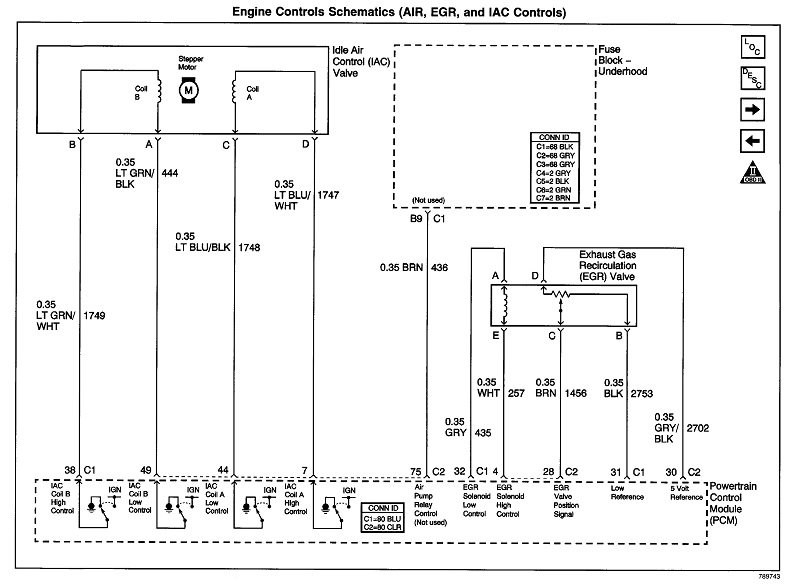

IAC. I suspected this may be the cause of the high idle and the tip had quite a bit of carbon.

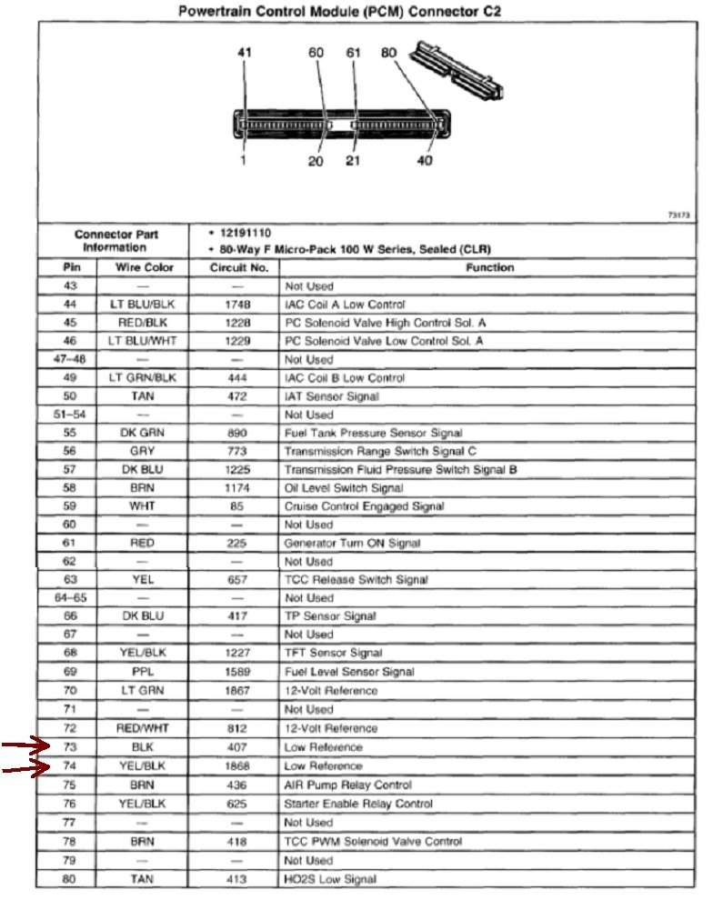

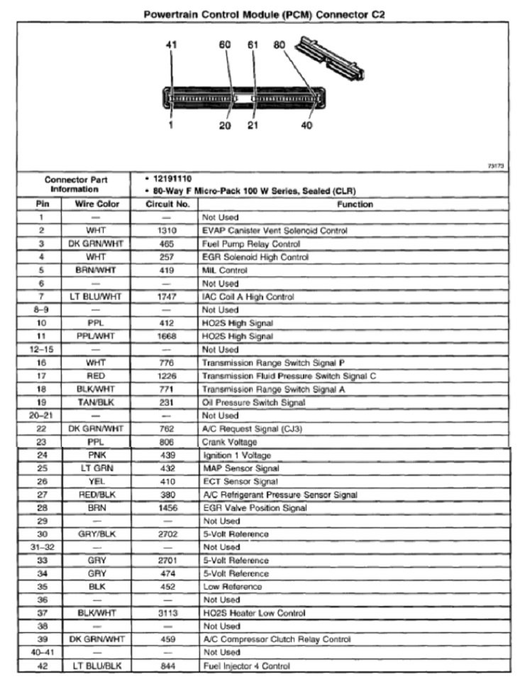

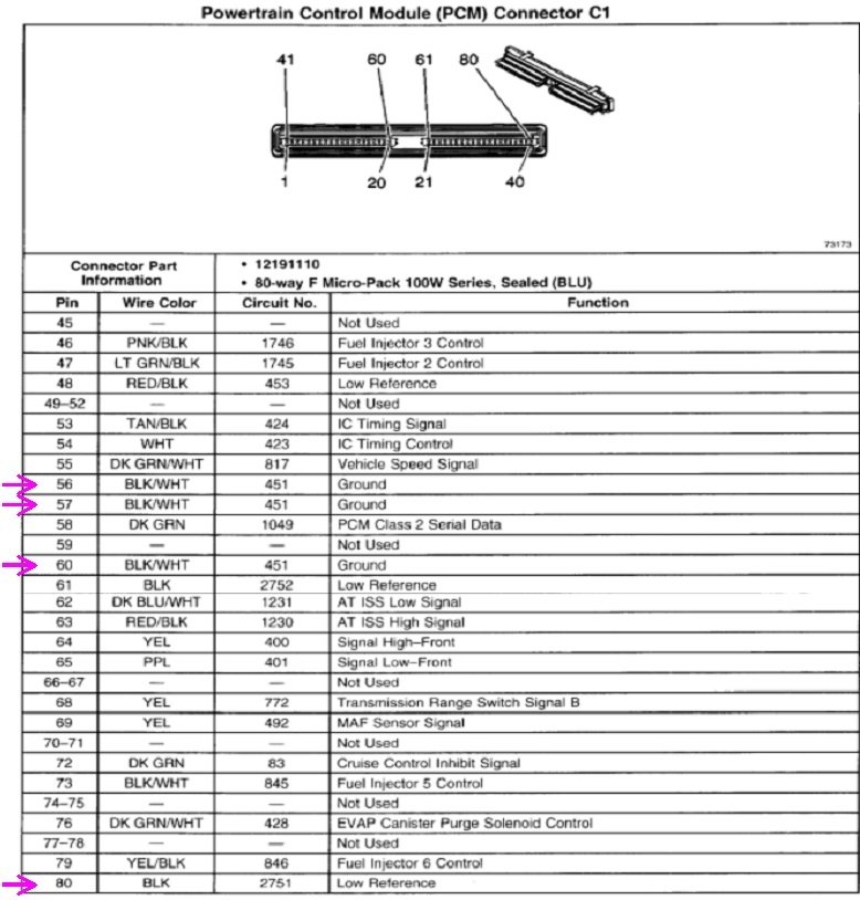

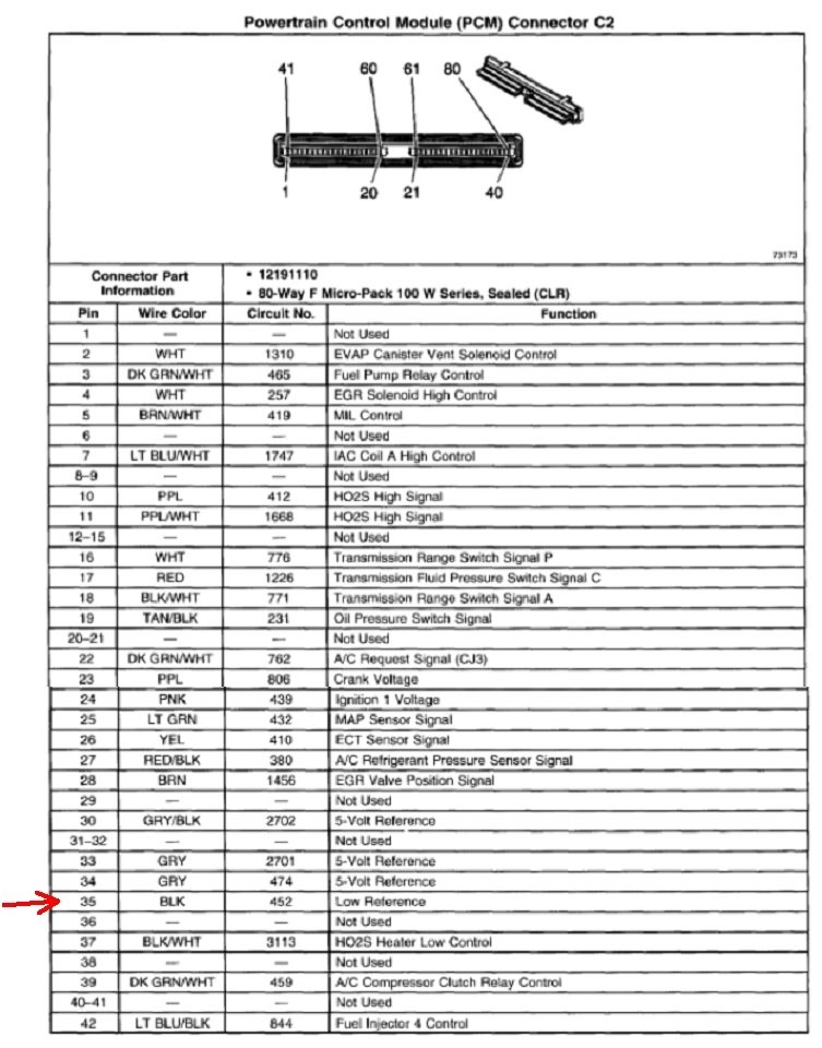

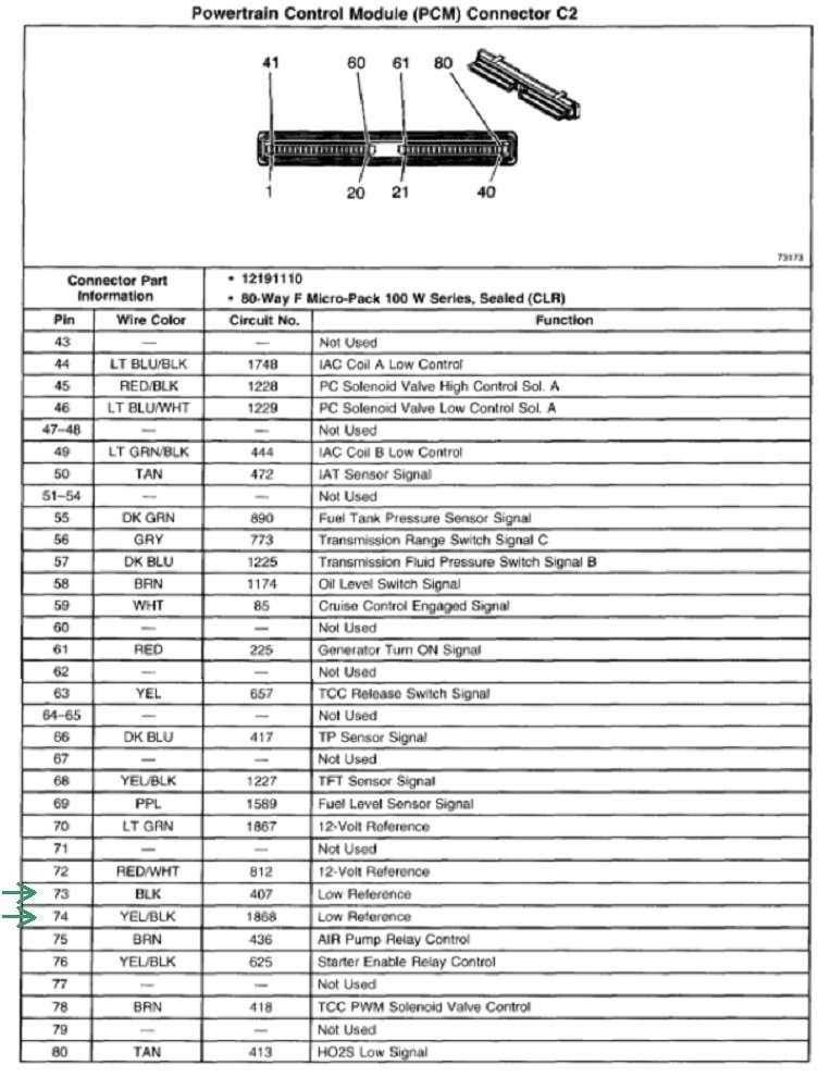

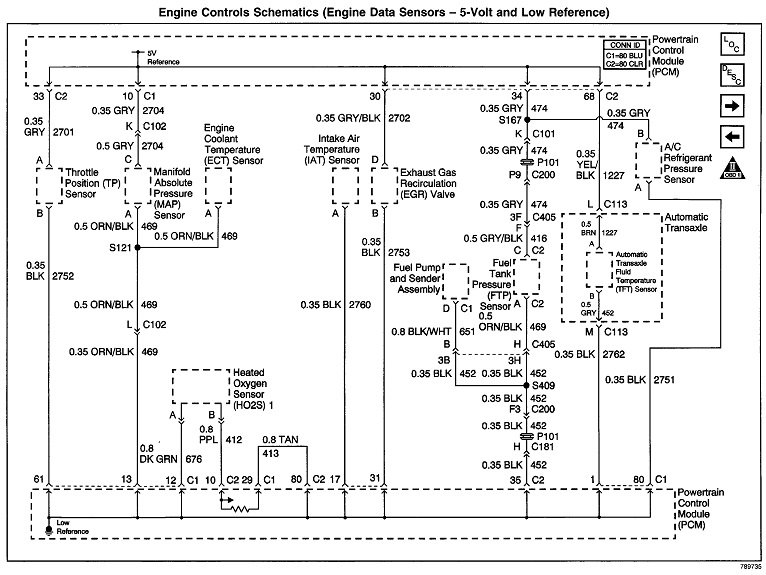

I have gone all the way to the PCM inside the air filter enclosure. I noticed that someone has done some inspecting in there. on of the connector shield was broken. It appears that the person didn't know or care how to remove it. Some tabs were broken on the shield. This is the upper connector ( C and D, I believe).
I traced the Dark blue and the grey wire to 66 and 33 on terminal B.
I checked for continuity for both, it tested okay.

Your idle speed motor, (idle air control) is the same part used on Chrysler engines, so operation is the same too. There are 256 "steps" the computer can set that valve to. It does that by pulsing its four coils with varying voltages and polarities. Step 32 is typical for a properly-running engine. That system has so much control over engine speed, it can maintain correct idle speed on a V-8 Jeep engine with six of its injectors unplugged. Obviously it won't run well, but that shows how much it can do. With a single-cylinder misfire on a V-8 or V-6 engine, you can expect to see the IAC at around step 50. As the step number increases, the pintle valve in the IAC retracts more and more to open the air passage around the throttle blade. At the same time, the computer increases the injector pulse width to hold them open for more milliseconds. Those two together are how it controls idle speed. Once you press the accelerator pedal a little, the IAC is out of the system and the computer leaves engine speed up to you.
I should mention too that IAC system is totally dead on Chrysler engines right after the battery has been disconnected, and idle speed will be too low, or the engine may not even start unless the accelerator pedal is held down 1/4". The vehicle has to be driven to relearn "minimum throttle" before the computer will know when it is supposed to be in control of idle speed. To meet the conditions for that relearn to take place, drive at highway speed with the engine warmed up, then coast for at least seven seconds without touching the pedals. I'm only bringing that up to point out this seems to not affect most other car brands, but it might play a role in my next comments of value.
If you read the AIS or IAC step number on a scanner, and you see, "0", it means minimum throttle hasn't been relearned yet. If you see it is somewhere around 25 to 35, the system is working normally and idle speed should be correct. These step numbers become valuable when diagnosing an idle speed problem such as what you described. Now that we know "32" is typical, if you were to see it much lower, but actual engine idle speed is too high, the computer is trying to lower it but not having success. This almost always results from a vacuum leak. If actual speed is too low, or it is close to correct, but the step number is higher than normal, the computer is raising engine speed to overcome something that is bringing it down. A spark-related misfire is a common cause. If you find idle speed is too high and the step number is also too high, the IAC system is working correctly, but the computer is raising idle speed for some other reason. This is where the intake air temperature sensor plays a role. When you unplug it, the computer has to try to figure out the actual temperature of the incoming air. If it errs on the warm side, that air is less dense so the computer calculates less fuel to go with it. There's a chance of a stumble or hesitation. To prevent that, they are programmed to err on the cold side so it increases the amount of fuel. The only symptom would be black smoke from the exhaust, but engine performance would be close to normal. With the increased fuel, idle speed would likely increase a little, as you observed. The default value in this case will be minus 40 degrees, and that is what you'll see on the scanner.
The last condition is when idle speed is much too low and the step number is real high, even though the engine runs well. The common cause used to be that carbon you found in the air passage the IAC sits in. Regardless how much the computer opens the valve, no extra air can get in around the throttle blade, so idle speed is limited by the size of the tiny hole in the throttle blade. This was real common on the 3.0L Mitsubishi engine Chrysler used in the late '80s and early '90s, but that hasn't been seen for a real long time since fuel detergents and additives have improved. No other engines seemed to develop that problem, even though they all used the same AIS motor and system.
Getting back to the TPS for a minute, I'm accustomed to reading their signal voltages with close to 4.5 volts being wide-open-throttle. As you've been reading it, that would equate to 90 percent. I'm not familiar with how the actual percentage is read. Is 100 percent equivalent to 5.0 volts, which is a defective condition, or is 100 percent equivalent to 4.5 volts, which is an acceptable condition? This is a point for discussion, but not relevant this problem.

.66 volts on the TPS signal wire at idle is perfect. I don't know why the reader is showing the percent going higher. Open the throttle to wide-open-throttle while you watch the voltmeter. It should rise smoothly to around 4.5 volts. Do that slowly and watch for any dropouts where it pops to 5.0 volts momentarily, but those are very hard to catch with a voltmeter. The Engine Computer is fast enough to catch them if they occur due to a bad spot on the carbon strip inside the sensor.
The next thing to consider with the scanner is most have some type of record feature that lets you catch a few-second snapshot of sensor data. You press the "record" button when the problem occurs or when something significant changes. Because that data passes through the scanner's memory, the recording actually starts a few seconds before you pressed the button. Later, you can scroll through that data slowly to see what changed when the symptoms changed. Then you have to determine if what changed is a cause or effect, meaning did a signal from an input sensor such as the IAT change a lot, or did it affect the output, such as changing rpm, a sudden change in the oxygen sensor readings, or things like that.
As for the lack of fault codes, I assumed a lot were set by unplugging various sensors while the ignition switch was on. If it was not on, no fault would be detected, or if the battery was disconnected or the Engine Computer was unplugged, that will remove the 12-volt memory power supply and the codes will be erased. That's the poor man's way of erasing fault codes, but there's many Air Bag and ABS Computers that codes can't be erased that way. Only a scanner that can access those computers can erase those codes.

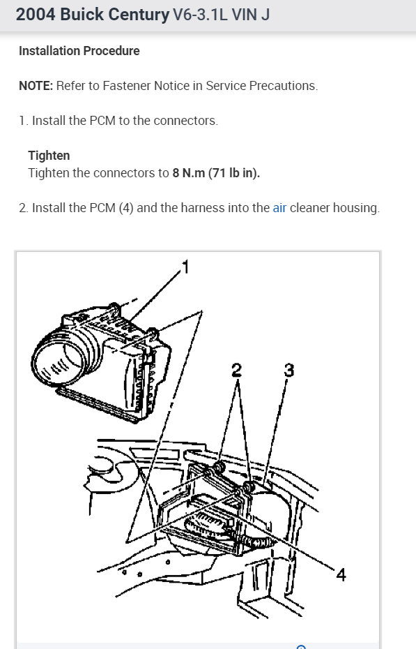

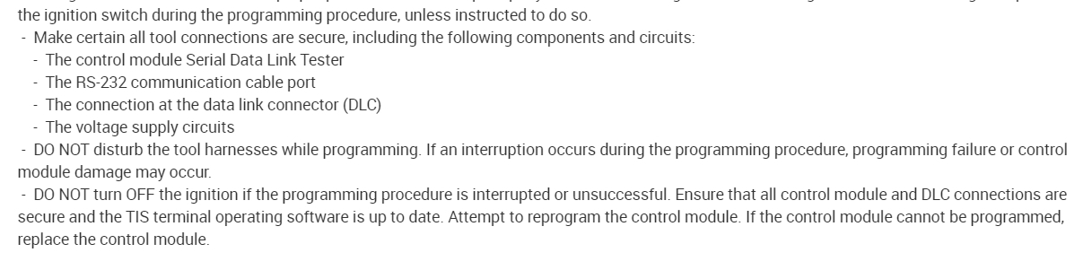

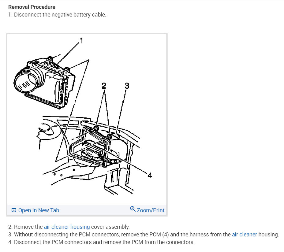

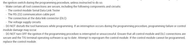

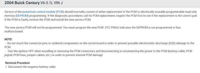

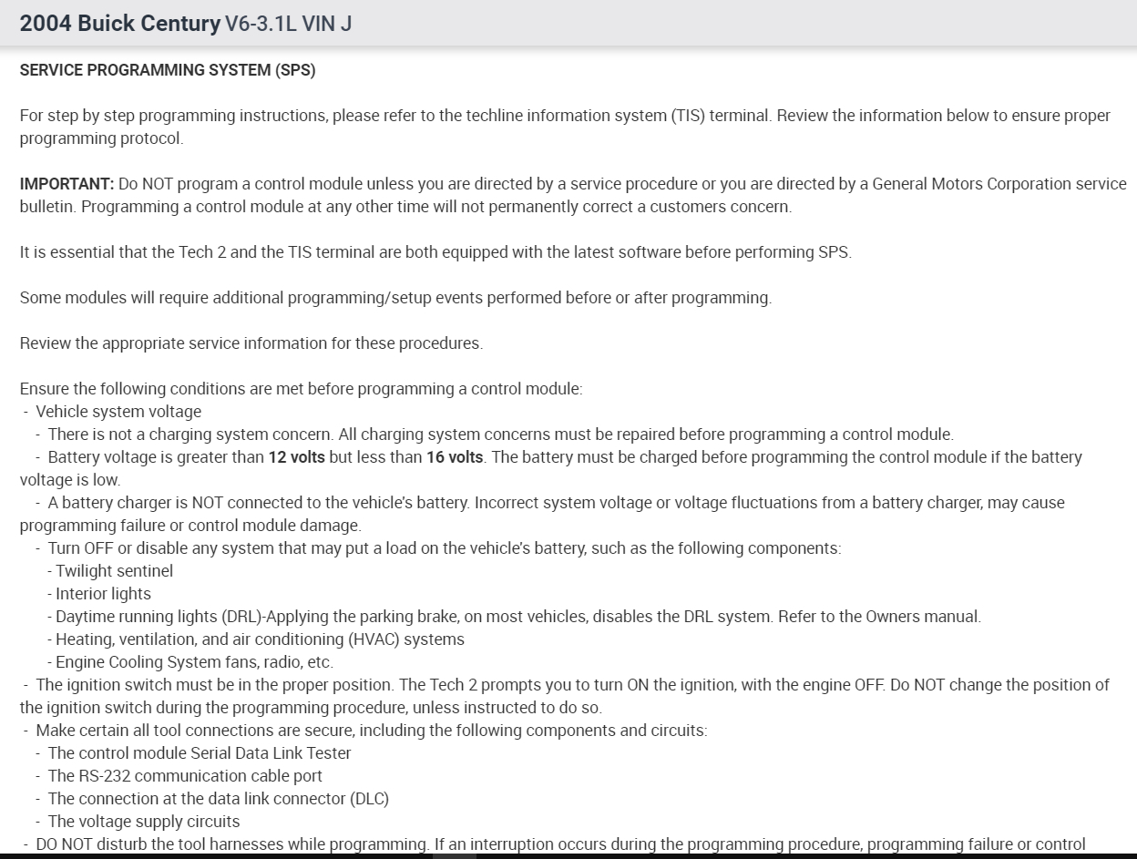

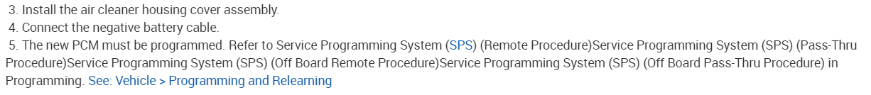

CARADIODOC is one of our best! It does sound like the PCM is out to me. this video can help scan the CAN which can help confirm the issue:
https://youtu.be/InIlnsjOVFA
Check out the diagrams on how to replace the PCM (below) if you get a rebuilt unit give your VIN and they can program is for you before installation. Please let us know what happens.
Oct 3, 2020 at 5:38 AM

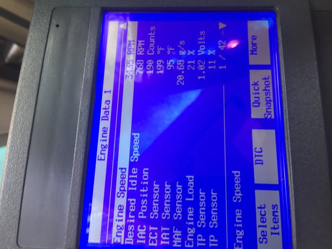

I just got the scanner.
I’m totally lost, confused, and baffled, but in complete control?
It is now time to figure out this puzzle.
It seems like a Bosch unit. There appears to be indications that labels were removed from some items. Have no idea whether is a good or bad sign. There is one part that actually has a GM p/n on it.
With any “ evidence”, it looks like someone bought a “surplus” lot of these machines and is trying to hide their true identity.
I could care less what is the real reason for the attempted disguise. I only hope that it works and that the CD’s work with my computer and I can diagnose the problem and fix my car.
From what I saw it looks like it could be a very nice unit.
At this point, I just have to go out there and give it a try.
Thanks for the information and let’s see what will be the outcome.

I was able to hook it up to the car and the RPM is at around 2200 and the counts on the IAC are around 85 at idle, so the problem is not constant rather than intermittent. The RPM oscillates quite a bit, all by itself.
I wanted to see if there is a way, through the Tech 2, to "close the IAC and see if that causes the RPM to go down.
Is there a CD for TIS 2000 that can be gotten so I can install Tech 2 in windows 10?

Step 85 for idle speed steps is way too high. That tells us the computer is requesting the higher idle speed in response to something. This is where you'd want to look through the sensor data to see what looks wrong. In particular, look at the temperature sensors.
Also look at the TPS voltage. I had a weird one on my Caravan earlier this year where the TPS "latched" at mid-throttle even when the accelerator pedal was released. When I pushed the pedal further, the TPS latched at the higher voltage. That caused slightly high idle speed, At three quarter throttle, the TPS latched there too when the pedal was released, resulting in a failure to start due to the computer seeing that as "clear flood" mode, so it turned off the injectors. Once I pressed the pedal all the way to the floor and released it, the TPS followed it back down to idle like normal. I suspect that was also the cause of an intermittent failure to up-shift the previous owner had it in for three times. I drove the van three years before this acted up often enough that I had time to get the scanner connected and see what was going on.
The TPS worked perfectly fine once it was unbolted from the throttle body. I couldn't make it act up by hand, but a good used sensor solved the high idle, and it has never failed to up-shift properly since then. Without the scanner, there would have been no way to figure out where to start looking. I just found this by scrolling through the sensor data, and found the TPS to be at more than 2.5 volts when it should have been close to 0.5 volts. What clinched it was seeing the voltage latch at those higher voltages. Had I cared to double-check that with a voltmeter right at the sensor, I would have found the same thing.
Another point of interest for your idle speed motor is the Engine Computer doesn't know how far it is open. The computer merely pulses it with varying voltages and polarities, then it assumes the motor has responded accordingly. If you remove the motor from the throttle body, you can watch it as it opens and closes the pintle valve. Chrysler computers usually extend the valve when the engine is stopped, then it is pulsed open to around step 50 in preparation for the next engine start. That gives you the nice "idle flare-up" to 1500 rpm for a couple of seconds, then it comes right back down to step 32 and normal idle speed. That flare-up tells you the idle speed motor is working. In case the motor got out of sync with the computer during the last drive cycle, running it fully-closed insures the computer knows where it is, then it opens it the calculated amount. It verifies the idle speed motor responded properly by observing idle speed is as expected.
On many GM engines, you can hear the idle speed motor run closed, then open a specific amount when you turn the ignition switch on. You should be able to read the step number before the engine is started. Almost right away that step number should count down to bring idle speed down after the initial idle flare-up.
You will likely also find a test function on your scanner for the idle speed motor. Mine lets me run engine speed up to 2,000 rpm, in 200 rpm increments. I don't know if the computer just keeps pulsing the idle speed motor more and more until the selected engine speed is reached, or if it is only concerned with adjusting the idle speed motor to a predetermined step number, then hoping the engine is at the desired speed. I have a suspicion the first one is correct because when I select a test speed, say 1600 rpm, the step number increases quickly at first, and engine speed responds quickly, then the step number continues to count up one step number at a time for a couple of seconds. The actual engine speed settles exactly on 1600 rpm Regardless, that proves the idle speed motor is working. If engine speed doesn't increase, the air passage is blocked with carbon, or the motor is stuck, which is fairly rare.

I heard that a picture is worth 1,000 words, so I’m sending this one to show what I’m getting at idle.
I hope it may provide some additional information to help narrow down the defective component.

The ECT, MAP, IAT, and TPS all share a common 5.0-vot supply from the Engine Computer, however, part of the ECT's circuit is inside the computer, so there is no 5.0-volt wire at that sensor. All of these sensors also share a common ground wire, but it goes through the computer first so it can be monitored, then it goes to ground. You'll typically find 0.2 volts on that ground wire. This is the only circuit that can be connected with that added-on wire you found. Your scanner is showing 195 degrees for the ECT, so that sensor is working correctly and has to be wired correctly.
As for "key-on / engine-on or off, the scanner will tell you when it is unhappy. To do the engine speed function, the engine has to be running. I'm not aware of any test that lets you run the idle speed motor with the engine off. Most scanners require the engine to be not running to erase diagnostic fault codes, but I was just helping my friend at his body shop, and on a 2019 Chevy Equinox, the codes could only be erased with the engine running. That was a first for us, and we were surprised to find that.
My scanners will read road speed and the state of each cruise control switch any time, but it will not allow the servo's solenoids to be activated unless the engine is not running. That avoids activating the "vacuum" solenoid while you're driving. To do so could mean they find you in the next county going 120 mph!
Sensor data, switch state, (on or off), and output condition, meaning is a relay or solenoid being turned on, can all be viewed regardless if the engine is running or not. In addition, some scanners for some car models will generate a screen list of data specifically related to a crank / no-start condition. To avoid confusion, my DRB3 lists switches as "pressed" or "released" rather than "on" or "off". A brake light switch and a door switch are off when they're pressed. A horn switch is on when it's pressed.
For the engine speed test, mine doesn't allow me to select a speed lower than normal idle speed. As I recall, it starts out with the first choice being 1,000 rpm, then I can only select an up or down arrow to go to 1,200, 1,400, 1,600, 1,800, and 2,000. From there I have to use the down arrow or select, "stop" to exit the test and bring it back down to normal idle speed. Any defect, a vacuum leak, for example, that results in a high idle speed will over-ride what the computer is trying to do during the engine speed test. If the scanner is telling the computer to run the engine at 1,400 rpm, for example, it can't do that if something else is already making engine speed 1,500.
The Engine Computer looks at a lot of sensor data and operating conditions to calculate the desired idle speed and ignition timing. It is very unlikely to calculate the wrong speed. There are four driver circuits inside the computer that operate the idle speed motor. Together they cause a slowly-rotating magnetic field inside that motor that the armature follows. As the armature rotates, it is on a threaded shaft that retracts or extends the pintle valve. If any one of those driver circuits were to develop a shorted driver transistor, or some other defect, that magnetic field inside the idle speed motor would no longer rotate. Some of the coils would pulse, but at most, the armature would just twitch back and forth. Engine speed would not adjust by the computer. If you were to remove the idle speed motor and forcibly push the valve in, then install it that way, idle speed would be way too high, the computer would try to bring it down, but actual engine speed wouldn't change. A quick way to see if the computer is working is to do anything that lowers engine speed, then see if the computer can bring it back up. I saw a horrendous example of this at a Chrysler training class some years ago. With a V-8 Jeep engine, the instructor unplugged one fuel injector. Almost immediately, the idle steps went from 32 to 50, and idle speed stayed right were it was supposed to be. By the end of the demonstration, he had six of the eight injectors unplugged, and idle speed was still correct. Obviously the engine was running very poorly, but his comment was, "this shows how much control the computer has over engine speed".
If you had a problem with the computer or the idle speed motor and circuit, engine speed would drop if an injector was unplugged or you had a spark-related misfire. You can also introduce an artificial vacuum leak that causes idle speed to be too high, then watch the steps, or "counts" to see if they come down. If you see the counts at around five to ten, the computer is trying to lower engine speed, but without success. "Without success" means whatever is causing the high idle speed is beyond the computer's control. It does have control of the desired (variable) vacuum leak which is the air passage the idle speed motor sits in, but it doesn't have control of a vacuum hose you pulled off, of some other vacuum leak.
Another way to verify the idle speed system is working is to remove the idle speed motor but keep it plugged in, then watch the valve when you turn the ignition switch on and off. At some point the valve will extend fully, then retract a small amount. That could occur when you turn the ignition switch on, but I see it more when the switch is turned off. By fully extending the valve more counts than necessary, the computer is sure it is extended as far as possible, so it is confident it knows where it is. It is "in sync" now in case it moved out-of-sync a few counts during the last drive cycle. Now the computer retracts the valve a predetermined amount to provide that idle flare-up to 1,500 rpm at the next engine start-up.
Your scanner can't bypass the Engine Computer. When working with the Engine Computer, there are basically only four wires in use in the scanner's cable. Those are the ground, the 12-volt feed, and two "data buss" wires. The Engine Computer, Transmission Computer, instrument cluster, Body Computer, Anti-Lock Brake Computer, and Air Bag Computer all need to know road speed, but there are not speed sensors for each one of them. Multiple computers need to know coolant temperature because they modify how they send commands based on engine temperature, but there's only one coolant temperature sensor, not one for each computer. Instead, each computer takes a turn at sending its data out onto the data buss to every other computer. It's up to those other computers whether they want to look at the data they're receiving. For a fraction of a second, the Engine Computer will transmit engine speed, temperature, load, intake air temperature, whether or not the charcoal canister's purge valve is activated, and the AC compressor relay is turned on.
At this time, the Transmission Computer looks at that data, and modifies its shift schedules according to coolant temperature, engine speed, engine load, and throttle position. It sees but ignores things like the charcoal canister's purge valve. Eventually the Transmission Computer gets a turn at transmitting data onto the data buss. Among other things, it transmits road speed. Now the Body Computer can see that and turn on speed-sensitive door locks. The radio is also connected to the data buss. It can raise the volume above a certain speed to overcome road noise.
The scanner is just one more computer connected to the data buss. (By the way, a '99 Cadillac could have up to 47 computer modules on the data buss). That means anything the scanner displays had to come through those two wires, and anything you ask the computer to do also goes through those two wires. Nothing can be activated by you without the commands going through one of the computers. You're telling the scanner to talk to the computer, then the computer responds by doing what you asked it to do.
When you run into a data buss, you can identify them by observing the pair of wires are twisted around each other. We used to do the same thing with the older flat "twin lead" for tv antennas. Any stray magnetic field will induce a voltage into a wire it crosses. By twisting the pair of wires, those voltages are induced equally in both wires, so the difference is "0", and they cancel each other out. This becomes a bigger problem because the signal voltages on the data buss wires is so small. They start out with 6.0 volts on each one, then, when a digital pulse comes along, those voltages rise by 0.2 volts on one wire, and fall by 0.2 volts on the other one. In a harness with lots of wires, there's pulses from firing the ignition coils and injectors, along with other switched circuits. Being fairly high-current circuits, they generate large magnetic fields which induce large voltage spikes into adjacent wires. That doesn't bother lighting or most other circuits, but it can seriously affect sensor signal circuits and those on the data buss.
In later years there are multiple data busses on most cars. Some are high-speed circuits that are needed to process signals immediately. One of those is for the Engine Computer so it can modify fuel metering and ignition timing calculations quickly for best performance and lowest emissions. The Air Bag also uses a high-speed data buss so it can pop the air bag at the exact instant it needs to. A low-speed data buss is used for less critical systems such as for lights, horn, and gauges. It doesn't matter if those take a few extra milliseconds to do their thing.
I have to say this next comment carefully, but at least with Chrysler products, there is nothing you can do, short of outright sabotage, to damage an Engine Computer. If you ground the 5.0-volt sensor supply to short it to ground, the computer will turn it off to protect it. Once that short is removed, you simply turn the ignition switch off, then back on to reset the supply. If sensor signal wires are grounded or shorted to 5.0 volt or even 12 volts, the computer will detect that and set the appropriate fault codes. Those incorrect voltages don't do any damage. Anything with a coil of wire will generate a reverse voltage spike of up to 300 volts when current through it is turned off. Relays have damping diodes built in to short out those spikes, and the computer has damping diodes for the switching circuits for the injectors, ignition coils, and solenoids it operates. If you look at the wiring diagrams, you'll see a lot of switching done by the computer is done on the ground side of relays and solenoids. That makes any voltage spikes appear on the 12-volt side where they are easily damped and absorbed by the battery.
GM and Chrysler do things very much the same way, but during the '80s and '90s, Engine Computer failures on Chrysler products were extremely rare. GM, on the other hand had a real lot of failures in the early '90s, but those were not caused by external defects in the cars. If a replacement computer was needed, and that replacement also had a problem, chances are that replacement was a used one from a salvage yard. By '98, GM didn't have any more computer trouble than any other manufacturer.
GM and Chrysler use the same idle speed motor, but while Chrysler's range goes from "0" to "256", I don't know if GM uses the same scale. If they do, your screen is showing 190 steps, which is way too high. I don't think that 8-cylinder Jeep running on only two cylinders reached that high of a step. Remember, if something such as a vacuum leak was causing your idle speed to be too high, the counts would be real low, indicating the computer was closing the idle speed motor's valve to reduce air flow. It's not doing that. Yours is showing the computer is requesting that high idle speed. That has to be in response to a sensor value or something it is seeing. Of notable interest is "engine load" of 21 percent. I don't recall seeing that on my vehicles, but it seems too high for a vehicle idling in "park". I also question the TPS voltage. I'm used to seeing around 0.6 to maybe 0.7 volts at closed throttle. Remember my story of the TPS that latched in various positions? With the engine running, the only fairly constant symptom was idle speed just high enough to get my attention, . . . perhaps 1,000 rpm. That's when I noticed the TPS was at around 2.6 volts, or incorrectly telling the computer "half throttle".
From what I've read so far, I think your observation of the TPS voltage varying at closed throttle is the thing to pursue. A comment I post quite often is, "when a part is referenced in a fault code, it is actually the cause of that code only about half of the time. The other half are caused by wiring and connector terminal problems, or mechanical problems associated with that part". The same holds true when there's no fault code being set but the signal voltages are wrong. The TPS is strictly a mechanical sensor with no touchy electronics inside. As such, it is fairly immune from sending a wrong voltage compared to electronic sensors like the MAP and MAF. Even if a tiny chip of carbon were to break off from the resistor element and get caught under the movable contact, you still wouldn't see the TPS signal voltage change when the throttle was being held steady. What is much more likely to change on its own is wiring, particularly connector terminals. What is your understanding of electrical theory? If there is some corrosion between the pair of mating connector terminals for the ground circuit, the signal voltage would go high intermittently. Likewise, if there was some corrosion on the terminals for the 5.0-volt supply, the signal voltage would drop intermittently. Remember too both the 5.0-volt supply and the ground wires feed multiple sensors, so there's going to be splices, and those are dandy places to find corrosion and bad connections.
Were I think I would start is by monitoring the TPS signal voltage with the engine off, and the throttle propped open half way. That will make any tiny glitch caused by the ground circuit to be more easily noticeable. Use a separate digital voltmeter for this. Now wiggle the harnesses and plugs. The signal voltage should hold rock solid. I could see it bouncing around a couple hundredths of a volt due to stray magnetic fields or other circuits in the car turning on or off, but if you see it change even a tenth of a volt, I'd look at what I was doing that caused that to happen. Watch the readings on the scanner at the same time. If those readings change while those on the voltmeter don't, suspect a problem in the signal wire.
Also look at all the other sensor voltages to see if something doesn't look right. You're showing 95 degrees for intake air temperature. Is it really that hot, or could that be from engine heat migrating up to the IAT while the engine isn't running?

The other sensors should not be bouncing around in step with the oxygen sensor. When you see the TPS reading rising on its own, do you see that with a voltmeter too right at the sensor's signal wire? Engine speed shouldn't increase just because the TPS reading goes up, at least not a noticeable amount. Idle speed is mainly a result of temperature sensor readings and anything else that would affect engine speed. Specifically, if the computer is told to turn on the AC compressor relay, it knows that will load down the engine, so it bumps up idle speed. Same for the load put on the generator when the rear window defogger is turned on.
Given all these different observations involving multiple sensors, it sounds like their ground circuit is a good suspect. Remember, if the ground for the TPS is totally broken, you'll find 5.0 volts on the signal wire. It's when that ground circuit simply has undesirable high resistance that you'll find more voltage on the signal wire than normal. Remember too that many sensors share a common ground wire, so resistance in that wire will affect all of them. There's going to be splices where each sensor's ground wires are tied together, there will be pairs of mating terminals in the connector that connects the engine harness to the body harness, and at least one more in the computer's connector, and there will be at least one signal ground wire bolted to the body. All of those are excellent places to find corrosion and high resistance. To add to the misery, high resistance caused by corrosion usually changes with changes in temperature and humidity, so the symptoms will likely change as the engine warms up.
Chrysler uses four ground wires for their Engine Computers. One is for the high-current devices like ignition coils, injectors, solenoids and relays. Those devices also generate voltage spikes when they turn off. There is always some, hopefully small, resistance in a wire, and those voltage spikes are going to develop small spikes on that ground wire. If the sensors shared that ground wire, those spikes would show up in their signal wires too. They always use a "signal" ground wire for the sensors to keep them isolated from the voltage spikes from the "power" ground circuit. In addition, each of those has a duplicate ground wire for added reliability. That's why there's four separate ground wires.
What I would suggest, since the rising TPS voltage is the most obvious, is to go to its ground wire and monitor that voltage. Put the voltmeter on its lowest range so you get the most accuracy. Normal should be around 0.2 volts. If you see it changing, especially going up, we'll have to find the resistance in that circuit.

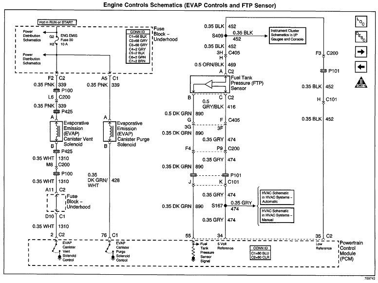

I put together these diagrams of the engine management system. These are the black and white ones from the manufacturer. I can't copy the aftermarket diagrams to save or post, without going through a lot of conversion work. I don't like them anyway because they don't offer as much information, and there's way too much stuff on each one. It gets too confusing, but they're okay if you don't have anything else.
I use AllData for all of my online diagrams. Most independent shops subscribe to it for around $1000.00 per year. You can buy a one-year subscription for just your car year and model for around $27.00, and I think for around $48.00 for five years. As an alternative, I'm happy to post any diagrams you need as long as I can find them and you give me time to convert them to a format that can be posted.
To decipher wires, Chrysler's look the most confusing at first, but they provide the most information. A typical designation could be "Z12 14BK/LB" "Z" is used for ground wires. "A" is for wires coming directly off the battery positive terminal, and "K" is for control wires, as in circuits that control relays and solenoids. "12" just differentiates this wire from the other ground wires. "14BK/LB" means this is a 14 gauge black wire with a light blue tracer, or stripe. All the other circuits have a first letter assigned to them per their function, but I never needed to memorize them.
GM gives you the same information, but it's broken into multiple parts. The eighth diagram has the throttle position sensor in it. The last diagram is the same one, but I added some nifty arrows. The blue arrow is pointing to the TPS signal wire you're working with. Here, the "0.35" is the wire size in millimeters. I don't have a good frame of reference for that. I just observe that it's smaller than other wires with larger numbers. The wire is dark blue, and it's circuit 417. That wire is unique. No other wire on this car is designated "417". There's nothing to tell you the function of the wire Knowing that might be helpful when trying to figure out how a system works, but as I mentioned, I don't pay much attention to that on Chrysler's diagrams.
I did note something interesting about this circuit. Did we previously have a discussion about pull-up and pull-down resistors? I describe this so often that I forget if I'm repeating myself. Tell me if you don't know what those are.
If you follow the dark blue TPS signal wire down to the computer, terminal # 66 in connector C2, you'll see the tiny black arrow pointing to the "TPS signal processing circuit inside the computer. It also goes to the resistor pointed out by the purple arrow. That resistor is tied to ground as shown by the ground symbol at the black arrow. That means this is a pull-down resistor, which is the opposite of what is used in most cars. Defects are detected the same way, but this does shed new light on the voltages you've been finding.
That pull-down resistor is so large electrically that it won't have any effect on the TPS readings except when the dark blue signal wire is broken, then it puts 0.0 volts on the terminal the computer is looking at. 0.0 volts is outside the acceptable signal voltage range of roughly 0.5 to 4.5 volts. Those are what set a fault code.
To back up a minute, you found the correct range of signal voltage at terminal "C" on the TPS, (red arrow), with the voltmeter, and the scanner says the computer is seeing it go up to 2.49 volts at the computer, (orange arrow). The only possible way to have two different voltages on a wire is if that wire has a break in it between those two points. The clinker is though, if that were true, the pull-down resistor, (purple arrow) would cause the computer to see 0.0 volts, and that is what you would see on the scanner. You would have a fault code for "TPS signal voltage too low".
One thing that has happened to me on many occasions when using a friend's meter to diagnose a tv problem is he has an auto-ranging meter and I failed to notice it has switched to a lower scale. If your meter has this feature, be careful to not be tricked by this. Stray magnetic interference can easily be picked up in the leads and show up as "0.249 volts." It will display as "249", then you have to notice the really tiny "mv" for millivolts, in the corner of the display. In a tv, if you need to have 42 volts, for example, we would call anything in millivolts, "0 volts" and not concern ourselves over what little voltage that is there.
With your throttle closed, and reading around 0.5 volts at the red arrow, if the scanner really is showing 2.49 volts, this certainly would point to a problem inside the computer, at least that's what logic would dictate. I'll believe it when I see it, as in your reply that a used computer solved the problem. First I would suggest taking the connector apart enough to allow you to poke the meter probe right into it alongside that wire and see what you have right there. If the voltage there agrees with what you have at the sensor, that would suggest the wire is okay.
Also keep in mind that pull-up resistors are much more common and it is not unheard of to find mistakes in manufacturer's service manuals. Many early-release manuals at dealerships have stuck-on page overlays printed with corrections on them. If the resistor is actually tied to 5.0 volts, and is therefore a pull-up resistor, the 2.49 volts you're seeing on the scanner would indeed point to a break in the signal wire.
Once you get to the signal wire terminal at the computer, consider touching a jumper wire from the meter's probe, to ground. If that causes no change in idle speed, it points to a defect inside the computer.
The next thing to consider is the ground wires for the computer. Chrysler uses four of them. Two are "signal" grounds and two are "power" grounds. Power grounds are for things that use high current, like injectors, ignition coils, relays and solenoids. There is always at least some small resistance in a wire and a connection. The pulses of current through these circuits will result is small pulses of voltage being dropped across that resistance. That has no effect on those circuits, but those tiny pulses in voltage would mean a lot to sensor signal voltages. For that reason, sensors use their own dedicated "signal" ground circuits that don't have those little voltage pulses. Only those two ground wires are needed, but each one has a second one for redundancy. Grounding problems are extremely rare on Chrysler products, but they seem to be more common on some GM computers. If you haven't made progress up to this point, we may need to look closer at those ground wires. There's more of them than I see on these diagrams. If it becomes necessary, I'll look for a listing that shows the connectors with their wire functions.

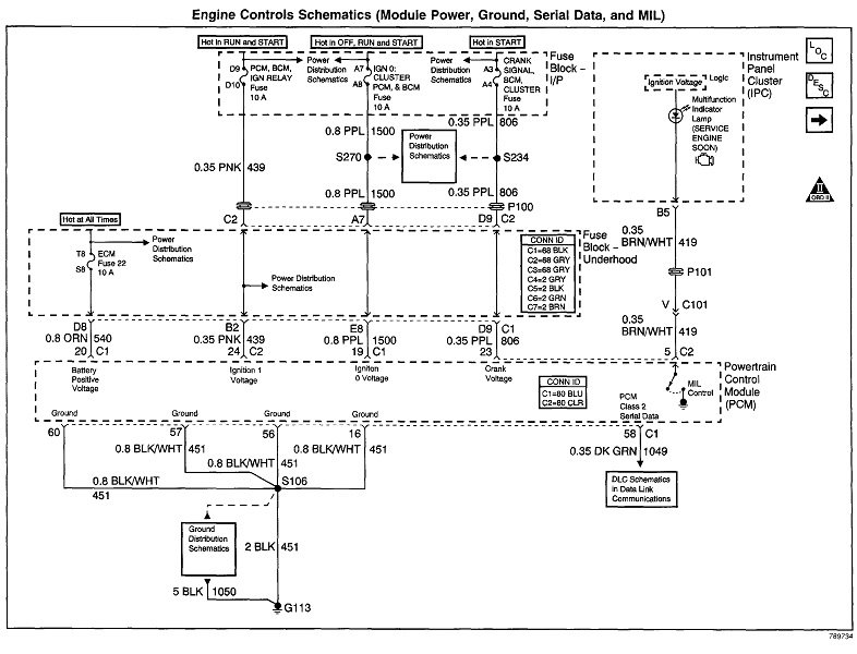

I have the AllData subscription for the vehicle that I'm working with and I have printed a very large amount of pages, probably around 200 pages.
I'm having a hard time locating/identifying the actual location for the connectors. I tried to see if I could find something like this but so far found none.
I have the car zoning diagram, it tell me the zone for the item. 100 - 199, 200-299 and so on.
Fully understand that concept. This is the general area, but it doesn't pinpoint the component location within the general area.
Specifically, regarding circuit 417 DK/BLU I get that this is the wire that send the signal to the PCM at C2 pin 66 ( As I understand there is a pull-down resistor at .pin 66)and 417 comes from position C at the sensor(TP) connector.
Circuit 2701 from C2 pin 33 at PCM is the 5 volt reference for the sensor (TP) going to position A on the sensor connector
Coming from position B at sensor (TP) circuit 2752 is the low reference for this sensor.
Individually I get all of this, but I'm basically clueless as to how the sensor interacts or is affect by the PCM or other sensor. Not having the knowledge of the interaction process prevents me from troubleshooting the circuits with a good degree of certainty.
I have read quite a bit on pull-up and pull-down circuits. There is a very nice site that I found, but can't remember where, that explains in great detail the process and the reason for it. I have printed those pages and use them.
I had mentioned before that no DTC was present, however I now have a P0121 code.
I'm glad that you supported my theory that in order to have different voltages there must be different circuits the same run of wire can't have different voltages without some type of electrical or mechanical interference with that wire.
I have found some really nice back probes on e-bay. They come with a screw on tip and the taper is, in my opinion, just right. It has the right length so that contact is made and at the same time there is enough taper to bind a little and it is strong enough to be pushed in without easily bending.
Could you clarify the part where you suggest that I ground the probe that is in the computer's terminal. Are you referring to position 66 on C2 ( signal wire) to be grounded? and if there is no change the computer is defective.
Where do I find the grounds for the PC? I tried to look for such diagram but found nothing so far.Are these grounds coming to the PCM through the 2 large connectors?
I see grounds at the following positions on the 2 connectors.
C1- Part 1- Pin 16
C1- Part 1- Pin 56
C1- Part 1- Pin 57
C1- Part 1- Pin 60
They are all on circuit 451 BLK/WHT
I see additional information on Fuse Block- Underhood C1 for the following Positions
Pin wire color circuit
B1 BLK 451
C1 BLK/WHT 451
C10 BLK 1050
I don't really know what to make of these circuits at this moment.
I lack an overall view of the entire system and how the individual parts interact. I get the individual parts but can't make sense of the whole system.
I will keep on checking and hope to find what this problem is.
Again, thank you for your assistance and patience.

I just finished checking voltages and this is what I got
Back probe TP sensor 0.76 Volts
C2 pin 66 DK BLU wire 0.74 Volts
Scanner on OBDII port 2.53 Volts (being displayed on Tech II screen)
It seems to indicate that the voltage reading on the wire is constant and therefore the wire seems to be ok.
I don't quite know what to make of it because I don't know what happens to the signal once it comes into the PCM.
It certainly doesn't reflect what is going on on the TPS.
Please let me know if you have any ideas as to why would the PCM is displaying 2.53 volts instead the TPS voltage.
BTW I keep finding more things that the Tech II can do. It may be a Chinese clone but it works great so far. I wish I had a more understanding how the systems interact and what values to expect it could be a excellent tool for my application.
Thank you

Here's something I put together last night related to your wiring diagrams:
To explain why there's so many grounds for your Engine Computer, they list the ground wires coming into the computer from a sensor as "low reference". The ground wires aren't shown on all of the diagrams, so I added one in the second diagram. As I mentioned previously, the sensors' ground wires go through the computer on their way to ground so circuitry inside the computer can monitor those circuits. That monitoring circuitry isn't shown because it isn't really relative to any discussion. What is noteworthy is due to that circuitry, a very small amount of voltage is dropped across it. As a result, you will measure very close to 0.2 volts on the "low reference" wires, but you should find 0.0 volts on the ground wires.
As a point of interest, when you measure water pressure in a pipe or air pressure in a compressed air line, those are always in relation to some common reference point, in this case, atmospheric pressure. That reference is implied. We just don't bother mentioning it. Voltage is electrical pressure, and for the most common types of measurements, it is also measured in relation to a common point. In tv, vcrs, and cars, we call that "ground". Other voltage measurements "refer" to those common grounds, and while the 12-volt or 5-volt power sources are the high side of the circuit, the ground side is the low side. That's how they came up with the term "low reference. Low reference is a ground circuit, but it differentiates the wires going from the computer to ground from those coming in from the sensors to the computer.
To save time and do this most efficiently, you only need to check the "low reference" circuits. If you find 0.2 volts on one of them for a sensor or group of sensors, that can only occur if its corresponding ground wire is okay. We're looking for any low reference wire that has too much voltage. If you find one with, lets say 0.7 volts, for example, that is when we have to look further to figure out the cause. I've never heard of there being too much resistance inside a computer, so logic dictates you're going to find some voltage on one of the ground wires, and that will be caused by a corroded wire or terminal bolted to the body sheet metal, or much less commonly, the terminal in the computer's plug. Anything over 0.0 volts is considered not acceptable, but remember there can be a little stray voltage picked up by the meter's leads due to electromagnetic interference. Don't panic if you find a few hundredths of a volt. Typically with a corroded terminal, the excessive voltage will be high enough to be obvious.

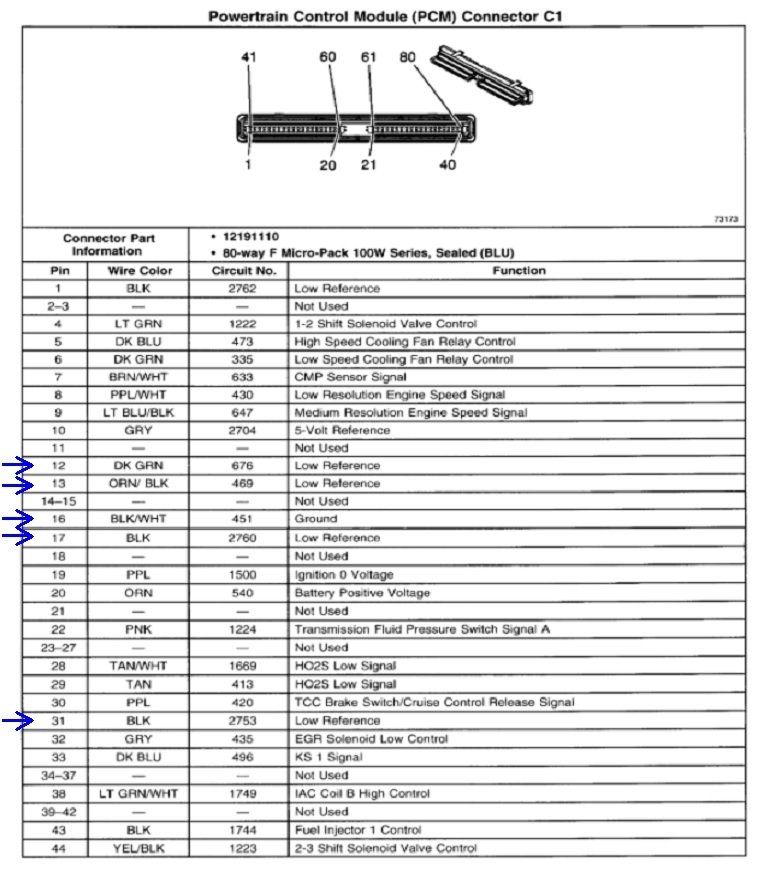

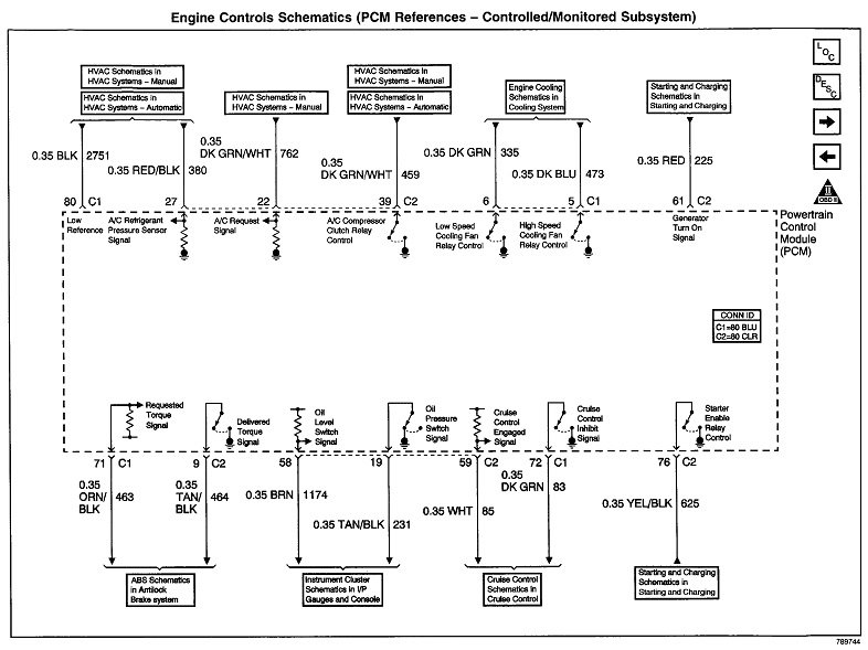

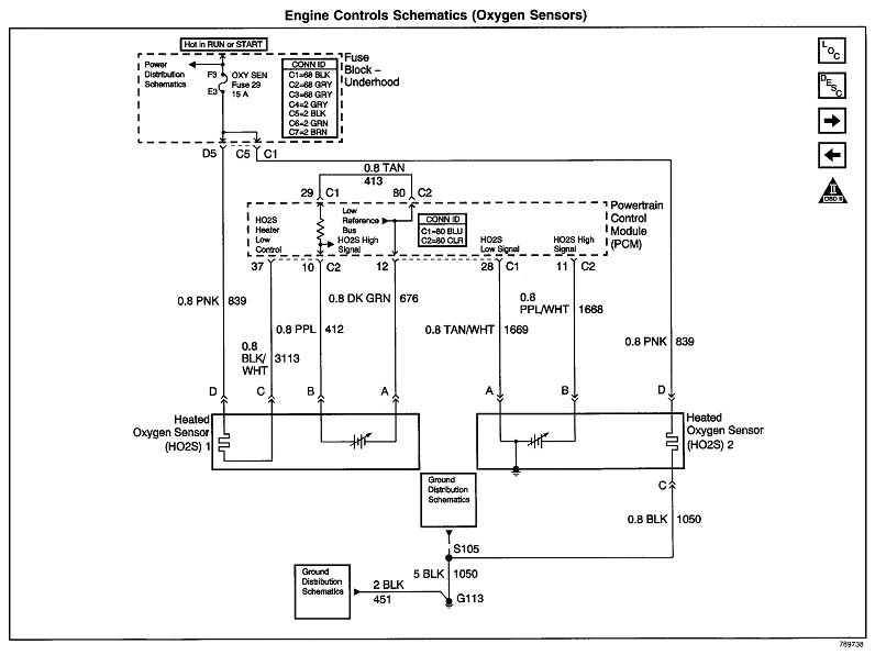

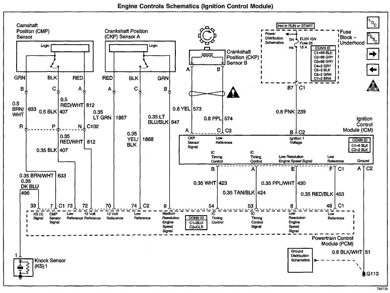

Finally, here's the connector views I promised. The first two are connector C1 and the last two are connector C2. My little arrows are pointing out the ground and low reference terminals. Remember that the only way a low reference line can have the proper 0.2 volts is if its corresponding ground wire is okay, so you may be able to skip testing every ground wire unless you really do find a low reference wire with voltage that's too high.
Nov 14, 2020 at 12:15 PM
CARADIODOC
  • 34,381 POSTS
Let me try that again. I missed the arrow on one diagram. If you can't make these big enough to see, I'll do them over after splitting each one into three parts so there's more room to enlarge them.
Nov 14, 2020 at 12:25 PM
FIXTHISONE
  • 34 POSTS
Again I thank you very much for all the trouble you went through to get the connectors breakdown. I wish you had told me to look for grounds and low reference on C1 and C2, it could have saved you lots of work.
These connectors are amongst the numerous pages that I printed from AllData.
I don't believe that I have a problem with the TechII because the values agree with the Autel reader.They both read the high value and the DMM reads the low value (0.7 Volts)

WHAT IS CAUSING THE IAC COUNTS TO GO HIGH?????
Because when the IAC count is high and I hook up the IAC controller and bring down count the same happens to RPM. The source of the high RPM is the IAC and not the throttle or vacuum leak.
Let me clarify something. THE HIGH VOLTAGE is on the scanner and 0.70 is on the voltmeter. Not the other way.Also I don't have a fault code. When I pulled the connector out I got a P0121, but it went away.
I checked the voltage at the back of the pins on C1 and C2
( I hooked up the NEG lead to BAT NEG and probed the back of the connectors.Key ON Engine OFF)
Below is what I found
C1
1=1.1mV , 12=7.5mV, 13=7.5mV, 16=0.3mv, 17=7.3mV, 31=7.4mV, 48=7.1mV, 56=6.3mV
57=6.2mV, 60=6.1mV and 80=7.6mV
C2
35=7.6mV, 73=7.5mV and 74=7.5mV
I don't really know what to expect but I think what I did was a voltage drop test and having not reached 8mV of drop, I think all the grounds are acceptable. From what I understand for GM the failing point is 500mV, other people said 200mV and the highest value that I got is more than 25 times smaller than my lower reference, at this point I don't think ground is the problem.The grounds seem to be inline with each other and so are the low references.
I also understand why they called it "low reference" because almost 100% of the voltage is dropped across the load, the remaining low voltage is due to some resistance on the wiring after the load.
Well despite all this, I still not knowing what is causing my problems.
The connectors diagram that I was asking for is to see where the individual connectors are.
I was trying to see at what point does the voltage increases.
Any additional suggestions please let me know.
