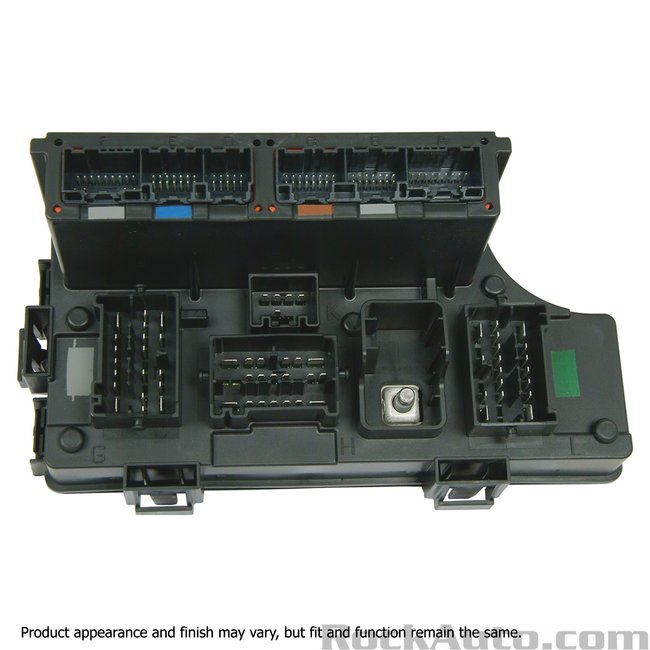

That's the tipim fuse box under the hood I have seen them go bad and cause all kinds of problems.it's a fuse box with a computer.They can be intermittent and hard to diagnose.Try clearing the codes then while it's running push on the relays and different parts of the tipim fuse box and see if the codes come back.

today i took off the tipm from his mounting bracket and wiggled the connectors, a p0882 code shows up . the problem was the yellow with brown strip wire coming from the pcm had bad connection at the tipm connector. i think p0882 code is fixed i cleared the codes and i did not see code p0562 yet.

today the p0882 code came back. i removed again the tipm and wiggled the wire that i fixed last time coming from the pcm to the tipm no code (p0882). i did the test when the ignition was in run position engine off i did not see code in the obd2 code reader.after that i said ok lets wiggle the computer connectors. when i did that strange things happend the obd reader did not want to communicate with the pcm , the anti theft security light was flashing and squares arround the PRND symbols in the dash.
is it normal ? or i have problem with the pcm connectors
Aug 7, 2016 at 1:52 PM
SATURNTECH9
  • 30,869 POSTS
Sounds like the wires the terminal tightness at the end of the connector opening or the tipm itself My best guess would be a open terminal end on one of the large main power feed wires.
