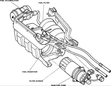

I have a 1990 volkswagon passat gl 2.0 wagon and it wont start anymore origanlly I started it and it stalled. After sitting for a year now it wont start at all cranks but no start I check the fuel sending and recieving unit and its working I got gas coming up to the fuel disriburion center in the front of car but I got no gas goin to injectors. I think there is no suction or vaccum in the line or maybe the secondary fuel pump isn't working. Does this sound right and if so which fuel pump do you think isnt working the one in tank or out of tank? It does start with starting fluid in the intake

Hi 12voltinstalls, Welcome to 2carpros and TY for the donation this is what keeps the site going
Do you hear the fuel pump come on when you turn key to run? If so check the fuel pressure
https://www.2carpros.com/forum/automotive_pictures/12900_fp_volks_1.jpg
The Main Fuel Pump is mounted next to the fuel filter, the fuel accumulator and the fuel reservoir as they all use the same mounting bracket, these components are located under the rear of the vehicle. The Fuel Pump supplies a high rate of fuel to the fuel injection system. Operation of the pump is controlled by the fuel pump relay. The relay energizes the Fuel Pump briefly (approx. 1.5 sec.) when the ignition switch is turned "ON", as well as energizing the pump during cranking (starting). The fuel pump relay will keep the Fuel Pump energized as long as the engine is running. The CIS-E Motronic fuel injection control unit uses an engine speed signal from the ignition system as an input for fuel pump control and will stop the Fuel Pump if the engine is not running. In order to maintain the pressure in the fuel system under all possible operating conditions, the pump supplies substantially more fuel than the engine needs at maximum engine loads
The Fuel Pump is a roller-cell pump consisting of a cylindrical hollow chamber in which an eccentric rotor plate rotates. This rotor plate is fitted with metal rollers that are held in pocket-shaped recesses around the circumference. When the rotor plate rotates the rollers are pressed outwards by centrifugal force and act as a circulating seal. The pumping action is created by the circulating roller seals which draw fuel from the inlet port and then forces fuel through the outlet port. There is also an internal pressure regulator to prevent overpressure if there is blockage in the pump outlet or fuel supply line. A non-return check valve at the pump outlet prevents fuel from flowing back to the tank when the pump stops, as well as maintaining fuel pressure in the fuel lines which helps hot restarts.
