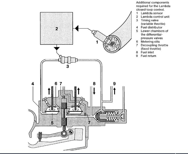

Hi. Recently acquired 1987 VW Cabriolet (210,000 miles, 1.8 L, 5-speed manual) which experiences stalling when in stop-and-go traffic after 5-15 minutes. Does not happen at highway speeds or light city traffic. It loses revs then stalls or it surges followed by pretty wild revs fluctuation then stalls. Will re-start but stalls again. After waiting about 15 minutes the car will function normally as long as I do not again encounter stop and go conditions. Same thing happened once upon sharp braking. Have replaced distributor. One injector was loose-ish - replaced donut o-ring. Others seem tight. Oxygen sensor light is permanently lit. Car does not overheat. Your help on this specific set of symptoms very much appreciated. have searched site but not found exact match, only come away with a long, long list of possible causes. Thank you.

Good evening,
This model had a fuel distributor that controls the idle and high speed operation.
This unit tends to carbon up over time and needs to be cleaned and adjusted. You will need a shop with an old timer like me that can perform this procedure.
It is not hard or expensive to do this service.

Have a shop experienced with older VW systems clean and adjust the fuel distributor, which controls idle and high-speed operation and commonly carbons up.
