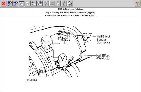

Did you test the Hall Effect sender
https://www.2carpros.com/forum/automotive_pictures/12900_1_1.jpg

No I didn't check the Hall Sender, honestly I never new about it, what should the Voltage range be, and how do I check (ignition on/off), I imagin engine not running while testing.
