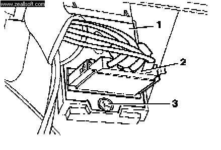

When I turn on my heat, the only time the fan blows is when it is on high. What part do I need to replace and how do I do it? Thanks for your help.
Sunday, November 18th, 2007 AT 6:05 PM
BMRFIXIT
MECHANIC
19,053 POSTS
Blower motor resistor this with AC
