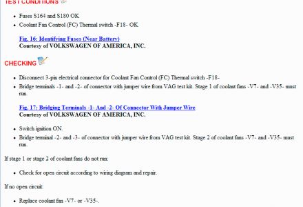

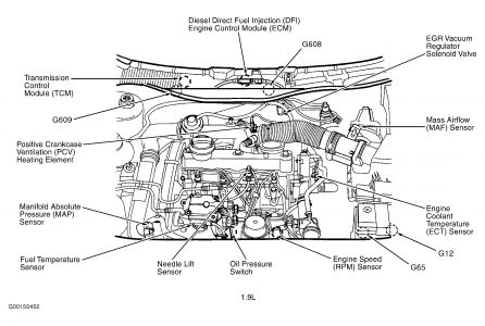

Hi, My 2000 jetta has 220,000 miles and is the base model for that year. The engine cooling fan stays on for a long time and even killed my battery.Is there an amount of time in which it should shut down and do you hane any solutions for me to try ? Thanks,Gregg

Yes change the temp sensor! and pray that's it.

Replace the engine coolant temperature sensor, which can keep the cooling fan running and drain the battery.
Conversation Summary
The owner of a 2000 Volkswagen Jetta with 220,000 miles says the engine cooling fan stays on for a long time and drained the battery. The expert recommends replacing the temperature sensor.
