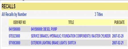

By the way, it looks like you may have some recalls on your vehicle. The dealer may fix these for free. Please contact the dealer service department, give them the VIN number of your car and have them check on these to see if they apply to you.
https://www.2carpros.com/forum/automotive_pictures/248015_recalls_3.jpg

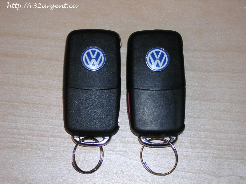

2003 jetta - Is this a fuse problem? Everything is working fine it's just the key to unlock the car won't do it anymore and sometimes it will. Also my cabin light that turns on when the door is open stays on so I have to turn it off manually. And horn does not chirp when doors are locked. Is this a fuse or relay problem how to fix it?
Thursday, October 15th, 2020 AT 11:54 AM (Merged)
RIVERMIKERAT
  • 6,110 POSTS
The electronic key/power locks? Battery in the keyfob is dying. Dome light issue is a door pin switch. The horn issue is too, probably. If you set the panic alarm, does the horn sound?

RIVERMIKERAT
  • 6,110 POSTS
For the keyfob. The part in the picture. I understand they're integrated, but I mean the plastic part that has the buttons you press to lock/unlock.

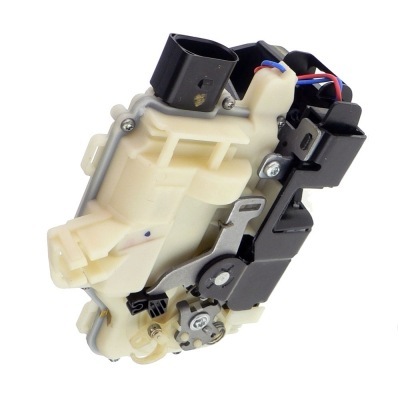

I recently took my VW in to get new tires, serpentine belt, anitfreeze, oil change, headlight restoration, and air filter.
When I got my car back, the car seemed to think the driver's side door was always open. The lights stay on, the warning bells chime, etc. I can't lock the doors remotely or set the alarm. I've had to pull a fuse to keep from draining a battery (Light on the driver's door stays on for as long as it thinks the door is open), which means the windows don't work nor the interior lights.
The place doesn't seem to know how to fix it. Any ideas? Where is the sensor on a VW?

EXOVCDS
  • 1,883 POSTS
Sounds like the "micro" switch in the door actuator (locking mechanism)
is faulty.
This is a common problem. People have had success repairing them
via disassembly and replacing the switch or re-soldering bad solder
joints.
The quickest way is to replace the actuator.
To replace / remove the door actuator/latch, you need to remove the
door handle lock cylinder, the inside door panel and then the
window regulator & panel (separate window from window regulator).
Image of said part attached.
Thomas
