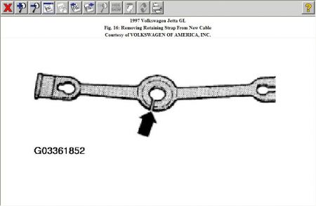

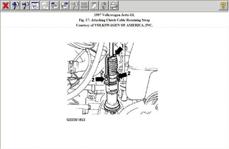

1997 Volkswagen Jetta clutch pedal got stuck
51,000 MILES • 6 CYL • FWD • MANUAL
PFALCO5
Hi- My 1997 Jetta had the clutch pedal stick half way engaged and we could not change gears. Pumping it all the way down and up about 10 times cured it. i was thinking that it may be a leak in the hydraulic clutch. i was going to add some fluid and i cld not find the reservoir. Do i have a cable clutch or other non hydraulic? if so, what can cause this problem that i had?
Aug 22, 2008 at 6:52 AM
  • 75,988 POSTS
The clutch assy is cable driven you might wanna start with the clutch retaining strap.
