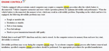

This capable scan tool theme seems to be a standars reply..but not true! Just drive as you normally do, and PCM will do the rest...
https://images.2carpros.com/forum/automotive_pictures/62217_Relearn_3.jpg
If it won't restart, determine what's missing, the engine needs three things to run, Spark at all plugs, gas to all cylinders, and compression in all cylinders, tho an engine may run lacking one in one cylinder, it won't run very well!

wow that was great generic info for most cars. unfortuantely some vw's need to have the idle value reset into the computer. i'm guessing you don't have the right scan device/software for this.

Ya this is the generic info taken from VW...for this car...
