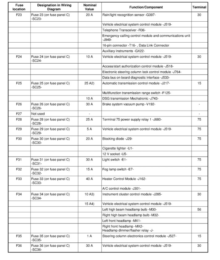

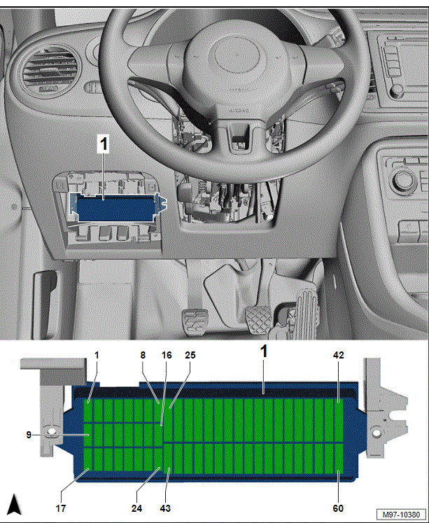

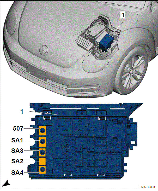

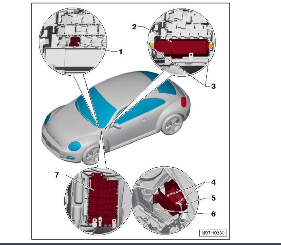

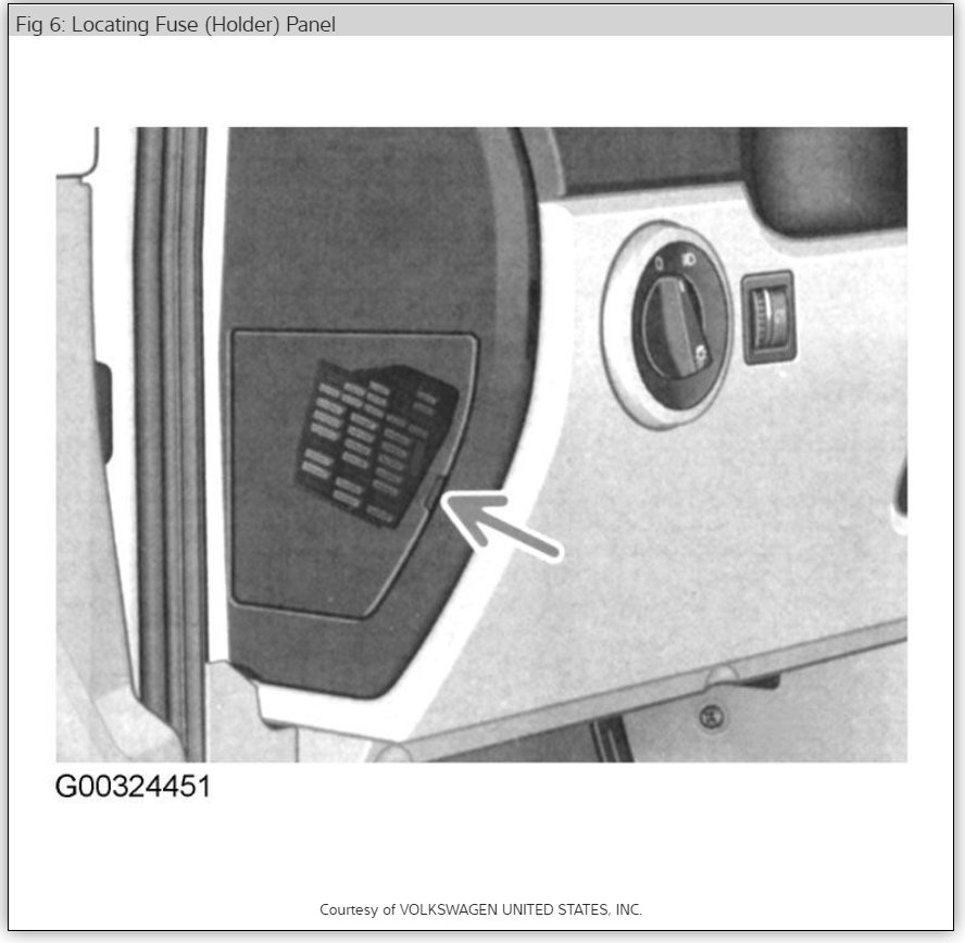

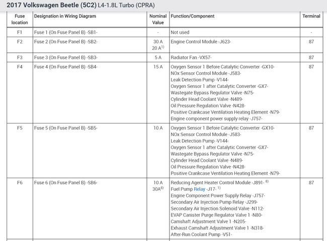

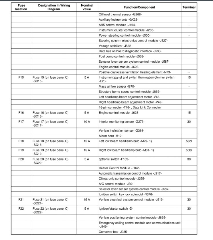

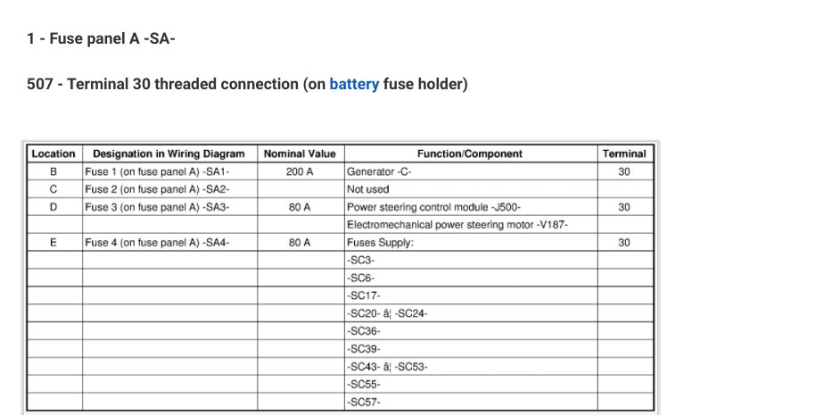

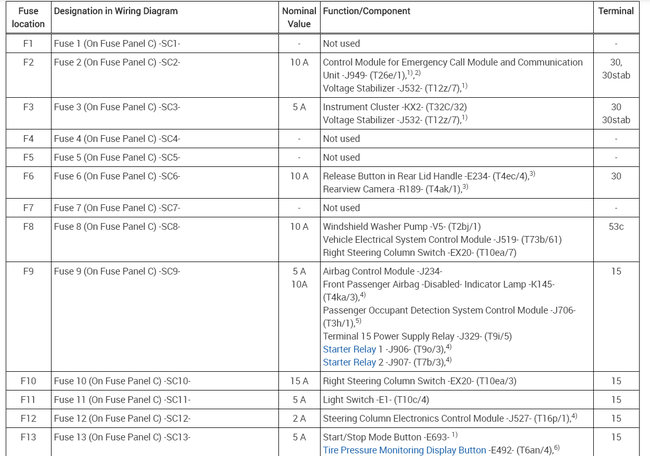

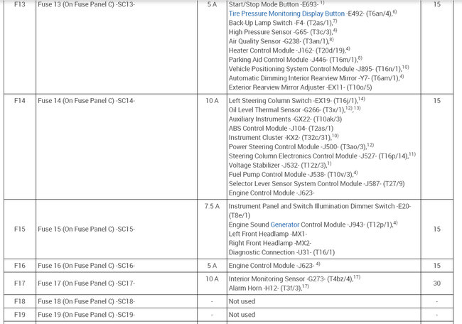

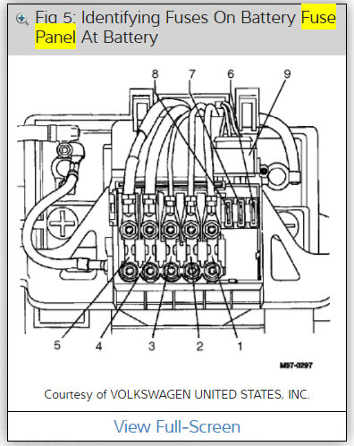

Someone please help. I need the fuse diagram for my vehicle listed above
VIN # 3VWFD7AT8IM718973. VW dealership decided for whatever reason to not include it in the owner's manual. I called the dealership to ask for a print out but they refused to give to me. I have searched all over the internet with no luck at all. I' am hoping somebody here can?
Tuesday, November 10th, 2020 AT 8:02 PM
39 Replies
  • 109,921 POSTS

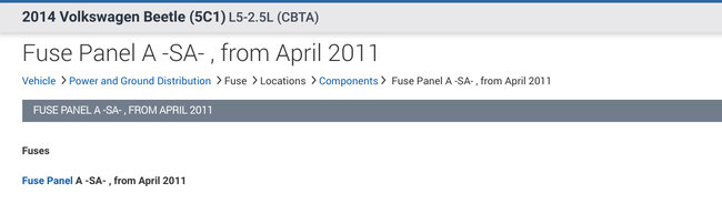

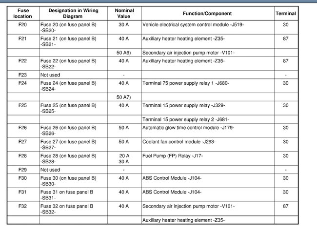

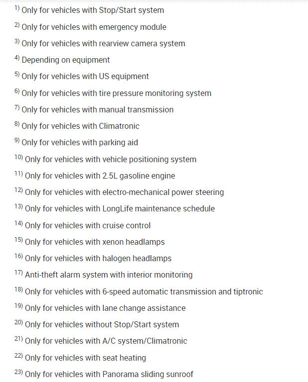

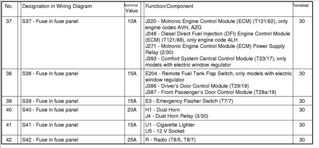

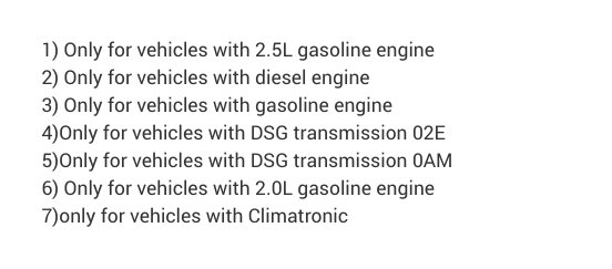

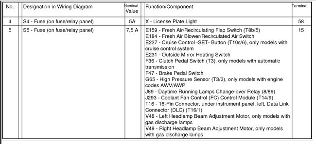

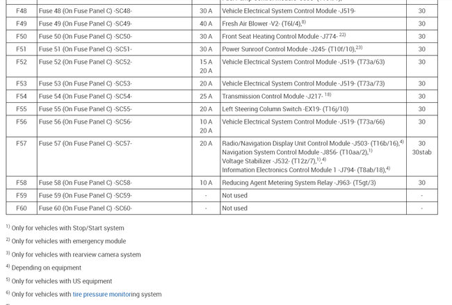

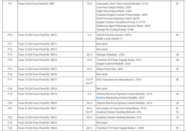

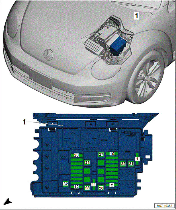

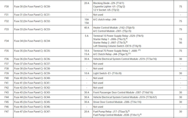

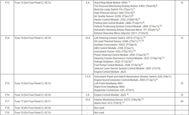

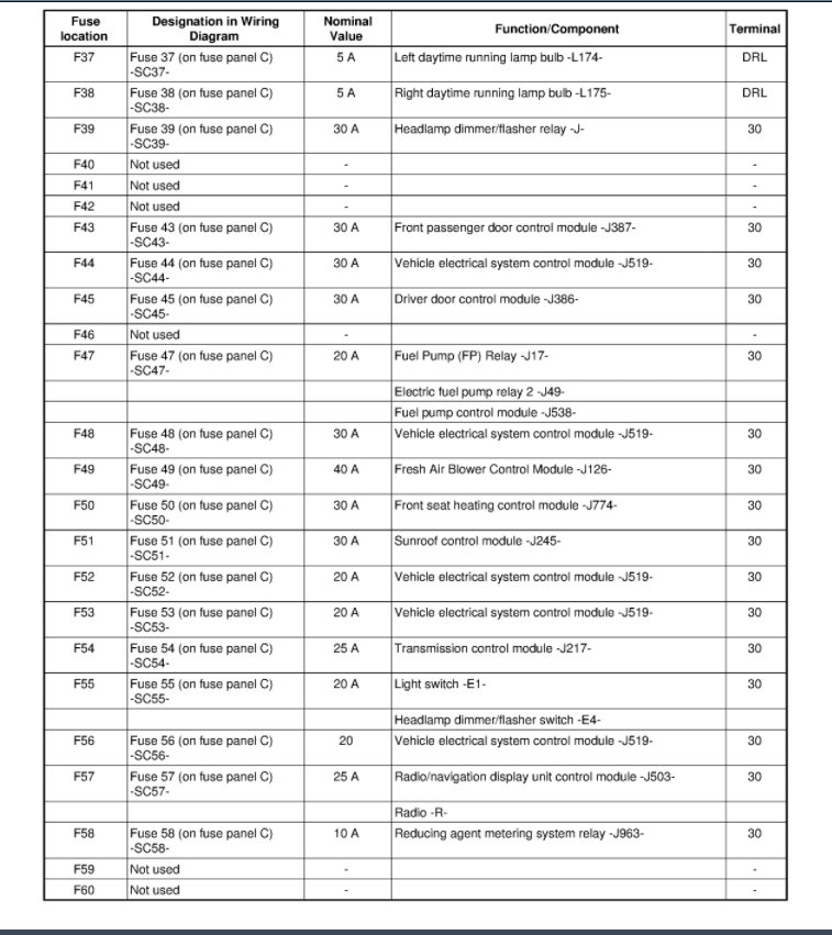

I will be happy to help.

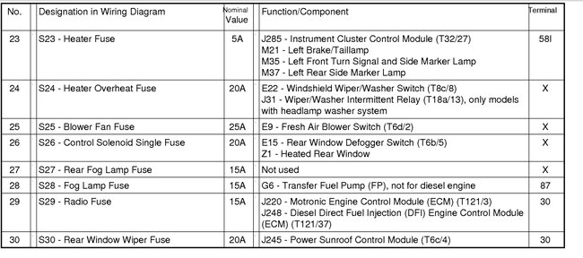

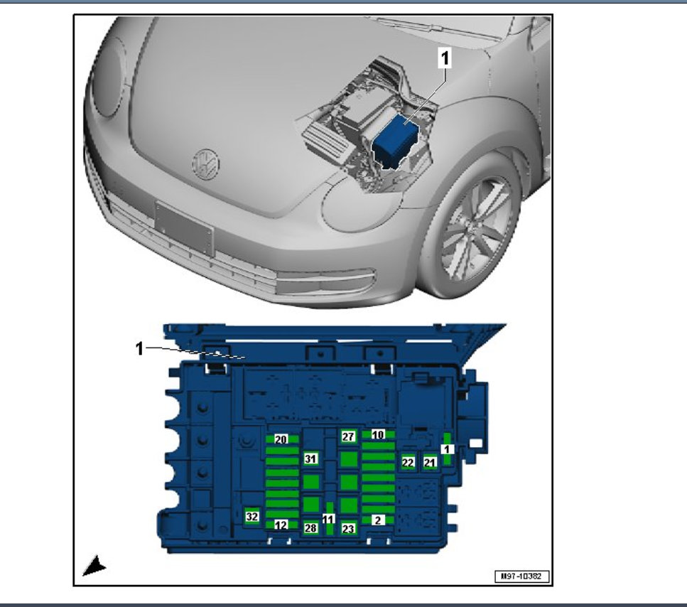

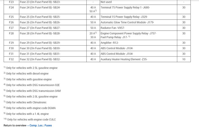

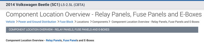

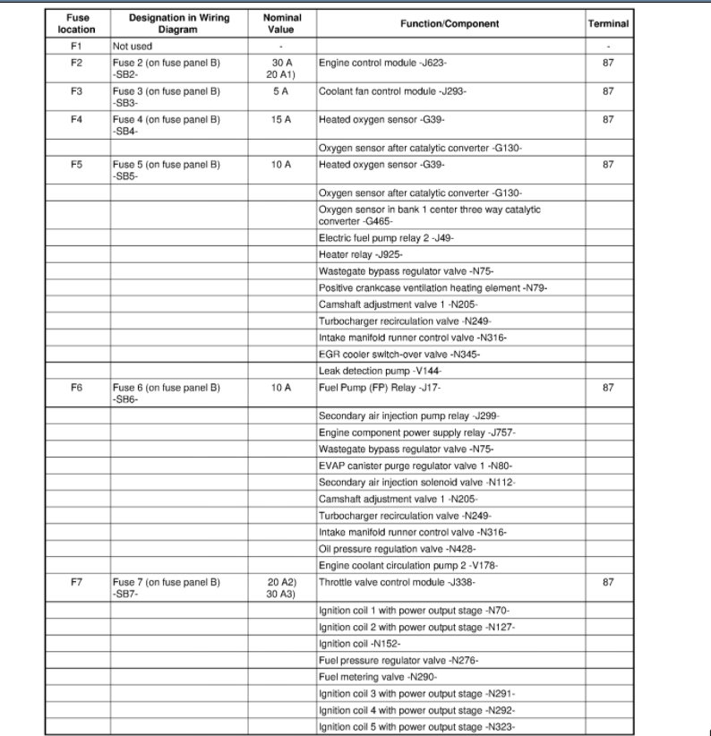

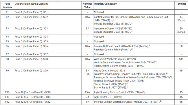

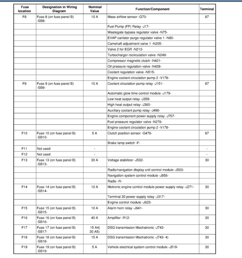

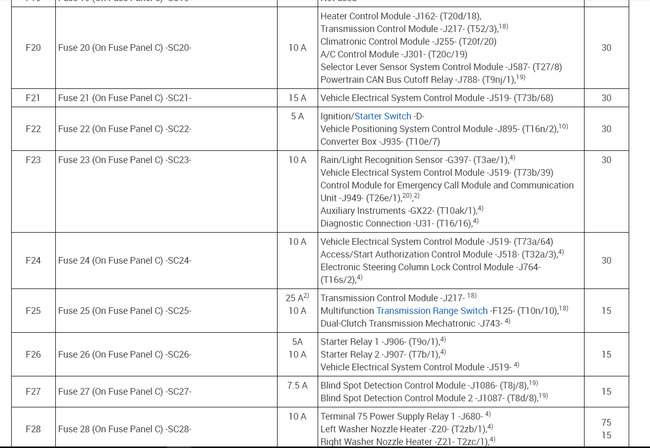

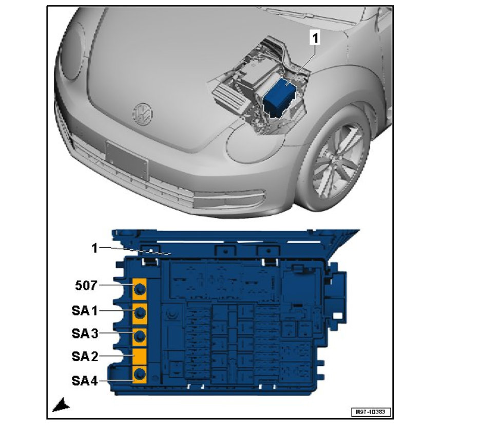

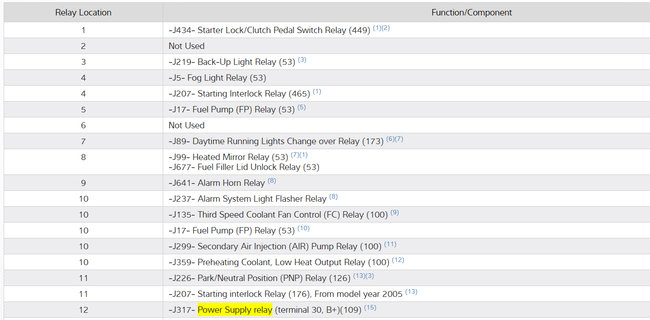

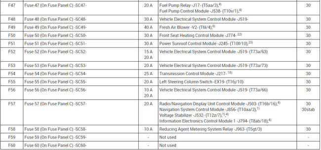

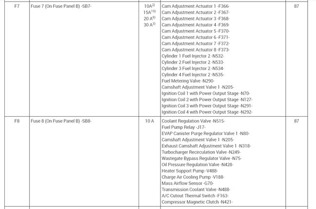

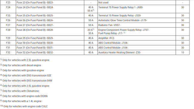

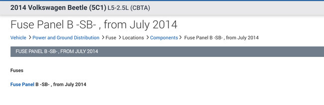

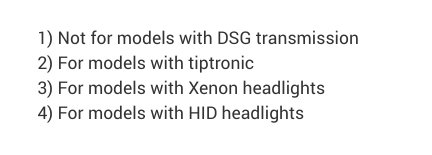

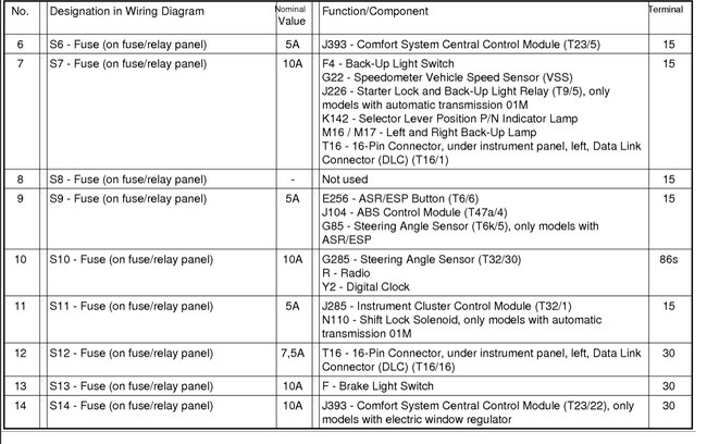

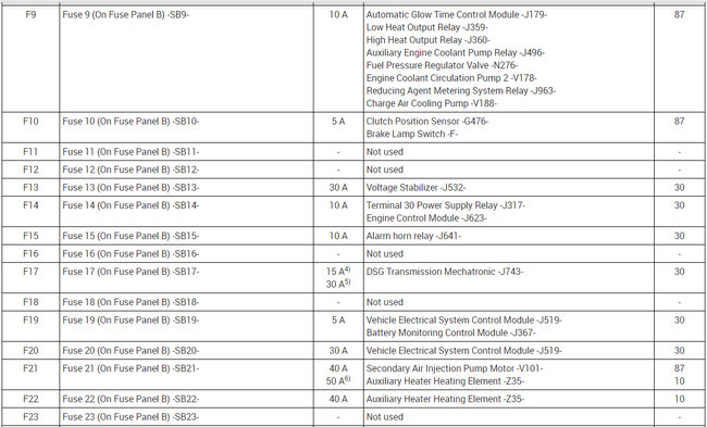

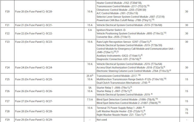

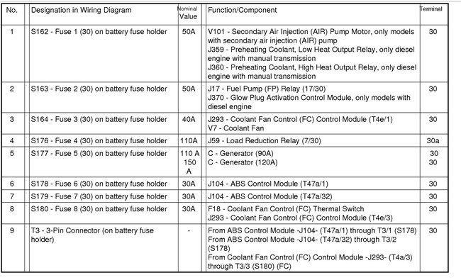

If you take a look below, I have listed things in order based on the fuse box location. The first 4 pics are from the BSB box shown in pic 1. Each fuse, its amperage, and what it protects is listed in pics 2, 3, and 4.

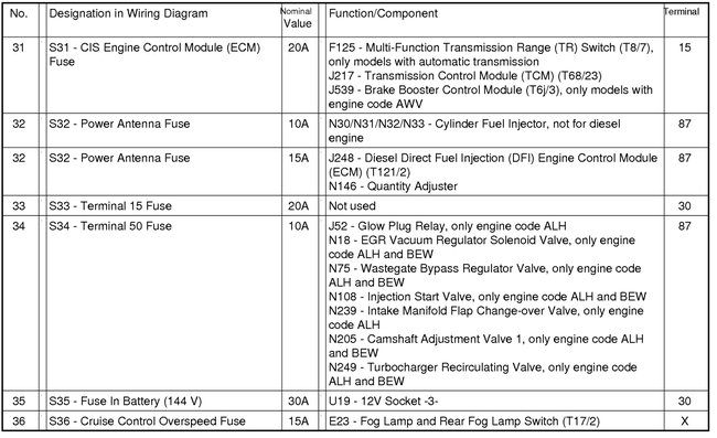

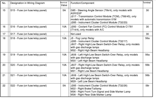

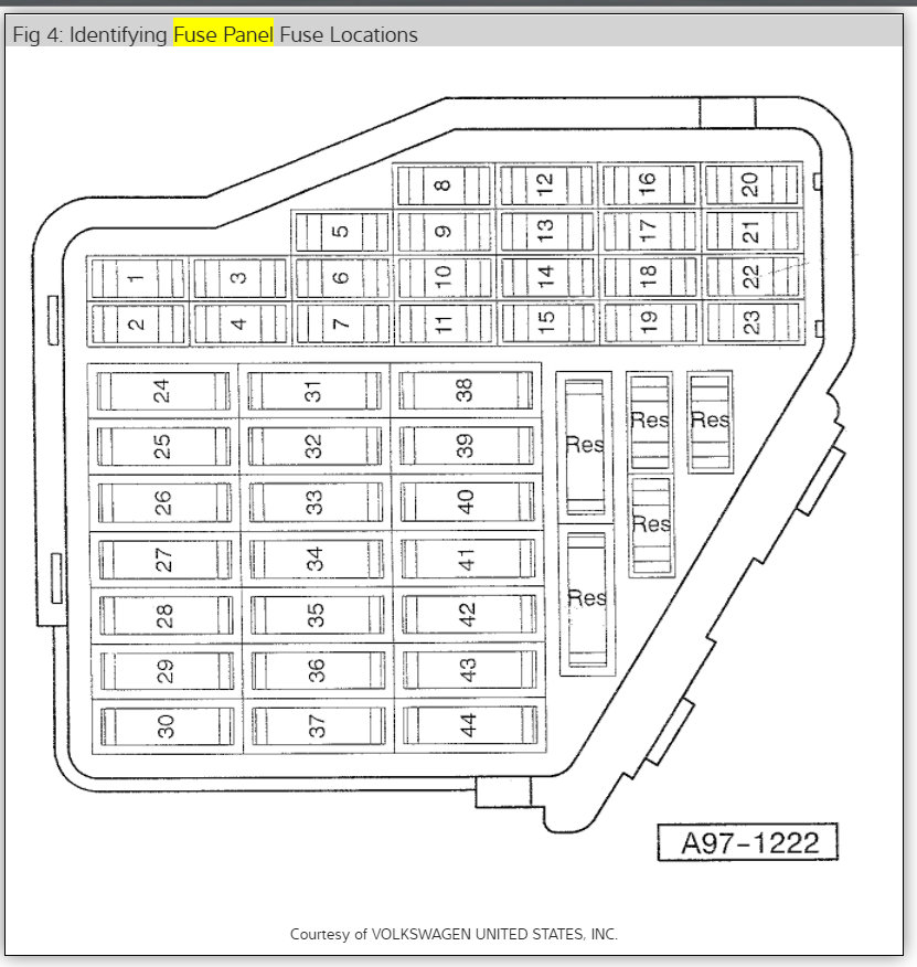

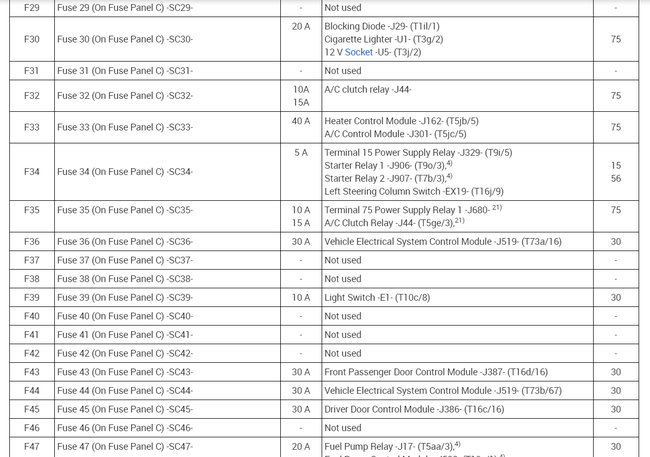

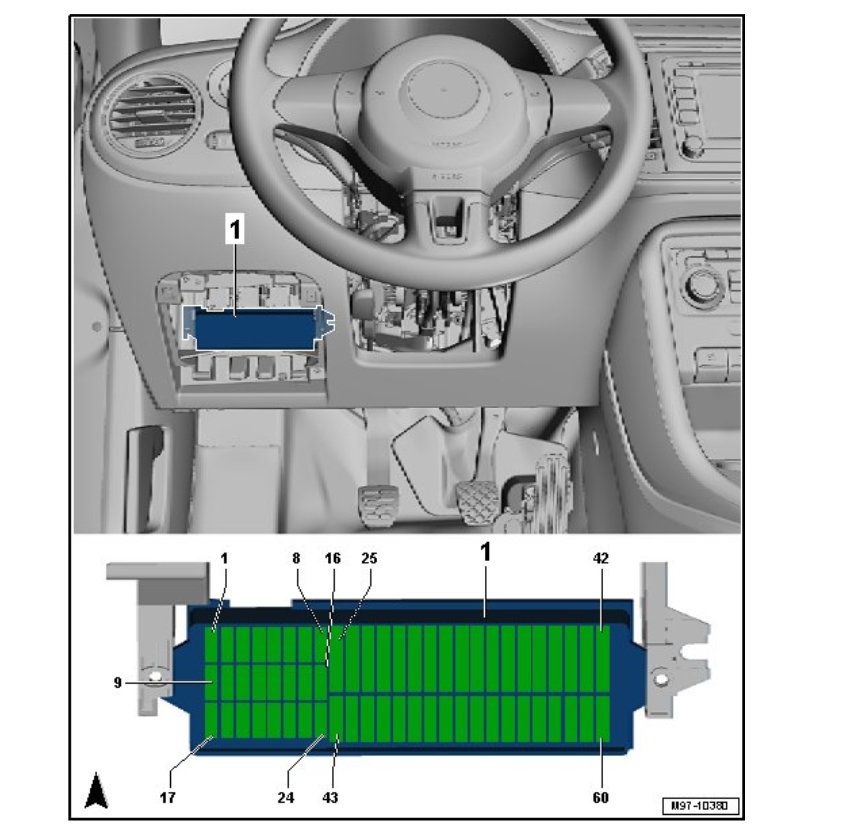

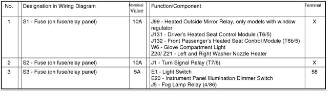

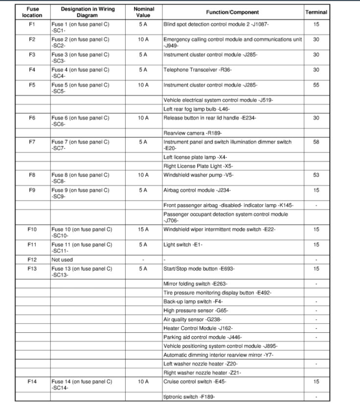

Starting with pic 5, I indicated fuse box location for box CSC. Pics 6-11 shows fuse amperage and what it protects.

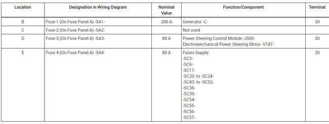

Pics 12 and 13 show the heavy-duty fuses in box ASA.
_________________
Let me know if this helps. If you have other questions, feel free to ask.

Where is the fuse diagram? I have had this car from new. I have all the manuals it came with but cannot find the fuse diagram. I know where my fusses are what I need is the diagram telling me which one is which.

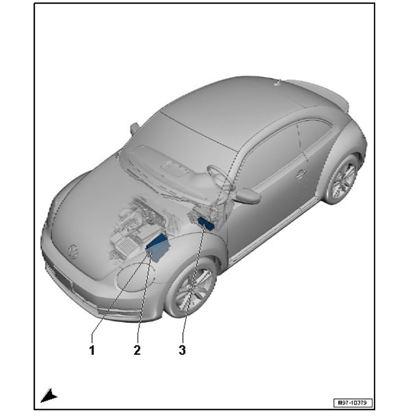

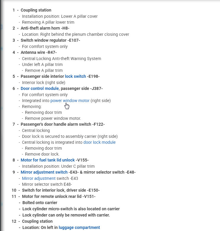

Hello, I am Danny.

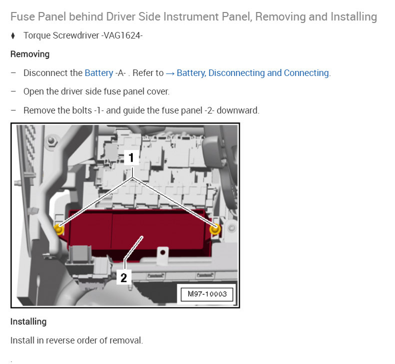

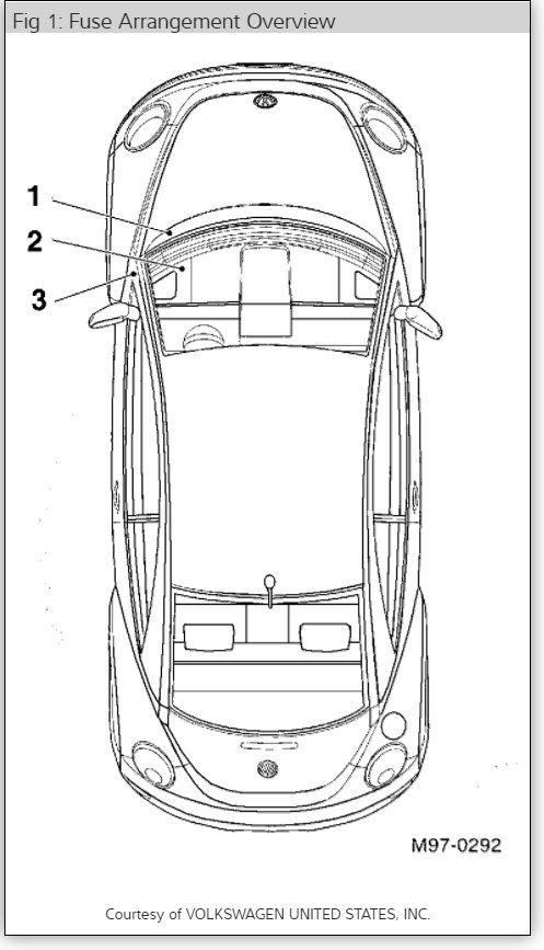

I have attached a picture describing its location and a guide to help you test.
Hope this helps and thanks for using 2CarPros. Check out the diagrams (Below). Please let us know if you need anything else to get the problem fixed.

No diagram in the owners manual for the fuses.
Friday, February 26th, 2021 AT 6:34 PM (Merged)

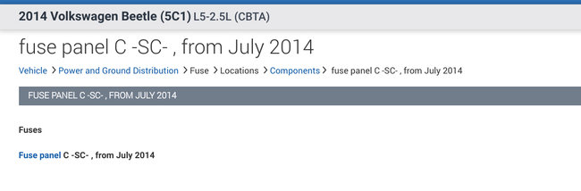

SCGRANTURISMO
  • 4,897 POSTS
I have included the information that you requested in the diagrams down below. I hope that this helps.
Thanks,
Alex
2CarPros
JTBROWNS
Thank you for the email I will try to locate the fuse I’m looking for it’s the one for the 12v outlets
SCGRANTURISMO
  • 4,897 POSTS
Hello again,
It is Fuse 30 on Fuse Panel C-SC.
Thanks,
Alex
2CarPros

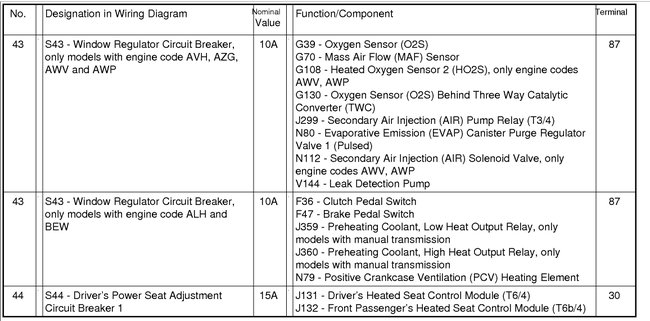

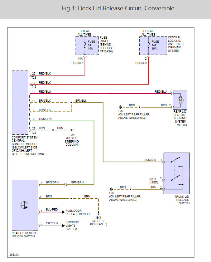

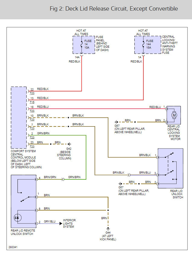

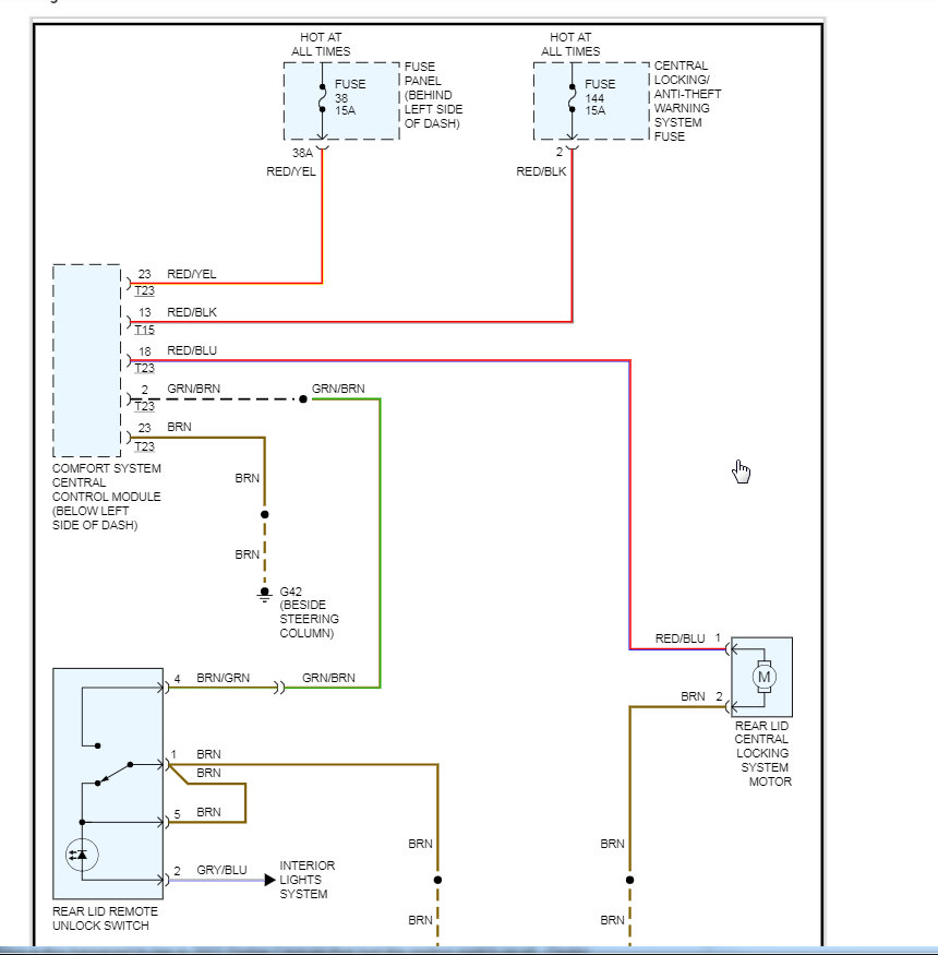

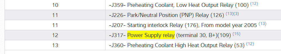

What fuse is for the trunk lid actuator in the car listed above it is a convertible? I can not determine which fuse it is in the instrument fuse panel box.
KEN L
  • MASTER CERTIFIED MECHANIC
  • 48,603 POSTS

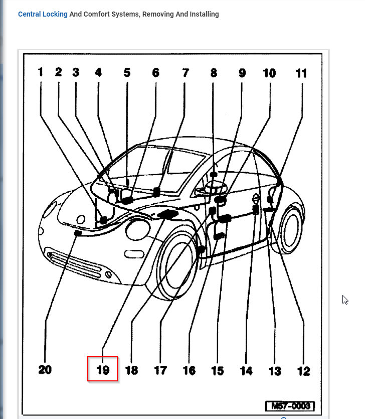

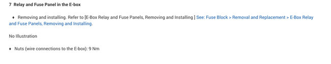

There are two fuses that run the rear trunk release system. please check fuse number #14 and #144. Here is a guide to help you test the fuse:
Here are the fuse panel locations and diagrams (below). I also have the truck release wiring diagrams to help you see how the system works.
Save this page in your favorites so you always have the fuse layout for your car. Check out the diagrams (below). Please let us know what you find. We are interested to see what it is.

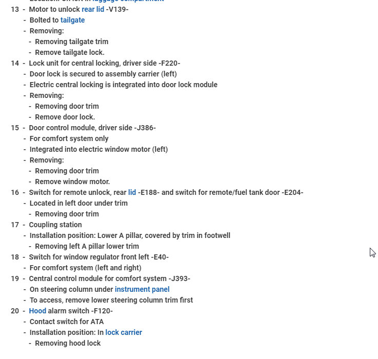

Where is fuse 144?

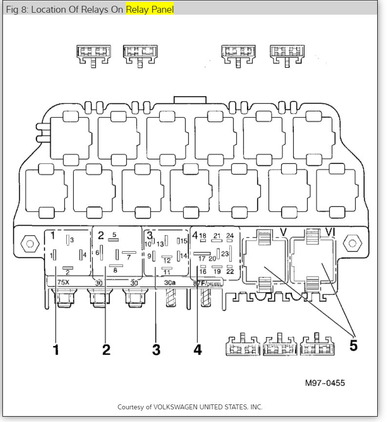

It is part of the central locking system module. I attached the info for this module.
I do not have clear information as to whether this is a serviceable fuse but I imagine it is as they normally say it is non serviceable if it were.

I assume you saw the attachments after that second post? If you still have issues finding the module we can try to find more detail on this.
