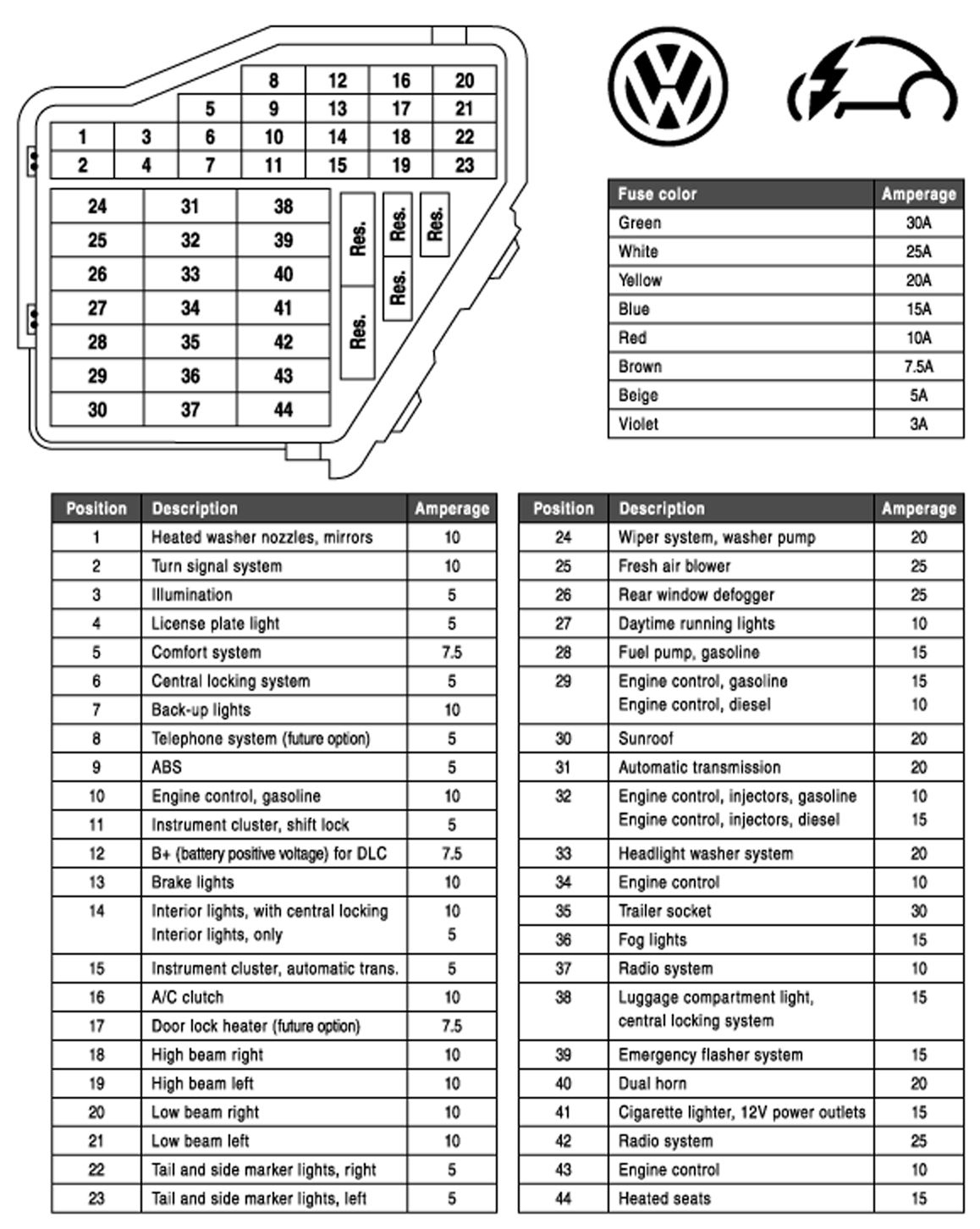

Where is the fuse box located in my car? I am having problems getting the button to open the gas tank and I need to check the fuses!
+1
Friday, February 26th, 2021 AT 6:35 PM (Merged)

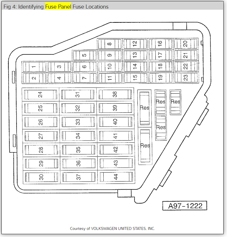

TREYBEAU

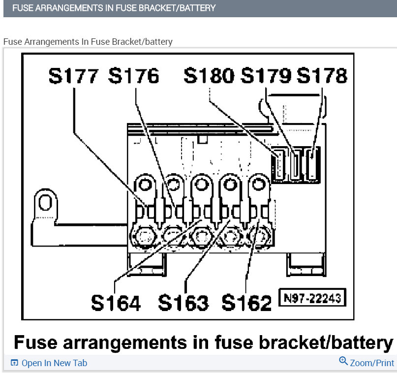

It is located on side of the dashboard on the drivers side. There are also three located on top of the battery. Here is a guide to help you test them and fuse panel diagrams below for your car.

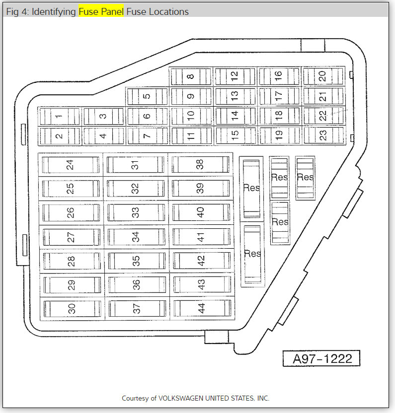

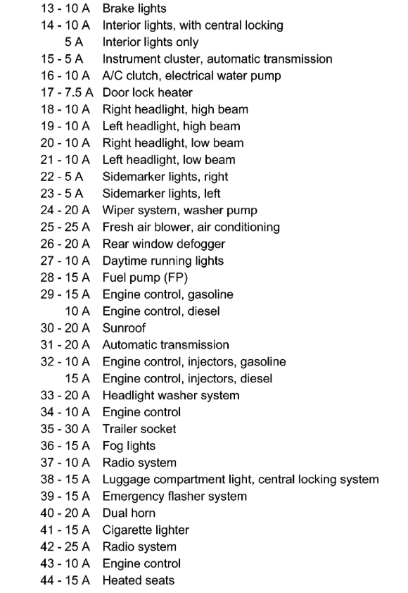

Fuse Arrangement in Fuse Panel
Fuse colors
30 A - green
25 A - white
20 A - yellow
15 A - blue
10 A - red
7,5 A - brown
5 A - beige
3 A - violet
Fuse arrangement in fuse panel, behind instrument cluster, left
Fuse Arrangement In Fuse Panel
https://www.2carpros.com/forum/automotive_pictures/12900_f_4.gif
Fuses from S24 to S44 are identified with additional prefix 2, in wiring diagram.
Example: Fuse S40 on fuse panel is listed as S240 in wiring diagram.

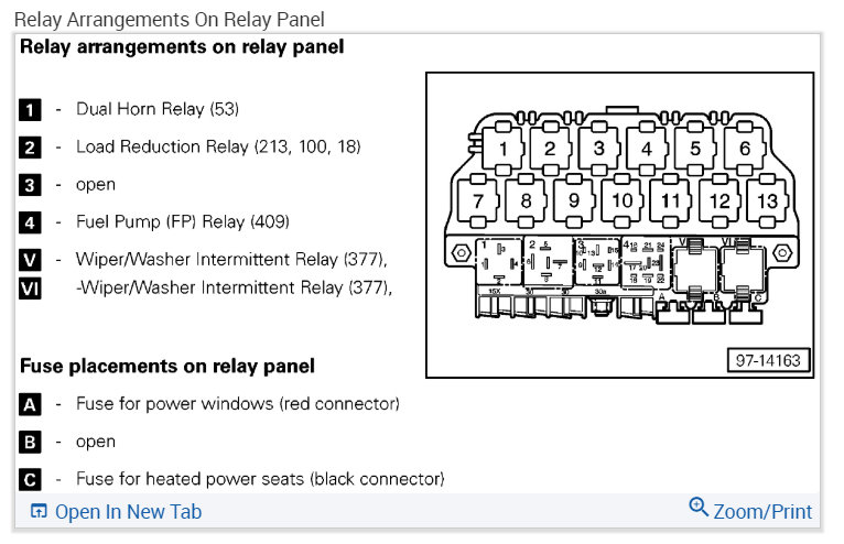

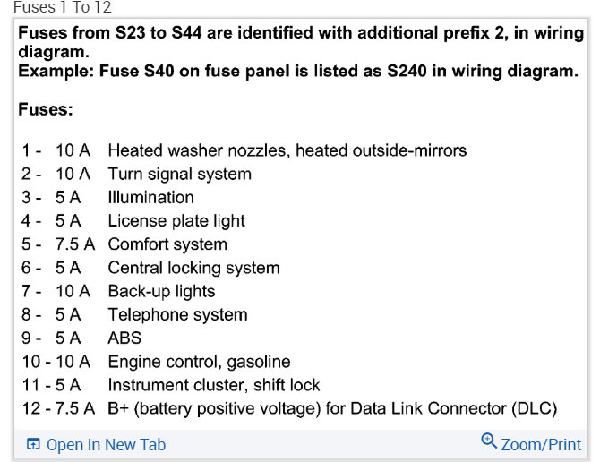

Fuses:
1 - Heated washer nozzles, heated outside mirrors 10A
2 - Turn signal system 10A
3 - Illumination 5A
4 - License plate light 5A
5 - Comfort system 7.5A
6 - Central locking system 5A
7 - Back-up lights 10A
8 - Telephone system 5A
9 - ABS 5A
10 - Engine control, gasoline 10A
11 - Instrument cluster, shift lock 5A
12 - B+ (battery positive voltage) for DLC 7.5A

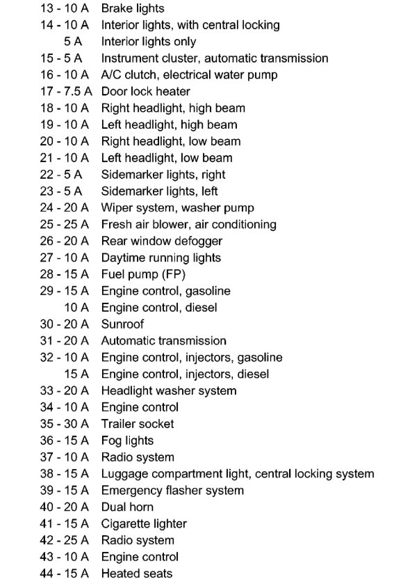

13 - Brake lights 10A
14 - Interior lights, with central locking 10A
- Interior lights, only 5A
15 - Instrument cluster, automatic transmission 5A
16 - A/C-clutch, electrical water pump 10A
17 - Door lock heater 7.5A
18 - Right headlight, high beam 10A
19 - Left headlight, high beam 10A
20 - Right headlight, low beam 15A
21 - Left headlight, low beam 15A
22 - Sidemarker lights, right 5A
23 - Sidemarker lights, left 5A
24 - Wiper system, washer pump 20A
25 - Fresh air blower, air conditioning 25A
26 - Rear window defogger 25A
27 - Daytime running lights 10A
28 - Fuel pump (FP) 15A
29 - Engine control, gasoline 15A
- Engine control, diesel 10A
30 - Sunroof 20A
31 - Automatic transmission 20A
32 - Engine control, injectors, gasoline 10A
- Engine control, injectors, diesel 15A
33 - Headlight washer system 20A
34 - Engine control 10A
35 - Trailer socket 30A
36 - Fog lights 15A
37 - Radio system 10A
38 - Luggage compartment light, central locking system 15A
39 - Emergency flasher system 15A
40 - Dual horn 20A
41 - Cigarette lighter, 12V power outlets 15A
42 - Radio system 25A
43 - Engine control 10A
44 - Heated seats 15A

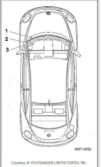

The fuse panel is located behind a cover on the driver side end panel of the instrument panel (dashboard).See below:

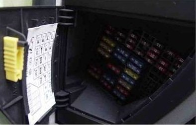

STEVEW84
  • 673 POSTS
https://www.2carpros.com/forum/automotive_pictures/170495_fuse_box_1.jpg

KENW1
  • 213 POSTS
Thanks for visiting 2CarPros.
The fuse box is located at the end of the drivers side of the dash. if you pry the end panel up the door will open. I'll post a view of that and the diagram below for you. Below is a guide on fuse testing and replacement.

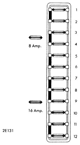

What amp fuses and where do they fit in the ten slot fuse box?
Friday, February 26th, 2021 AT 6:36 PM (Merged)
HARRY P
  • 2,292 POSTS
This is all I can find. It is not much, but maybe it means more to you than it does to me.

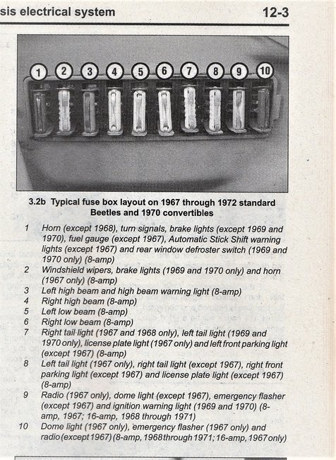

SAVANNE
That fuse block is for a Super Beetle. The standard only has ten fuses. I cannot believe that I cannot find this online. I have tried several times.
HARRY P
  • 2,292 POSTS
The reason you cannot find it is because that is the only thing that has been released by VW. According to Prodemand (where I got that picture from): "Fuse block will vary in total number by equipment found on vehicle." Plus this is supposed to cover all 1963-1972 Beetles.

SAVANNE
Well, then, according to the image of the fuse box, are we to understand that #9 and all the others below it get a 16 amp fuse, while 1-8 get an 8 amp?
HARRY P
  • 2,292 POSTS
That is the way I take it, but I am going to "phone a friend" on it and see.

HARRY P
  • 2,292 POSTS
Look what we came up with! This is more specific to your Beetle, and it is clearly laid out.
+1
SAVANNE
Dude! I do not know where you found that, I have been looking for days. Thank you so much!
