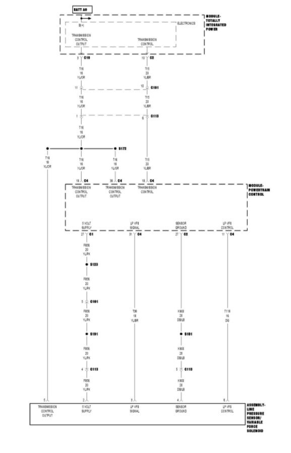

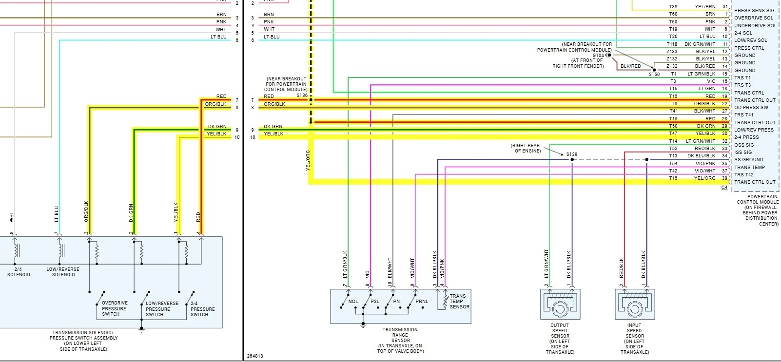

So there is no way around it what if i got a new sensor and i also get a code of p0935 and a code p1745. Could it be because the transmission lines are backwards or not? I don't have money to take it to a shop or to the dealership so there is no other option out there? My scanner is a Foxwell nt710 and do you know if it would work to clear the code or no?
Apr 18, 2025 at 1:51 PM
STEVE W.
  • 15,295 POSTS
P0935 is a circuit code for the line pressure sensor. It could be a bad sensor or a wiring fault in the connector to the transmission. If that code is present, it will set the P1745 which is a code saying that the line pressure has been high for a set length of time.
Repair the fault causing the P0935 and the P1745 may clear. I would check the wiring harness to the transmission over and look for shorted or broken wires.
