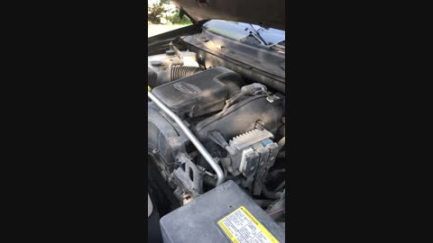

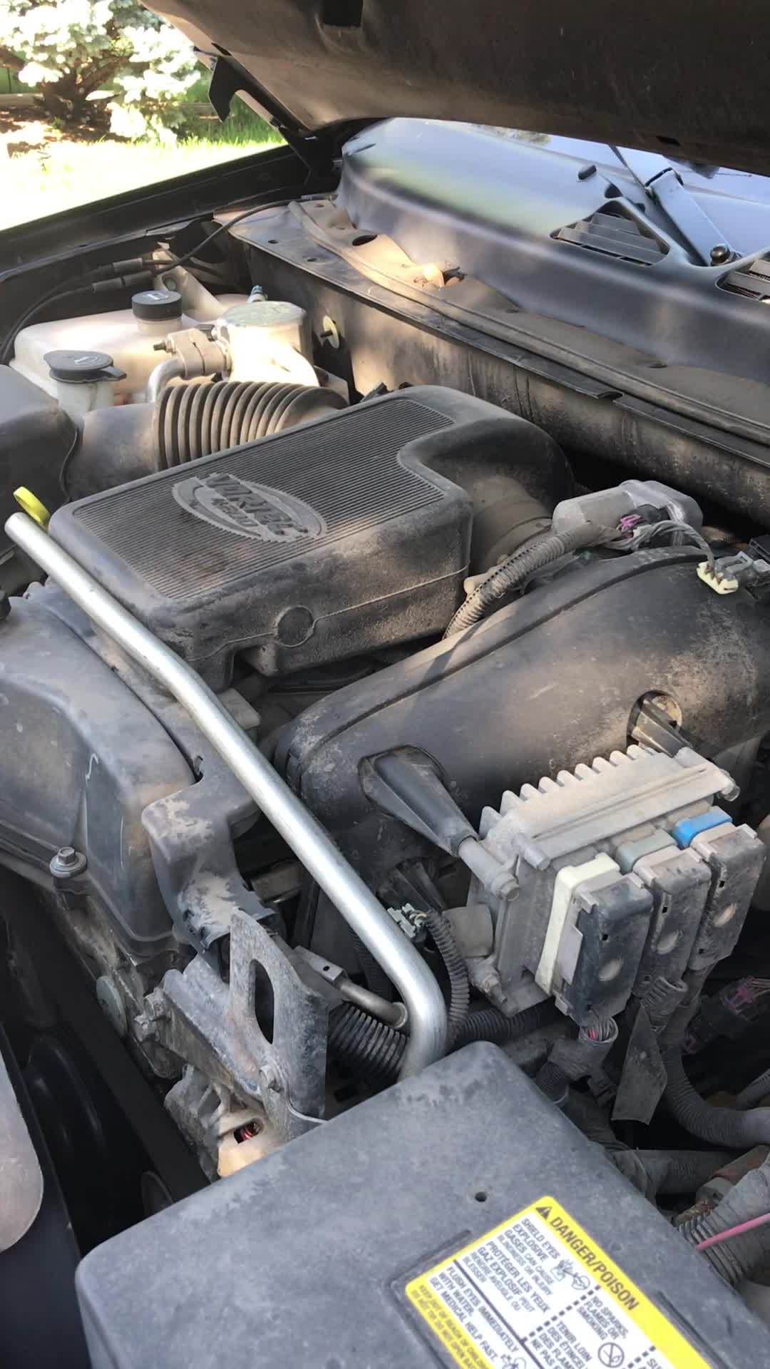

In the past 24 hours, following a long road trip, my car has developed a noticeable shake/vibration (almost like when bass is too loud) only when my foot is holding the break pedal down in drive or reverse gears.
This does not happen while I'm driving, and it does not happen in park. When I am idle at a red light, stop light, or waiting to back up, that is when this noise/feeling happens. I can't diagnose where exactly it's coming from, it feels like it's probably under the hood but I can't look under the hood while replicating the problem with my foot under the break. I have read about motor mounts, engine misfiring, EGR valves, gasket leaks, fuel pump filters, spark plugs. no idea where to begin.

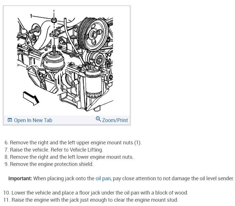

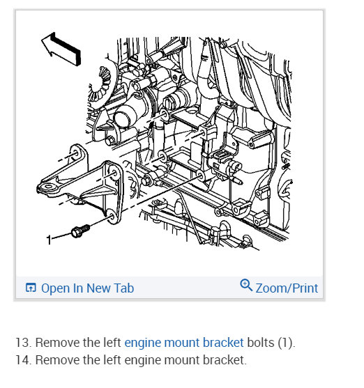

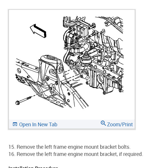

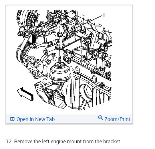

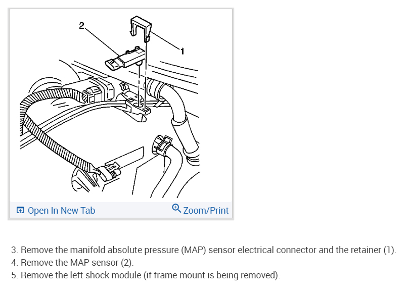

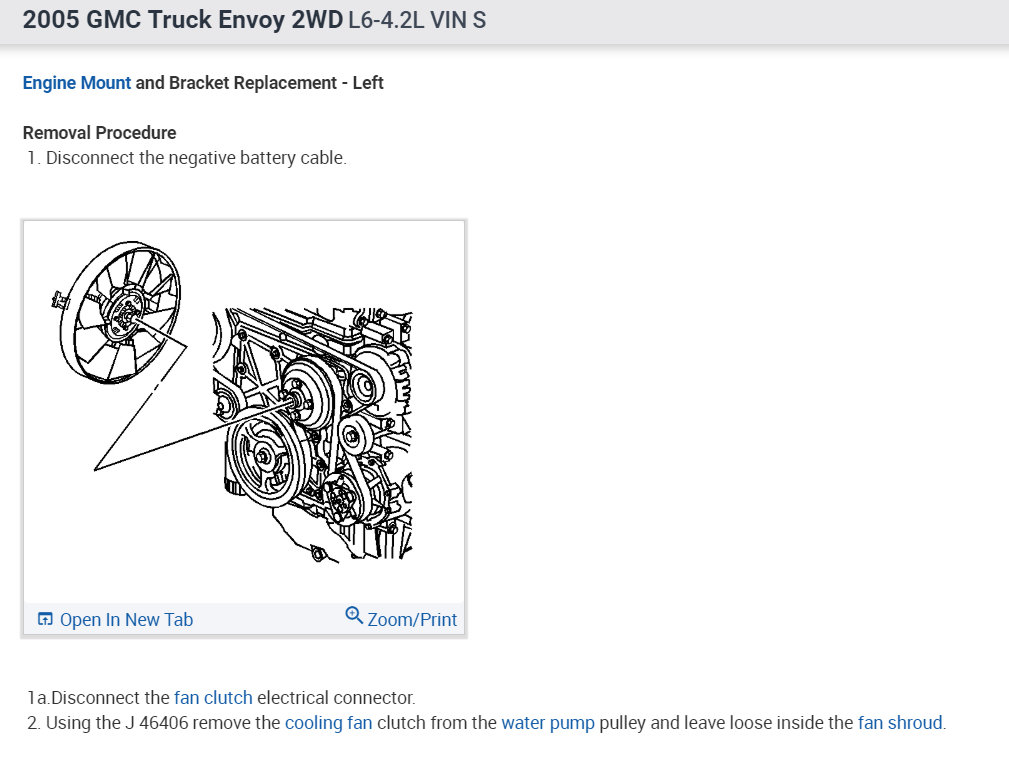

Yep, engine mounts are my opinion here especially with that kind of mileage. Here are diagrams to help you replace the them below.

Joe, after testing some of the things you said, here is what I found:
1) This IS only happening when the AC is running. It's 100 degrees every day here where I am, and I turned off the AC and tried to replicate and had no problems. Turned on the AC, and got the vibration again.
2) I opened the hood and had someone replicate the problem while I looked under the hood. Basically it looked like the engine would shake every few seconds. I attached a video (sorry if poor quality), at about 2 seconds you can see the engine kind of shake.
3) I am embarrassed to say I have not had an engine tune-up done yet on this vehicle, and the check engine light has been stuck on for 5 years because I had an issue fixed but they couldn't get the check engine light off and I never figured it out.

Thanks for the video. it does look like the engine is misfiring causing the problem, also the AC system can be overcharged which will cause this issue as well.
Lets do a tune up first and go from there. here are two guides to help walk you through the repair:
