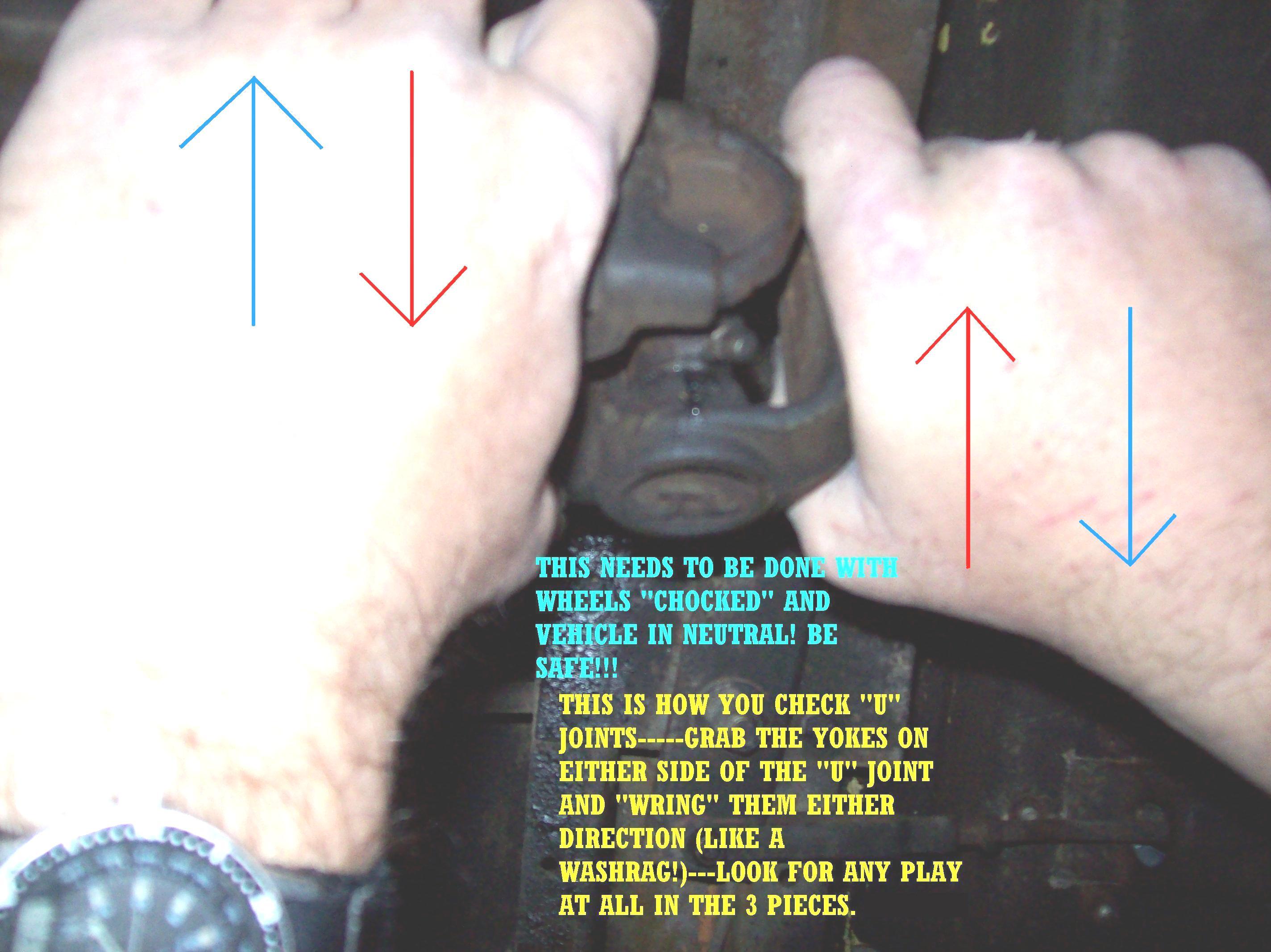

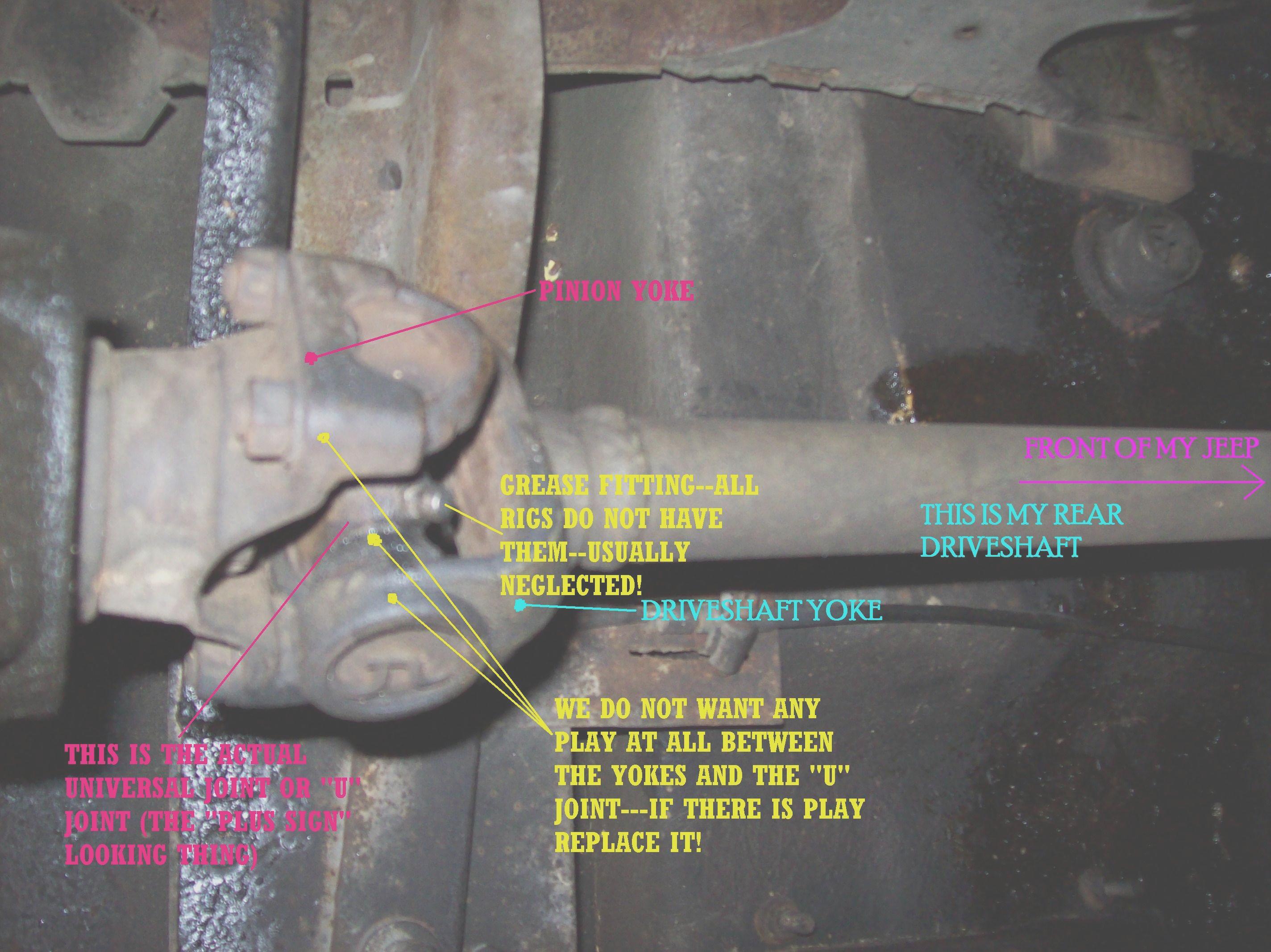

THIS IS HOW TO CHECK YOUR U-JOINTS
SEE 1ST 2 MY PICS....I NEED TO RE-MAKE THEM, THEY ARE HARD TO READ

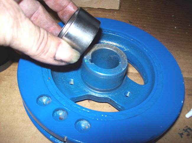

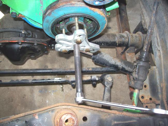

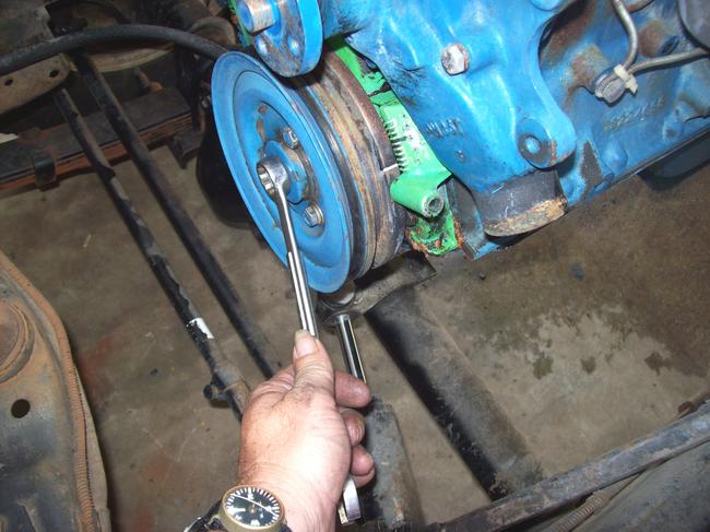

LOOK AT MR. HARMONIC BALANCER---HE IS 2 RINGS WITH RUBBER SANDWICHED IN THE MIDDLE, SOMETIMES THE OUTER RING STARTS "WALKING OFF" THE INNER RING WHEN THE RUBBER GETS OLD......FINALLY, IT WILL COME ALL OF THE WAY OFF. YOU CAN SEE THE RUBBER ON MINE (PAINTED) WHEN I WAS INSTALLING A REPAIR SLEEVE ON THE SEAL SURFACE....SEE PIC 3
THERE IS A PULLEY BOLTED TO THE FRONT OF THE BALANCER.....DON'T MISTAKE IT FOR THE BALANCER....I TOOK 168 PICS THROUGHOUT THE INSTALL-AGE OF MY NEW TRU DOUBLE ROLLER TIMING CHAIN SET.....IN PIC 4 YOU WILL SEE THE PULLEY......PIC 6, THE PULLEY IS REMOVED LEAVING THE HARMONIC BALANCER (BEING PULLED)
