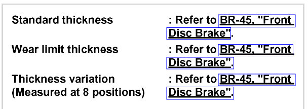

vibration in the steering wheel when I hit the brake
2010 NISSAN ALTIMA
199,900 MILES • 2.5L • 4 CYL • 2WD • AUTOMATIC
LAURALEI93

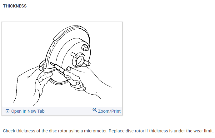

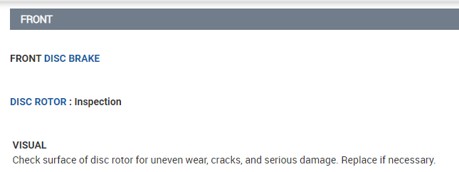

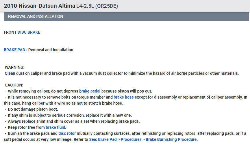

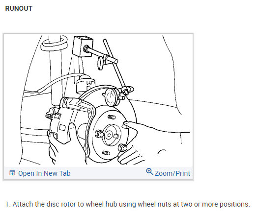

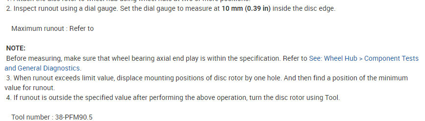

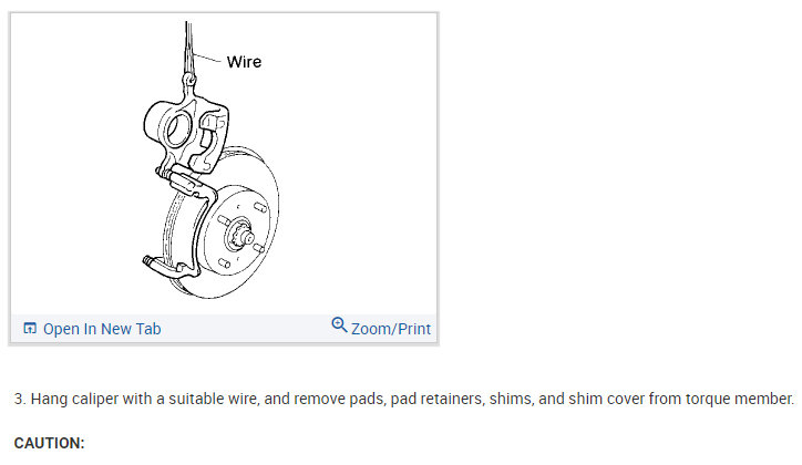

When I am driving and reach past fifty five to seventy mph I start feeling a vibration in the steering wheel when I hit the brake I think the rotors are gone
Feb 19, 2018 at 6:22 AM
DANNY L
  • 5,648 POSTS
Hello, I'm Danny.

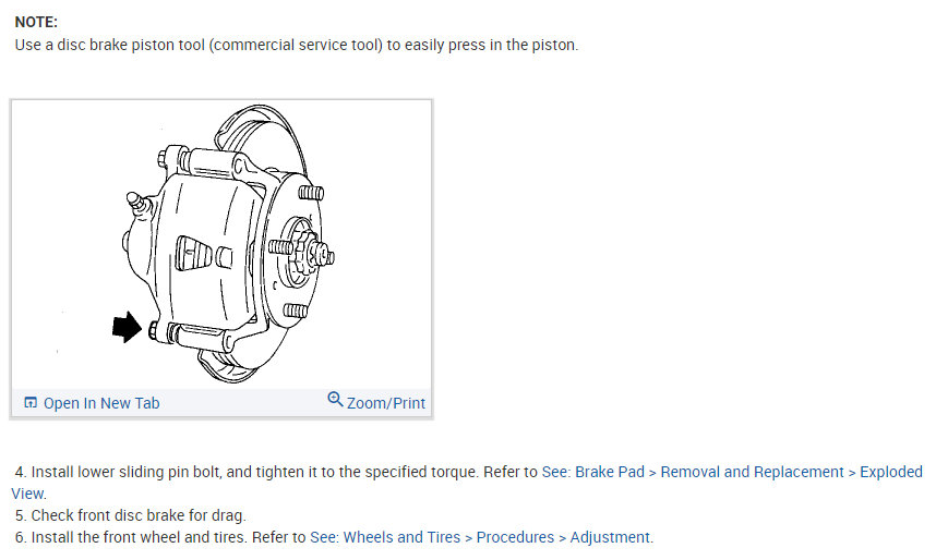

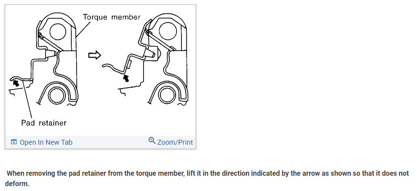

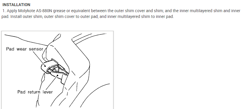

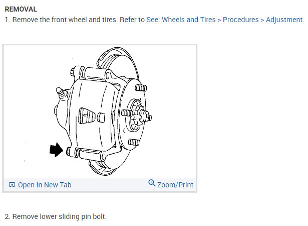

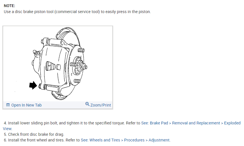

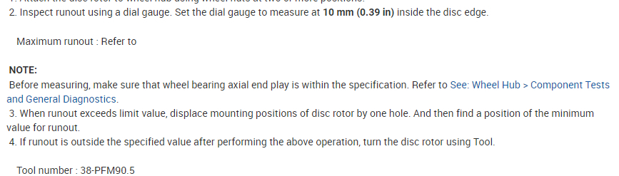

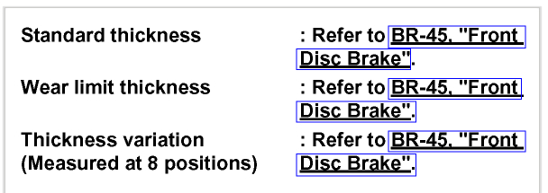

Here is the information you requested. Yes, It's possible from the brake pads are worn, glazed, or overheated and have warped the brake rotors. This is a tutorial showing what is involved on how to change front brake pads and brake rotors:
I've attached picture steps below on how to change the front brake pads and rotors on your car. Hope this helps and thanks for using 2CarPros.
