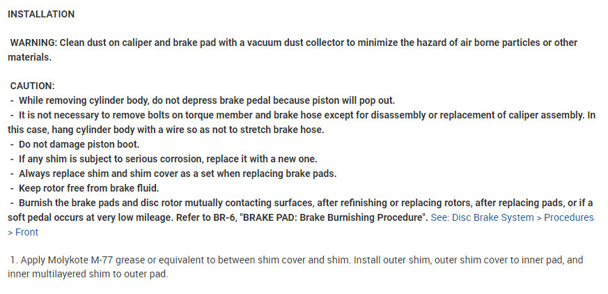

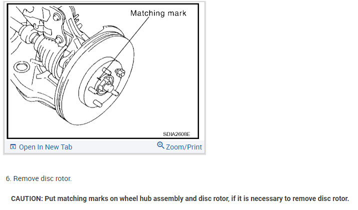

I just purchased this car and when test-driving (before purchasing) did not hear a pop noise underneath the car. After a week, I started hearing a noise and felt through the brake pedal. I took it in to the Service and technician said it was front brakes
Please kindly respond.
Tuesday, November 13th, 2007 AT 12:33 PM
DANNY L
  • 5,648 POSTS
Hello, I'm Danny.

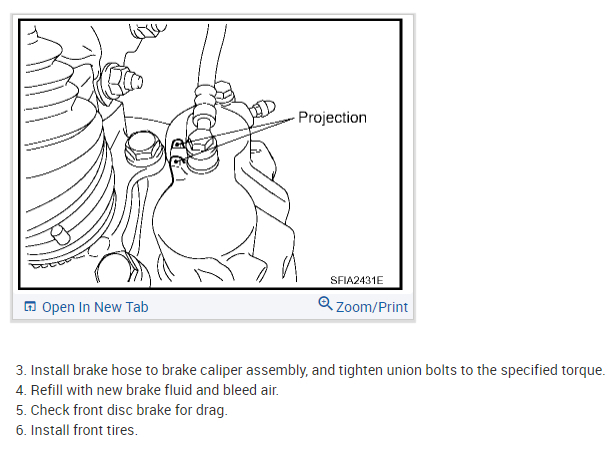

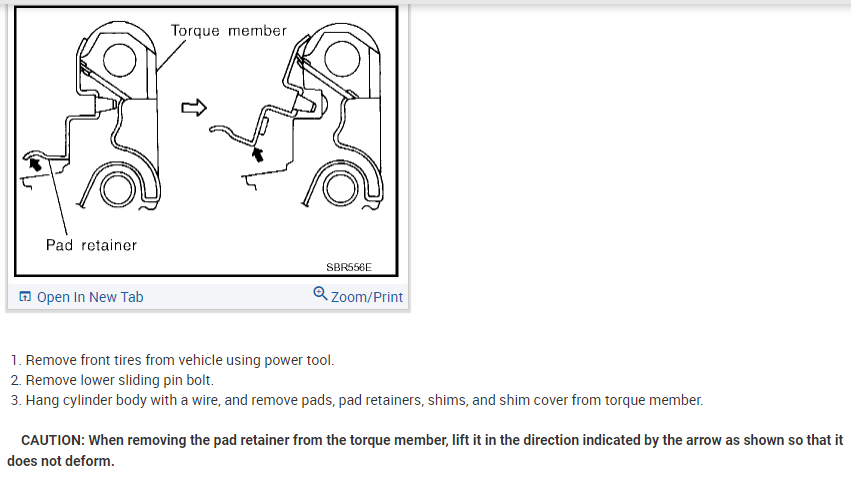

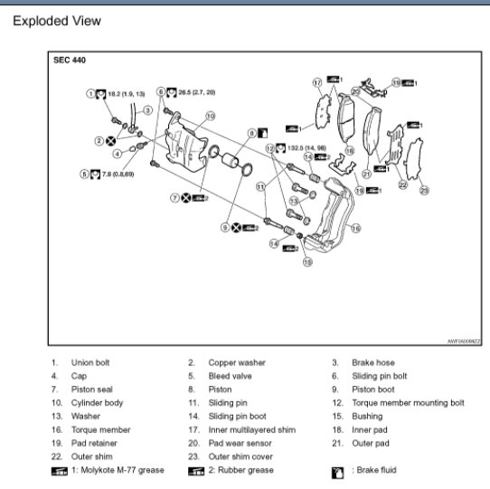

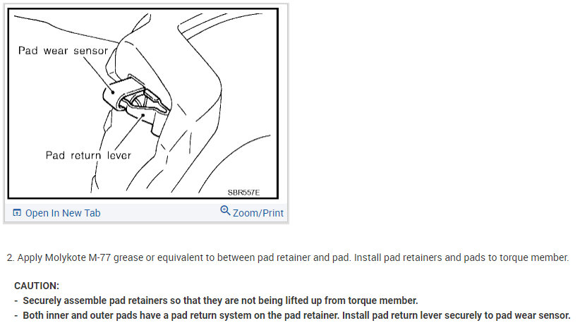

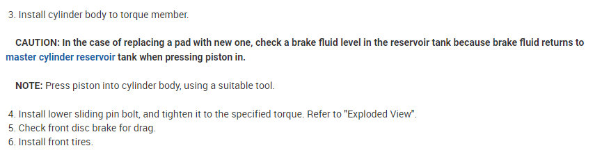

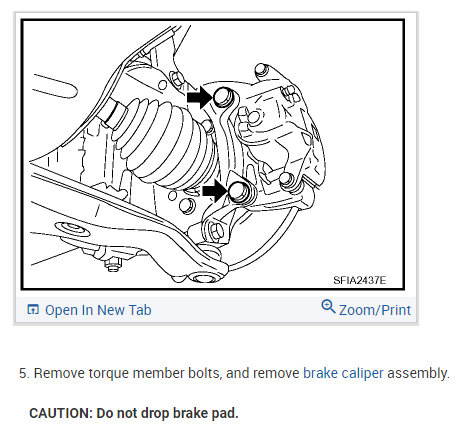

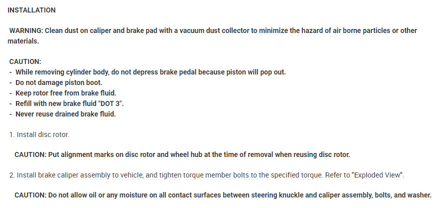

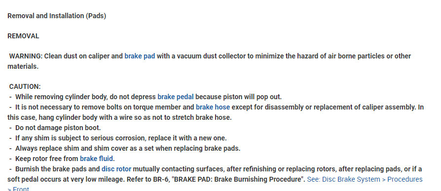

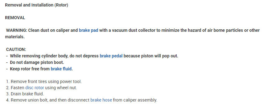

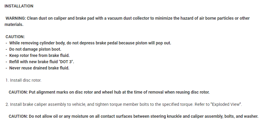

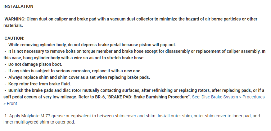

Here is the information you requested. This is a tutorial showing what is involved on how to change front brake pads and brake rotors:
I've attached picture steps below on how to change the front brake pads and rotors on your car. Hope this helps and thanks for using 2CarPros.
