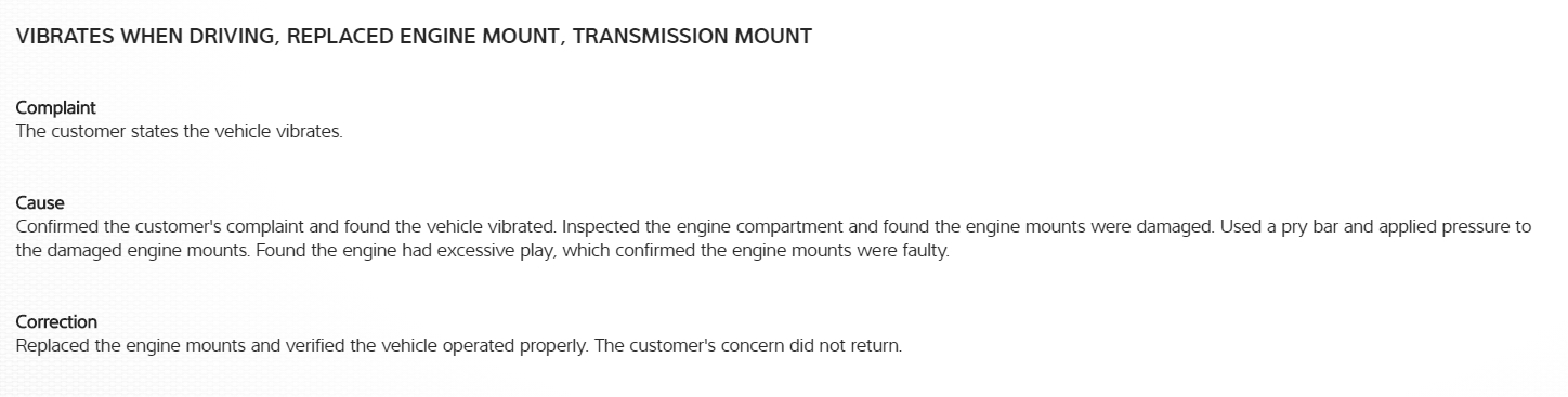

Have you inspected your motor and transmission mounts? down below I've included a probable diagnosis for your issue and the fix. Let me know what you find out.

The vibration isn’t going to be noticeable in a video. I wish otherwise. It’s not a violent shake or the like. It’s simply a what seems like a slight front to rear jerk that’s not consistent, unfortunately. When I’m park, I can rev the RPM's and it doesn’t jerk, only under a load (in gear driving). I honestly don’t think it's an engine mount, though. not rattling or clunking, no noise just the jerking.
