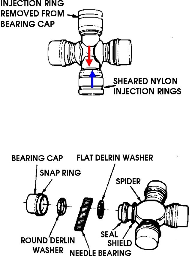

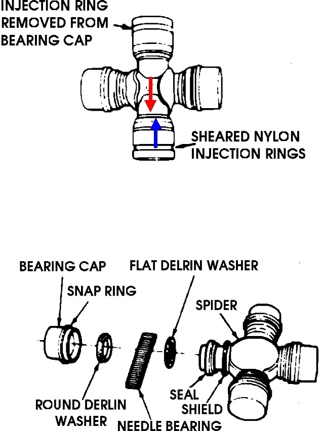

To check the universal joints, shift to neutral, block the tires, or apply the parking brake if the cables aren't rusted tight yet, then crawl underneath and try to rotate the drive shafts back and forth. You're looking for movement between the bearing cups and the cross, as shown by the red and blue arrows in this drawing. Also look in that area for reddish-brown stains from rust. That's an indication the grease has been gone for some time and the needle bearings have disintegrated. Often the cup will also be cracked into multiple pieces.
