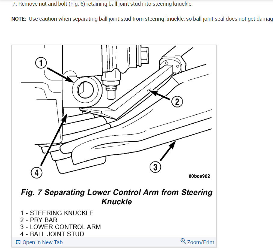

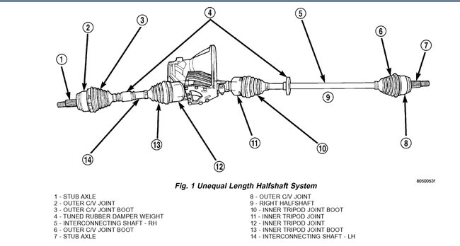

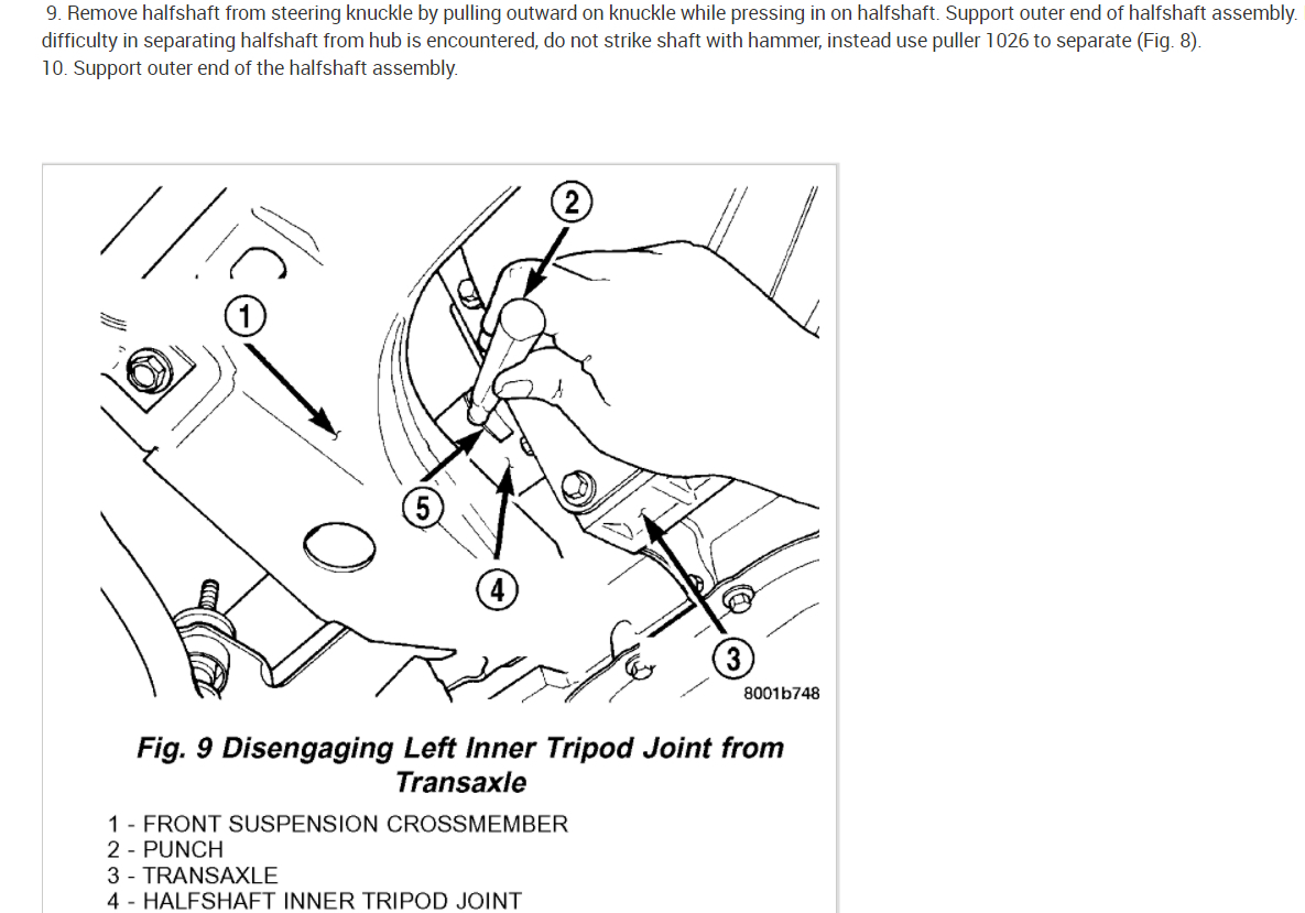

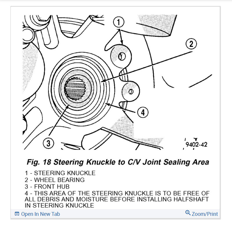

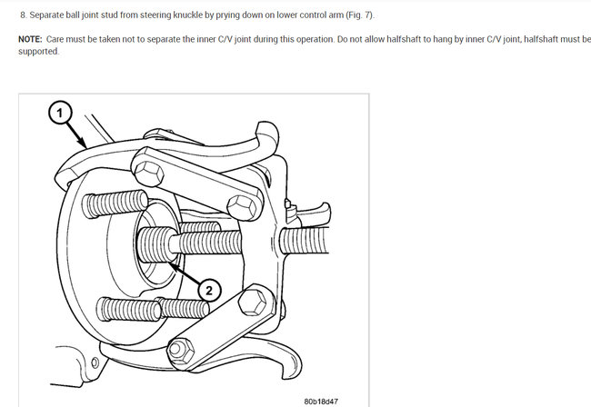

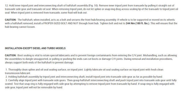

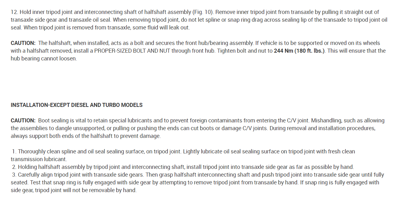

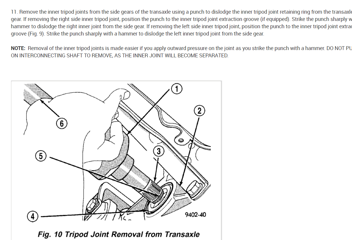

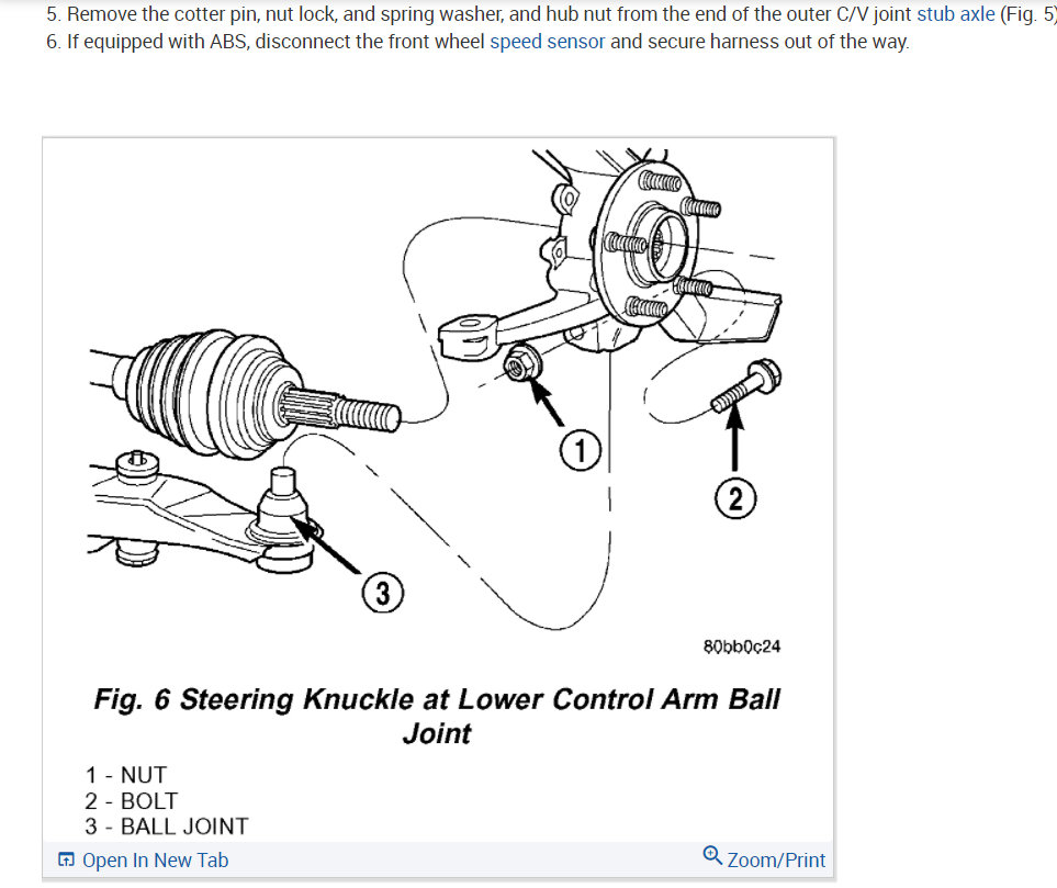

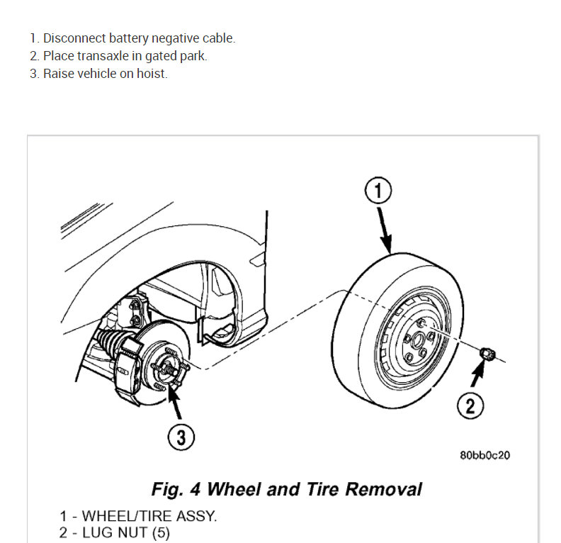

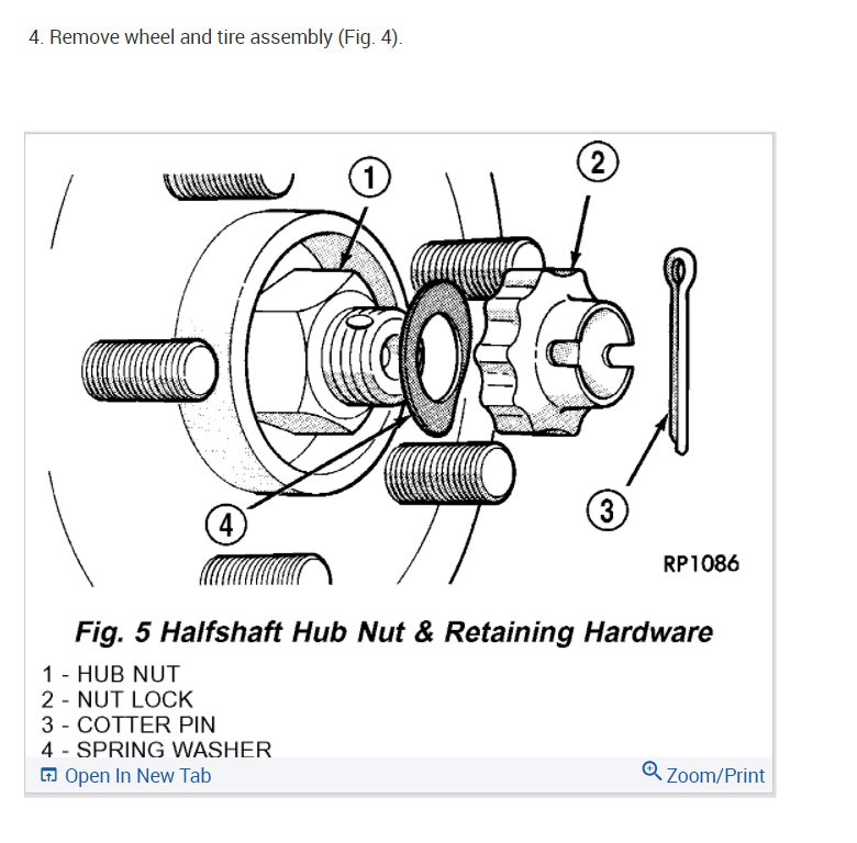

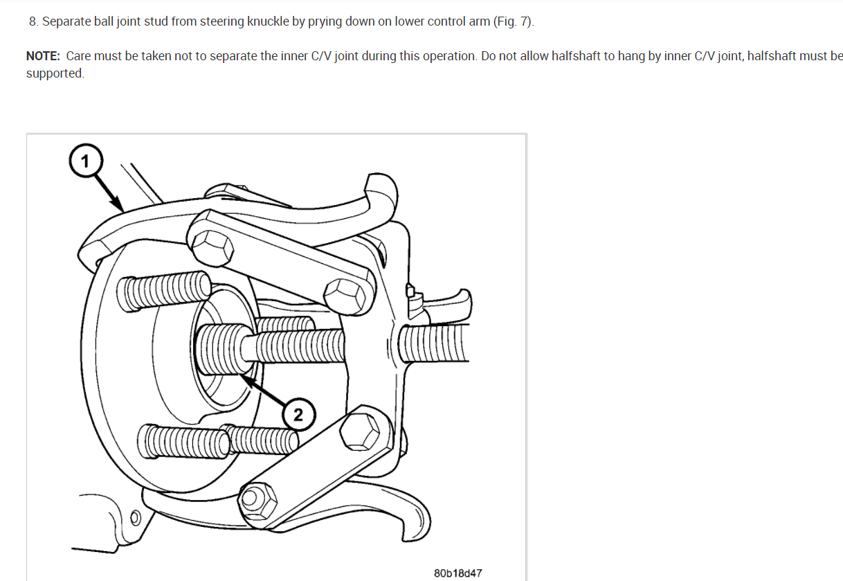

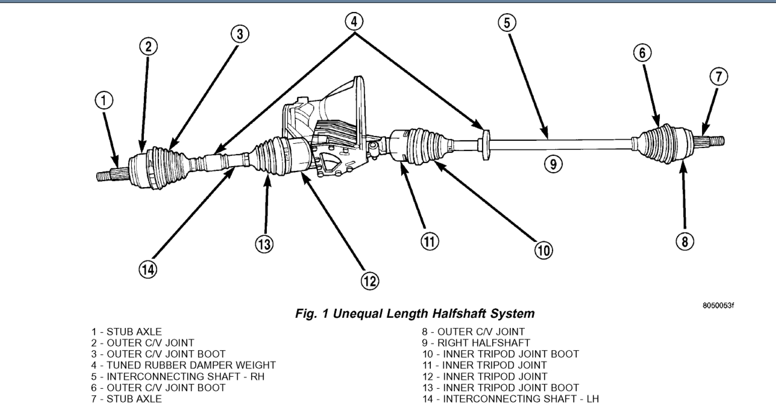

Good afternoon,
This sounds like a CV joint in one of the axles is failing. When there is pay in the joint, it will give a vibration on acceleration.
I attached the procedure for replacing the axle shafts below along with some guides.
https://www.2carpros.com/articles/how-a-cv-joint-works
https://www.2carpros.com/articles/replace-cv-axle
