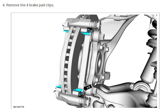

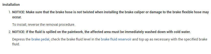

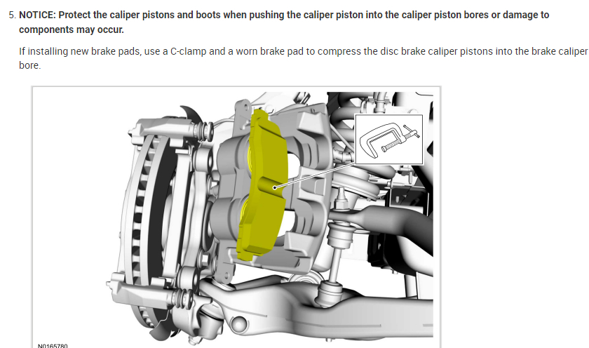

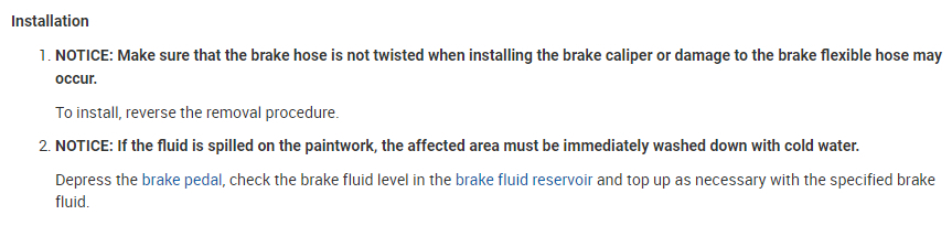

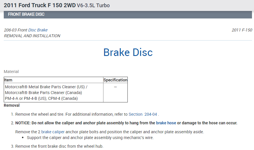

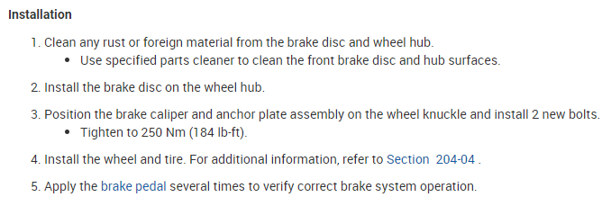

When I am driving, the whole vehicle will vibrate when I brake. I think the rotors are bad can you help?
Mar 1, 2018 at 10:31 PM
DANNY L
  • 5,648 POSTS
Hello, I'm Danny.

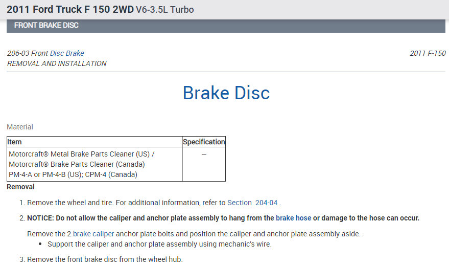

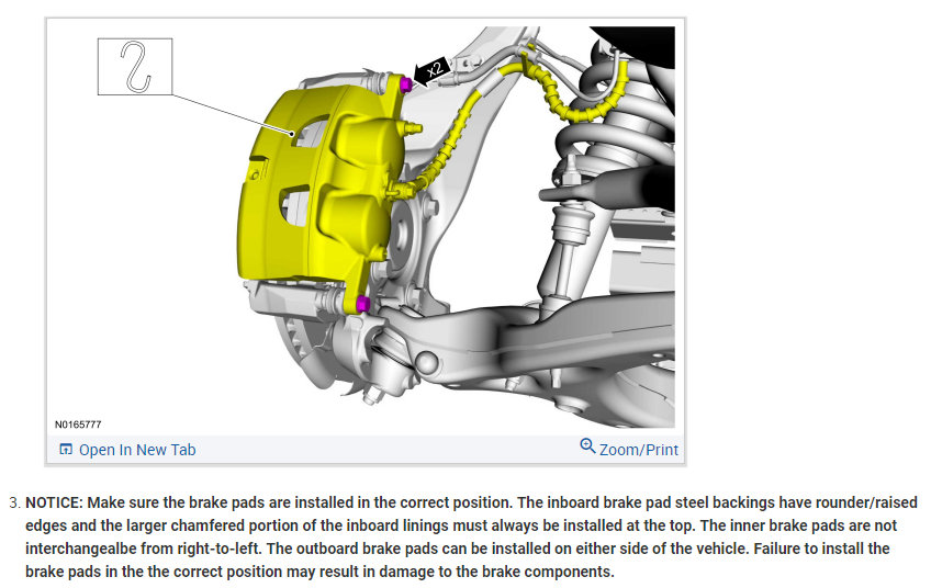

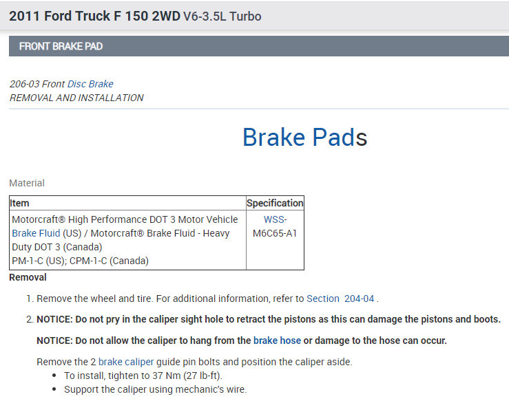

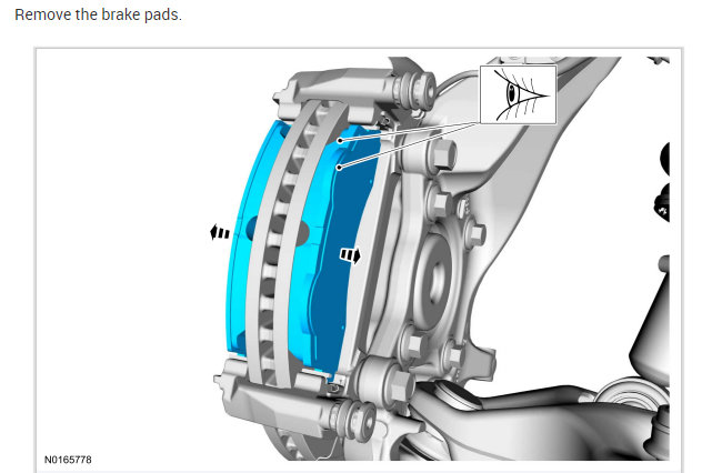

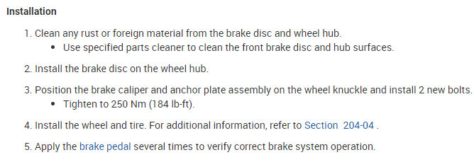

Here is the information you requested. The vibration may be caused by warped rotors from fatigue, wear, or overheating. This is a tutorial showing what is involved on how to change front brake pads and brake rotors:
I've attached picture steps below on how to change the front brake pads and rotors on your truck. Hope this helps and thanks for using 2CarPros.
