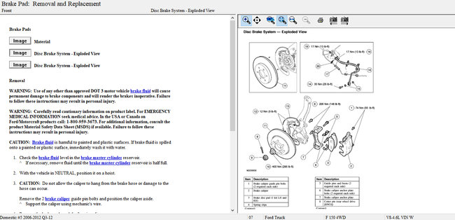

How do you change our brake pads and what kind should I use?

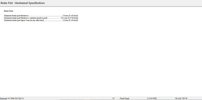

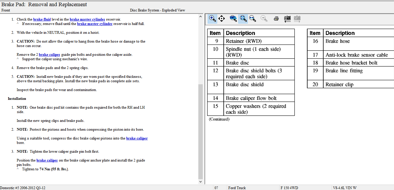

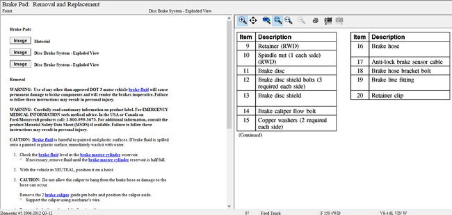

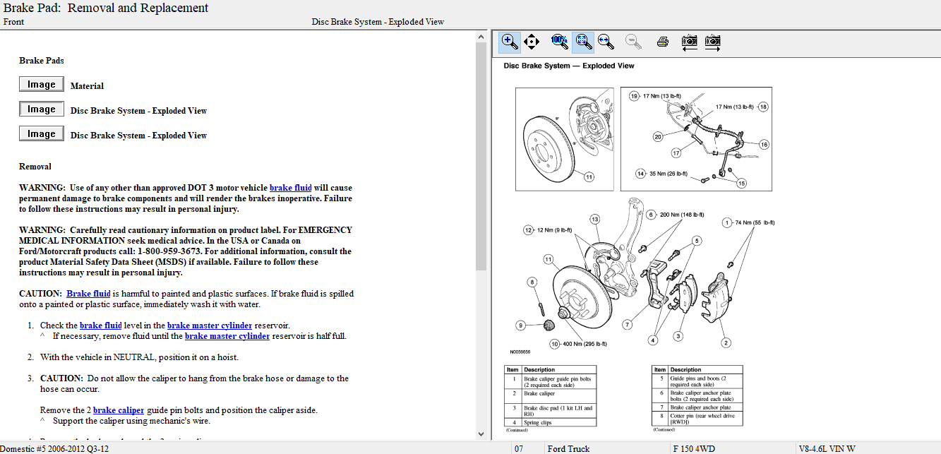

hello,

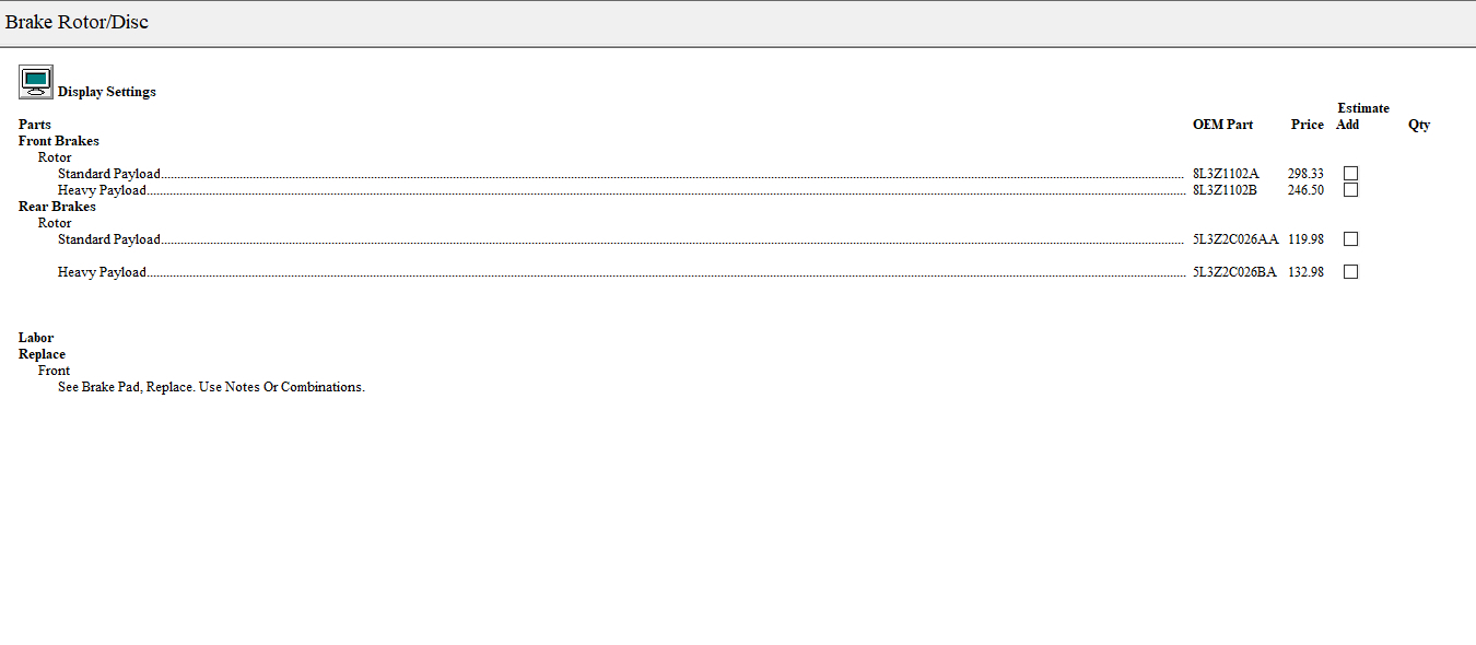

the best quality brake pads are the original ones, part number for front rotors are 8L3Z1102A $298.33, for heavy payload rotors 8L3Z1102B 246. $5.00.
part number for front pads are 6L3z2001A $83.30.
check our guide below how to replace brake pads specific to your vehicle.
https://youtu.be/sUCflrTy-d4

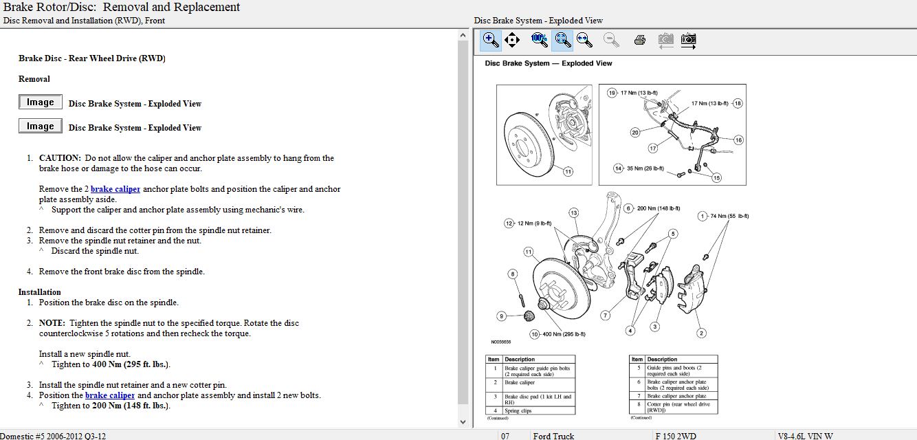

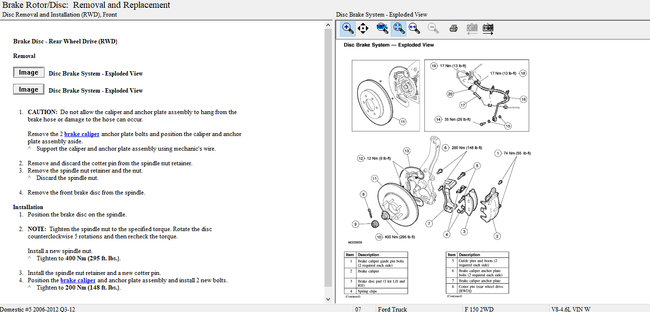

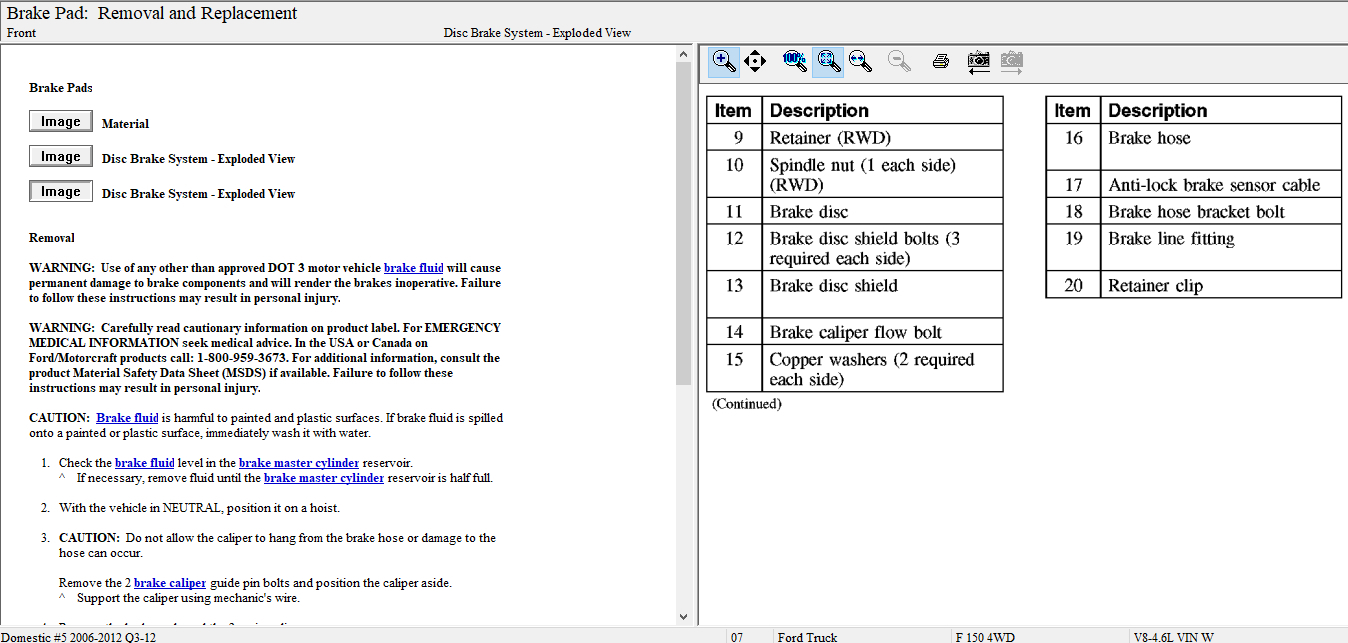

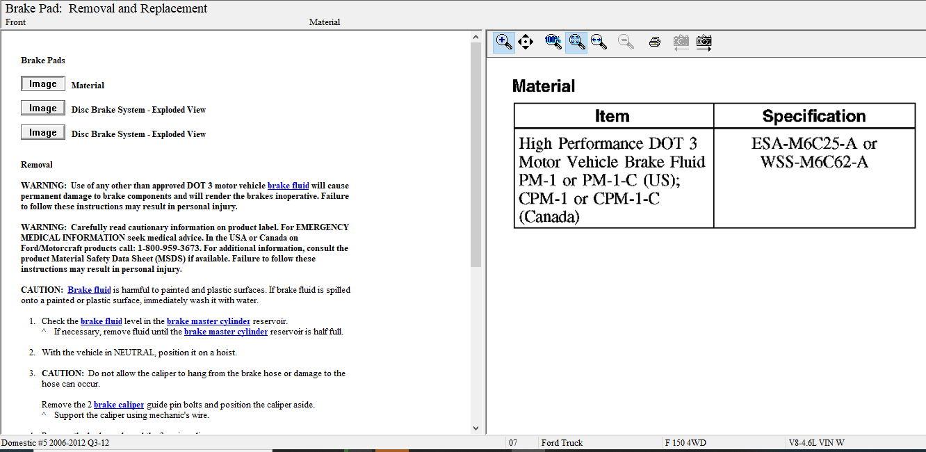

Check our diagrams below how to replace front pads and rotors procedure, also specified permissible measurement values.
hope these helps.
