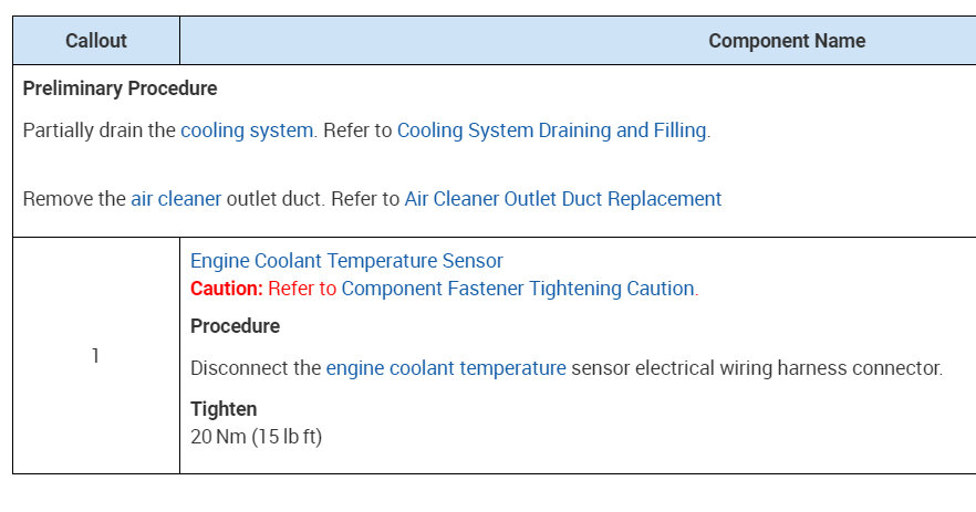

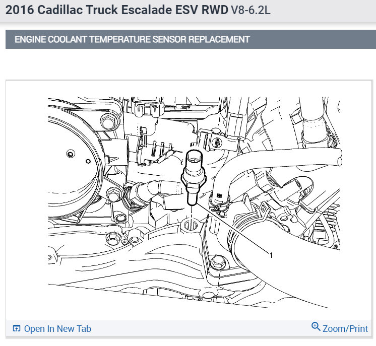

Yes, it sounds like the engine coolant temperature sensor needs to be replaced, here is the location so you can swap it out. Check out the images (below). Please let us know how it goes.

The coolant sensor feeds the PCM and the gauges via the PCM.
