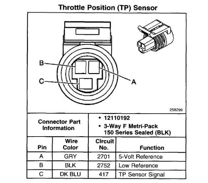

I check the TPS connector with the connector unplugged with a DMM and got to read about 1.6V on the signal leg (dark blue B con. #66)
I thought I should be reading close to 0 volts.
5 volts is present on the reference leg (grey wire B con. #33)
No volts at ground leg.

The signal wire at the TPS should read .5 to .75 volts at closed throttle.
If it is out of adjustment, it will not cause the high idle.
https://www.2carpros.com/articles/engine-idles-too-high
I am concerned the throttle body plate is not seating in the bore allowing too much air in to the engine.
I would start by cleaning the throttle body itself and retest.
https://www.2carpros.com/articles/how-a-throttle-body-works
I attached the connector diagram for the TPS. Check or back probe the low reference wire with the key on and closed throttle.

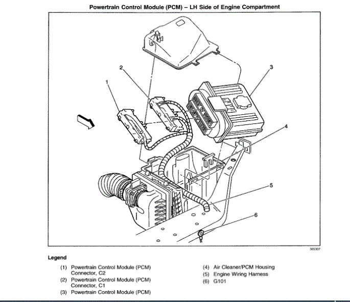

Okay, the ECM does control the operation of the idle air control. From your statement it is working correctly
When hot it sounds like the throttle plate is opening whether from the throttle body itself or the ECM is commanding it open.
There is no cable. It is all electronic controlled now.
I suspect the ECM is the issue

You would need a scan tool to see the movement of the IAC.
No to the EGR. It would code.
I still think we are heading to an ECM.

is there a way to check the ECM without a scanner?
I don't have a scanner at this moment.
I'm looking at Autoenginuity. The scan tool is about $250.00 with domestic package about $800.00 and with Domestic, Asian and European packages it is about $1,500.00. I was looking at the parameters that this tool, with the Enhanced package for GM, it shows over 100 parameters. Do you have any comments on the Autoenginuity scanner?
Sep 26, 2020 at 2:50 AM
That is a good scanner and will give you the information you need.
The ECM needs to be checked by someone with the special equipment needed.
