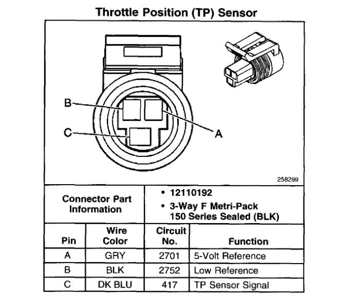

I check the TPS connector with the connector unplugged with a DMM and got to read about 1.6V on the signal leg (dark blue B con. #66)
I thought I should be reading close to 0 volts.
5 volts is present on the reference leg (grey wire B con. #33)
No volts at ground leg.
Voltage presence on signal leg.

The signal wire at the TPS should read .5 to .75 volts at closed throttle.
If it is out of adjustment, it will not cause the high idle.

I attached the connector diagram for the TPS. Check or back probe the low reference wire with the key on and closed throttle.

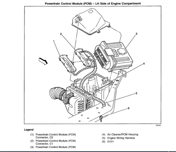

Okay, the ECM does control the operation of the idle air control. From your statement it is working correctly
When hot it sounds like the throttle plate is opening whether from the throttle body itself or the ECM is commanding it open.
There is no cable. It is all electronic controlled now.
I suspect the ECM is the issue

The ECM needs to be checked by someone with the special equipment needed.
