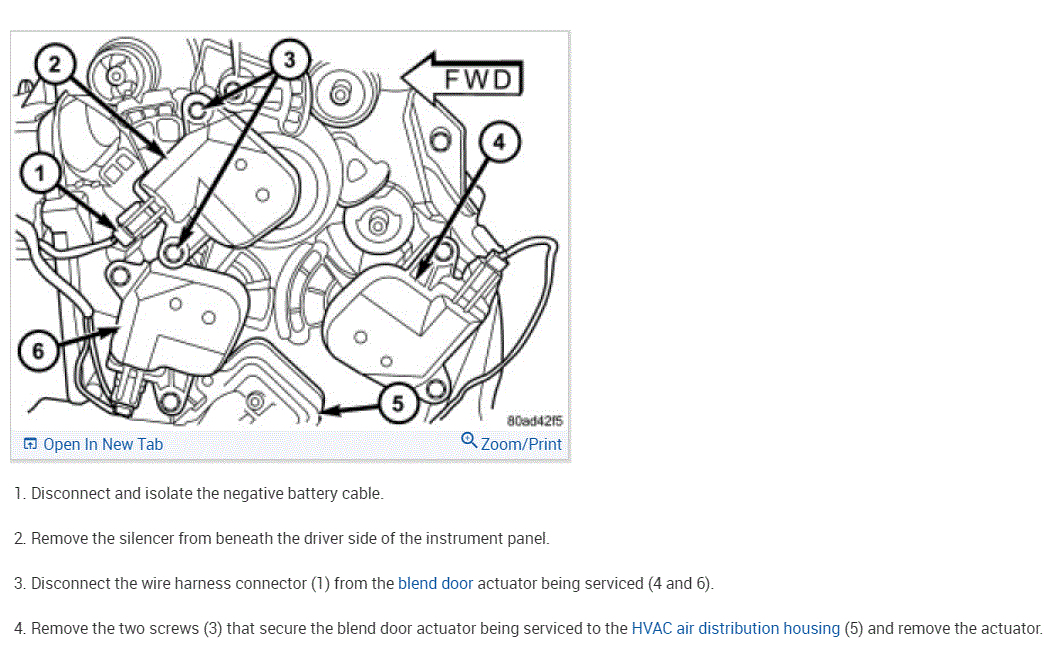

This sounds like an issue with the blend air door actuator. This actuator is responsible for moving a door in different directions to change air temperature entering the vehicle.
Since you just worked on the vehicle, make sure it is connected. If it is, remove the actuator and see if it reacts to your request to change from hot to cold and opposite.
Here is a link that explains how in general one is replaced:

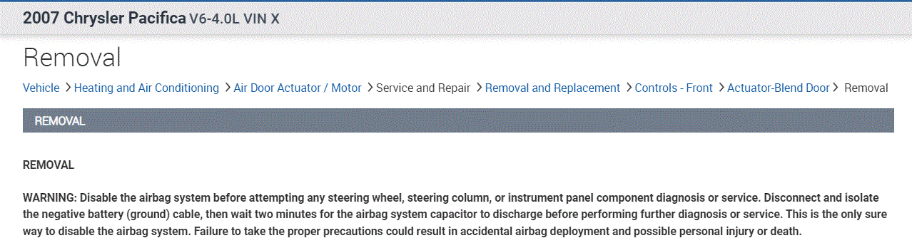

If you look at the attachments below, they provide the directions specific to your vehicle.
Before purchasing a new actuator, remove the old one and leave it connected to power, see if it reacts.
