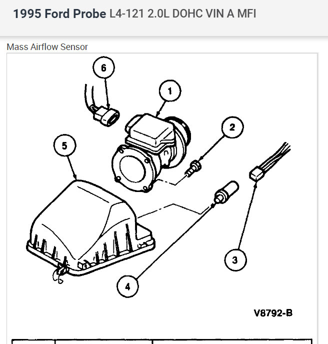

It sounds like to me it could be a bad MAF sensor. I would try swapping it out because if the sensor starts to go bad it will not leave a code.
Here is a guide that can help as well:
https://www.2carpros.com/articles/engine-has-low-power-output

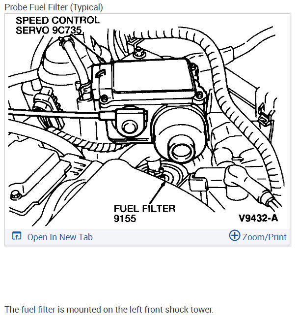

here is the location of the MAF sensor. Also, change out the fuel filter as well. Check out the images (below). Please let us know what happens.
