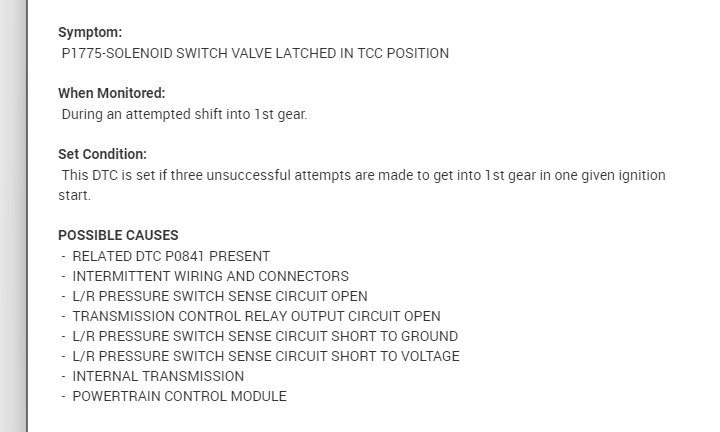

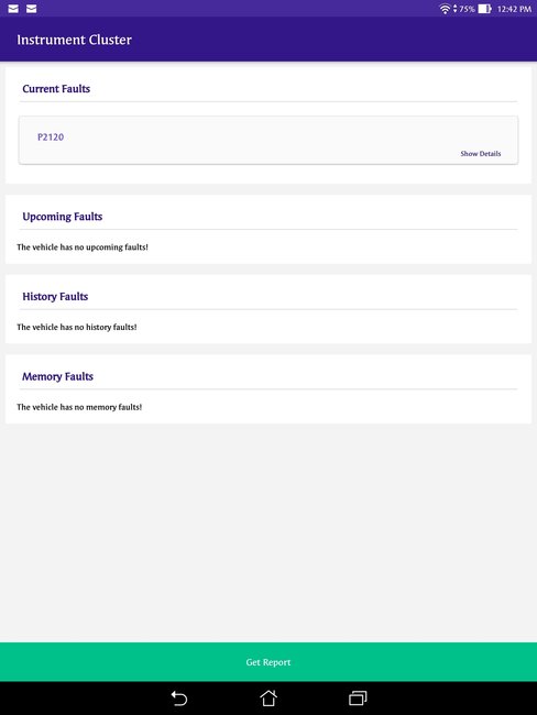

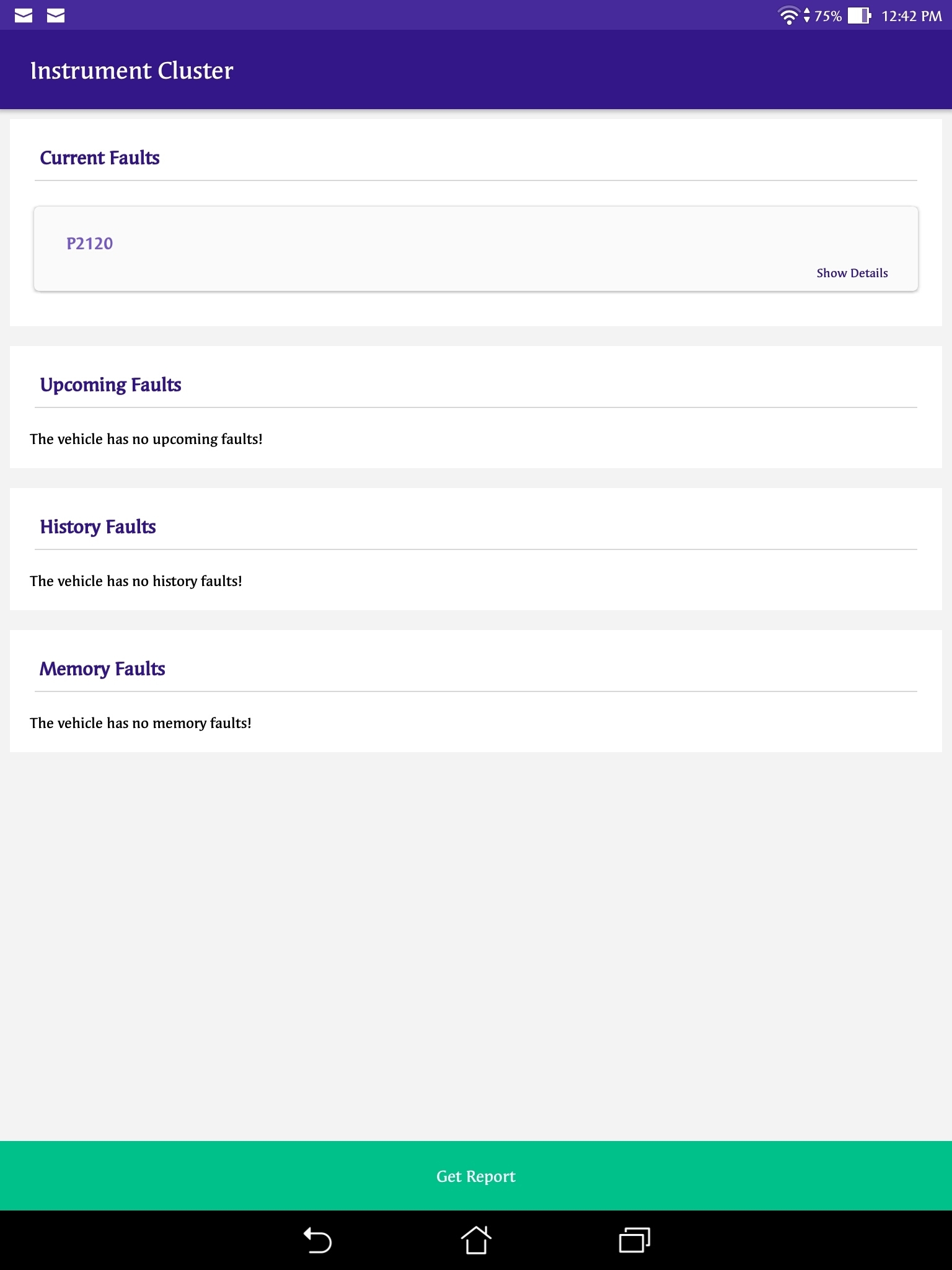

This vehicle does not raise above 3,200RPMs at wide open throttle. when i diagnosed the instrument cluster and transmission using garage pro app and obdlink scanner, it recorded code p2120 only without description and on transmission it recorded p1775.
I used Autel scanner Maxispro to diagnose it again and it recorded description without fault code: "improper power down detected".
And while accelerating the vehicle, if you throttle on second gear to move faster and shift into third gear, it will begin to drag and will not shift until you release pedal and depress it slightly before it shifts upward gear
At this point i don't know how to analyze and solve the problem.

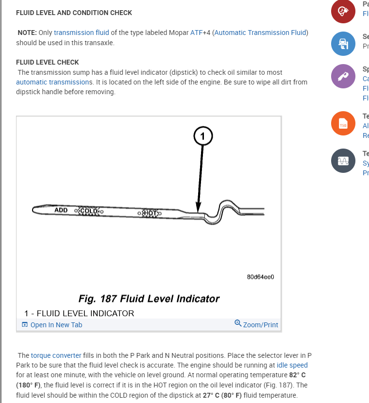

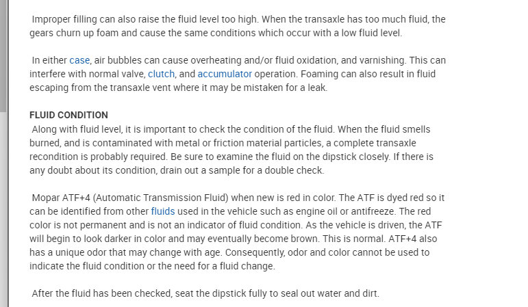

This sounds like a fluid issue in the transmission or possibly a greater issue due to the fluid being low.
So, the first thing to do is check the fluid level and see what the condition is.
https://www.2carpros.com/articles/how-to-check-and-add-transmission-fluid
What I suspect is happening is the fluid is low or in poor condition and it has caused damage to the torque converter and possibly more inside the unit.
If this is the case, we may need to drop the pan and inspect for metal inside the unit.
I attached the material below on these codes and how to check the fluid.
Let us know what you find, and we can go from there.
Thanks

All checks okay. Again, if the vehicle is on 1st gear and you throttle-down to shift to 2nd at wide open throttle, it will begin to drag until you release the throttle pedal and depress slightly it will shift to 2nd gear. This problem is not between the throttle body, instrument cluster and valve body since it recorded fault code:P2120 on instrument cluster?

Did you go through the testing for the P1775? I understand if the fluid checks out okay, but this still sounds like this is where the issue is.
It may not be the fluid itself but that is going to give us indicators as to what the issue is.
Have you dropped the pan to look for metal?
Basically, this code is telling you that the torque converter switch is stuck engaged which means the converter is locked when it should not be.
This is going to cause the engine to bog way down and not shift. Then when you get off the throttle and back on slightly it allows the TCC to release and it shifts.
I am pretty confident that you have internal transmission issues and if it were me, I would be dropping the pan to see what is in it and then most likely rebuilding the unit.

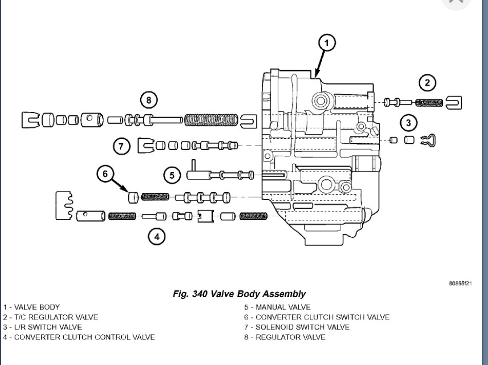

1.Where is the location of the torque converter switch?
2. This is a valve-body problem because if you engage reverse, you will feel hard-shift but if you engage DRIVE, you will not feel anything but smooth engagement.
I have removed the pan but didn't see anything
Jan 10, 2022 at 5:12 AM
Okay. This does sound like a converter issue, so the TCC switch is part of the valve body. If the fluid is in good condition and you have no metal in the pan, then you should be fine replacing or just rebuilding the valve body.
They are pretty easy on this vehicle using the exploded view below.

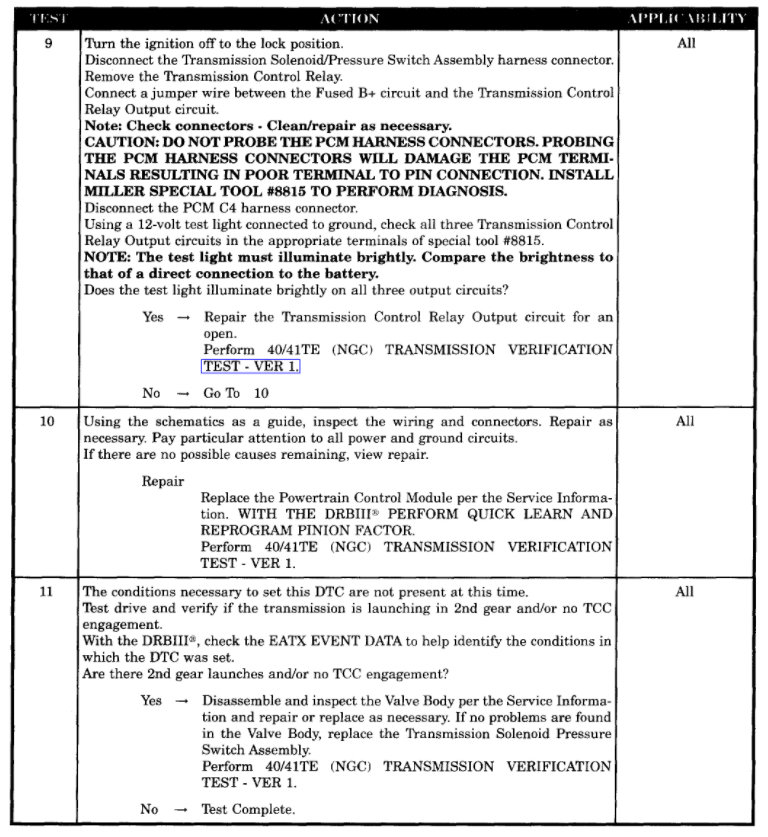

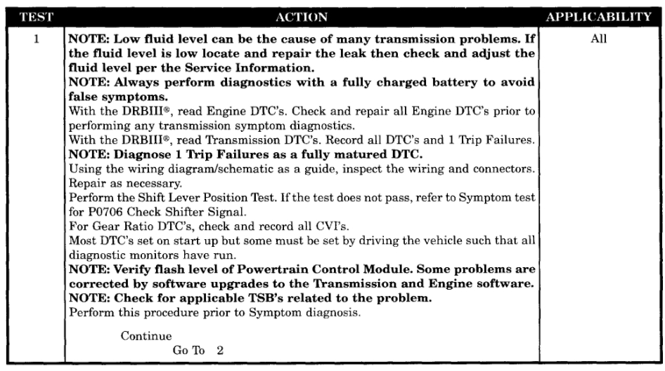

The pump on these vehicles is noisy so get a recording of the pump. It could be a pump issue but if you are getting P1775, then we need to go through that testing because we are just guessing at it otherwise.
I attached the testing above so let's start with a recording of the pump and then run through that testing.
