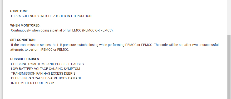

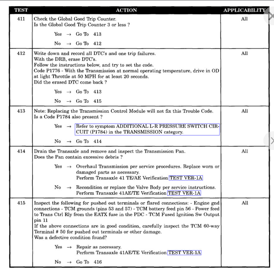

I am adding some info on this code as it is most likely metal or clutch material getting in a solenoid or a damaged valve body. More than likely they are going to have to replace or rebuild the unit to fix this.

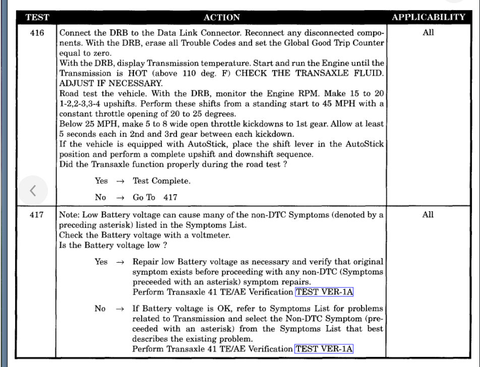

Suggested Repair
Confirm the current fault code, then plan a 41TE transmission rebuild or replacement. P1776 is typically caused by metal or clutch material in a solenoid or a damaged valve body, so solenoid pack or valve body replacement alone may not fix it.
