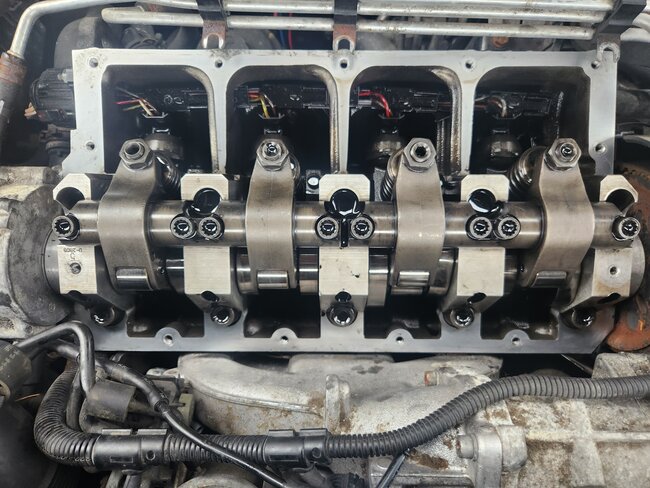

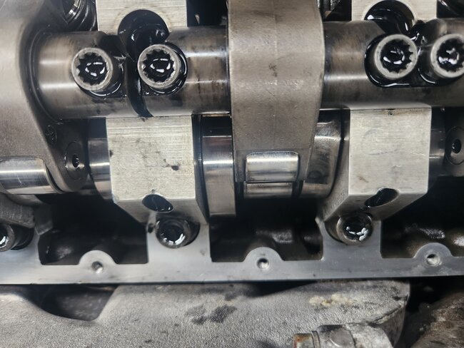

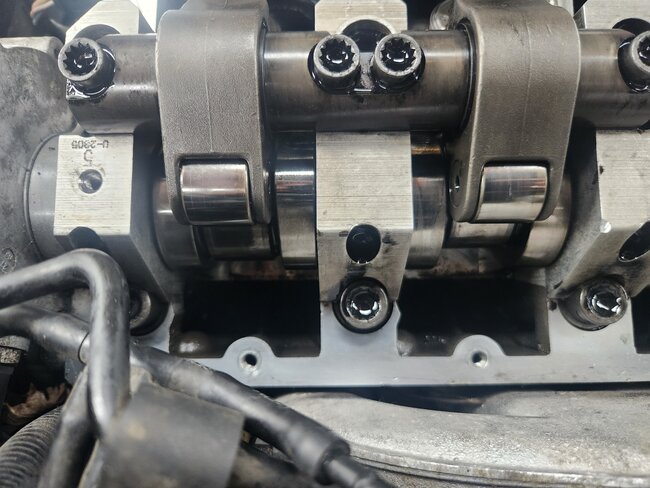

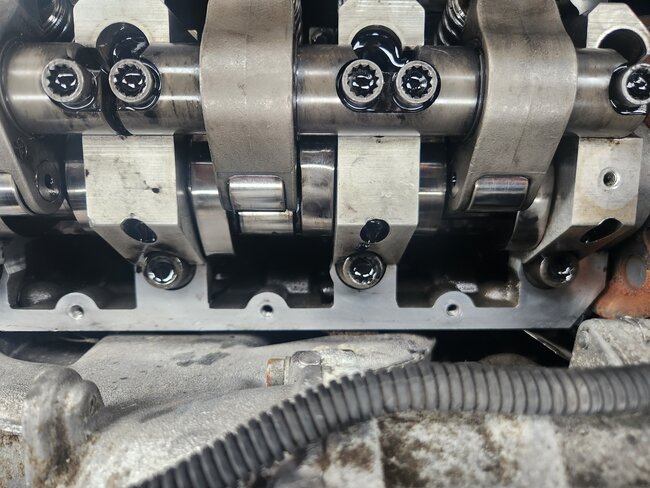

Upon rapid acceleration the vehicle blows black smoke until the throttle is let off. Initially the RPMs jump about 1000 so I'm assuming the turbo is working. I checked the vacuum at the pump, and it was about 30 inHg and at the turbo actuator where it was 24 inHg. I had an experienced VW mechanic listen to it and he thought it sounded like a misfire. Possibly a bad injector. I don't have a VAG-COM to aid in diagnosis. I removed the valve cover to inspect the cam and lifters and have included pictures of their condition. I was unable to remove the timing belt cover so I could rotate the cam to fully inspect the lobes and lifters but there does appear to be some wear and ridging on at least one lobe. I will inspect them more fully when I get the cover off. Then I can also adjust the clearance on the injectors. How do I know if each injector is working? It's not like I can check for a pulse since they are inside the valve cover. I'm new to this type of engine and any advice would be appreciated. The car is drivable, it just doesn't have the power it should.

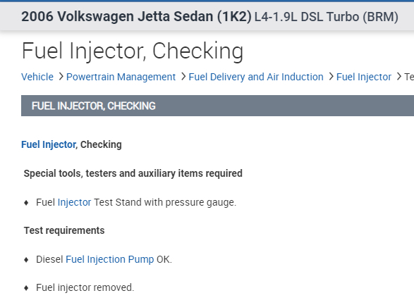

Black smoke is an indicator of a rich fuel mixture. It can be caused by a few things such as a faulty coolant temp sensor or a faulty fuel pressure regulator. Also, a bad injector can cause it. Make sure there is nothing restricting the airflow to the engine.

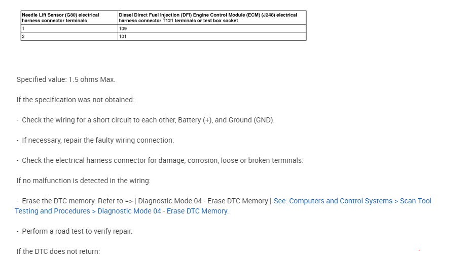

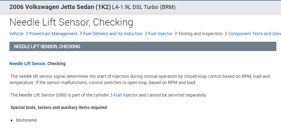

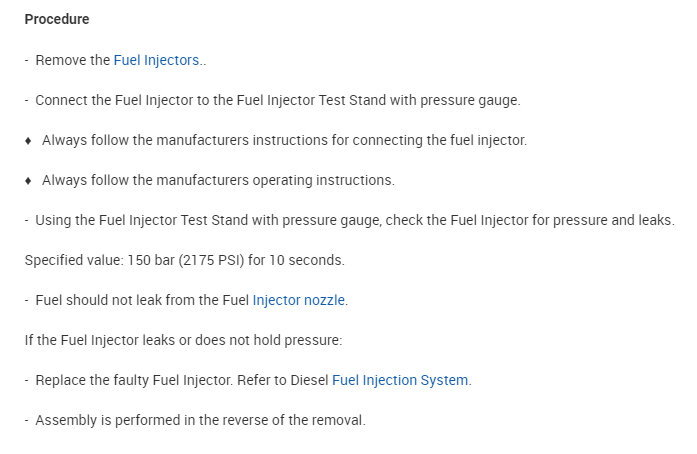

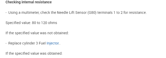

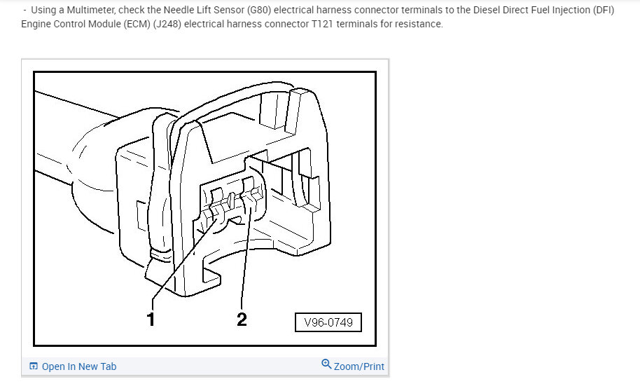

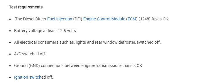

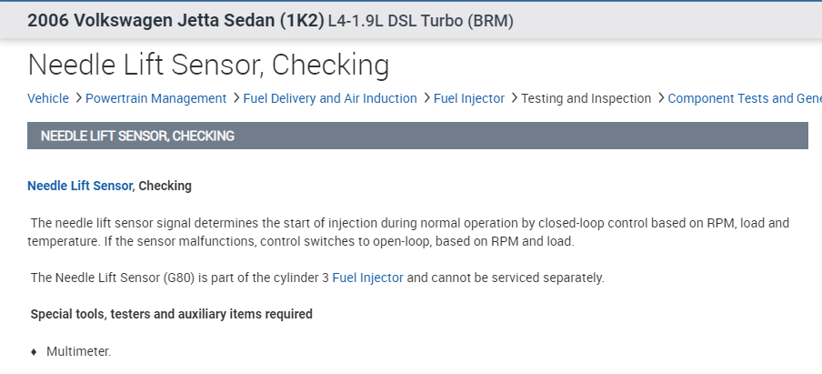

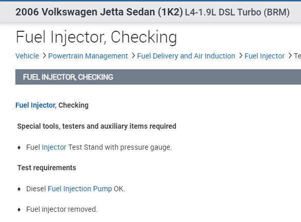

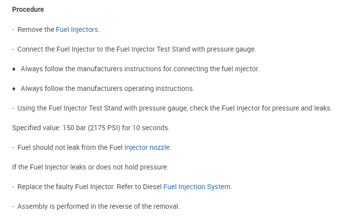

To test the injectors requires their removal and a test stand/pressure gauge. I attached the directions below. (Pics 1 and 2)

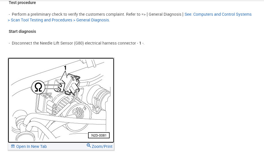

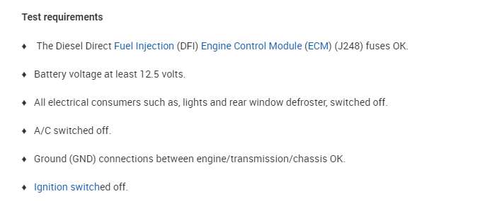

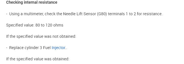

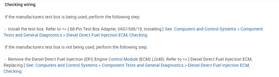

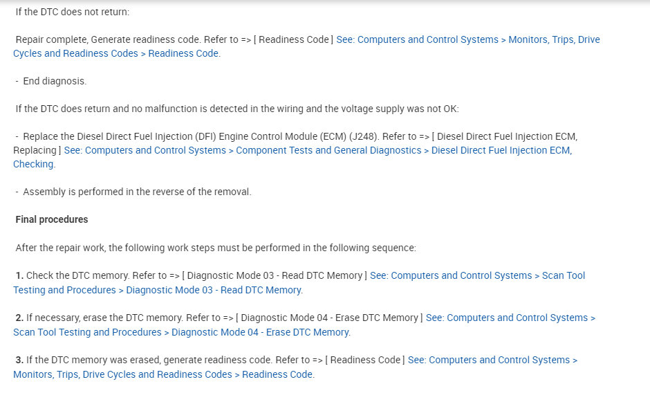

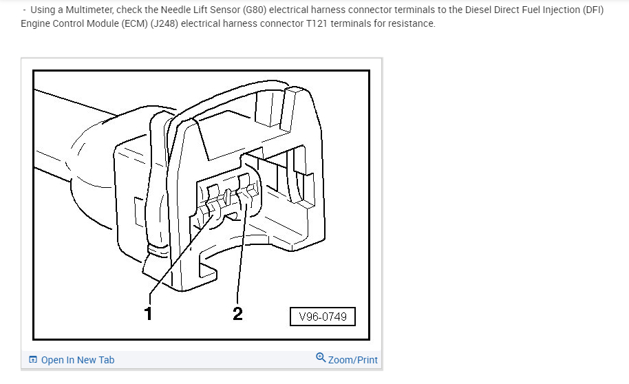

Also, consider checking the needle lift sensor integral on injector 3. The remaining pics below are the diagnostics for that as well.
Let me know if this helps.

From the pics, the cam lobes look fine. It's really hard to tell in a picture. I hope you understand. Which pic are you seeing a disconnected temperature sensor?

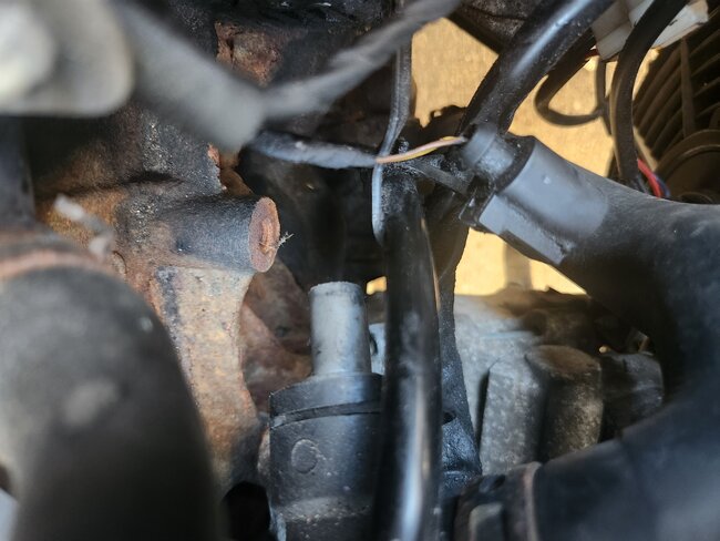

I thought they looked okay also but the camshaft/valvetrain is making a lot of noise and the engine is lacking power and misfiring. I plugged the sensor back in and it actually ran worse. I'll include a picture of the sensor which now I can't get the connector back off.
