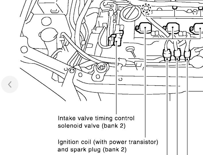

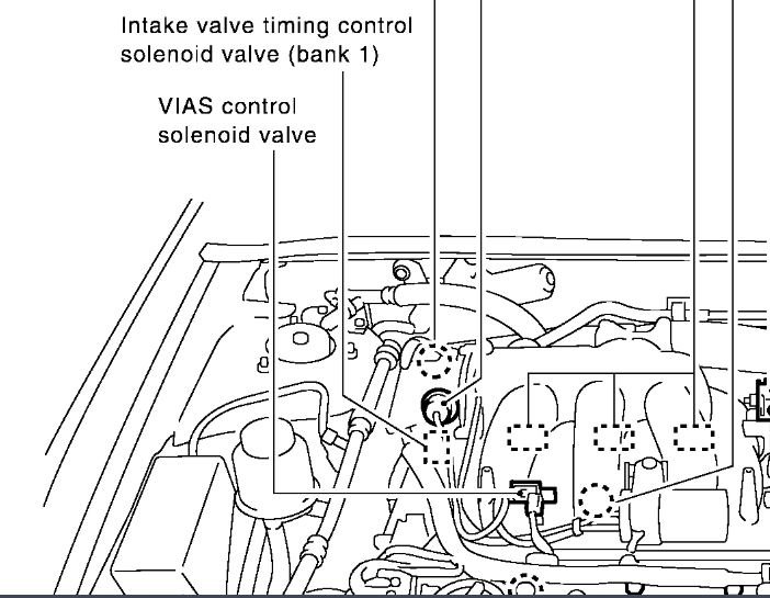

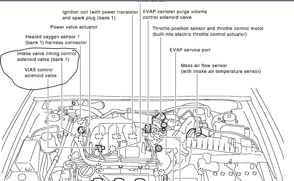

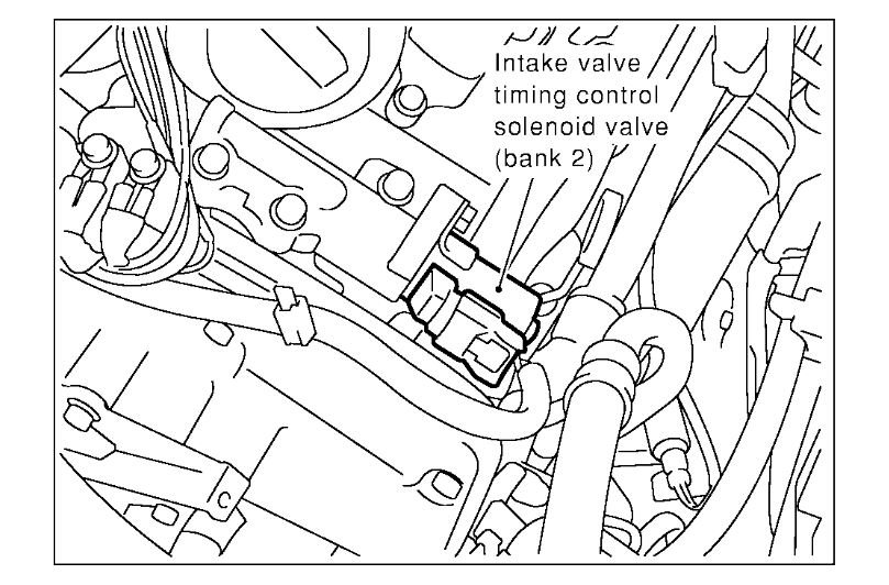

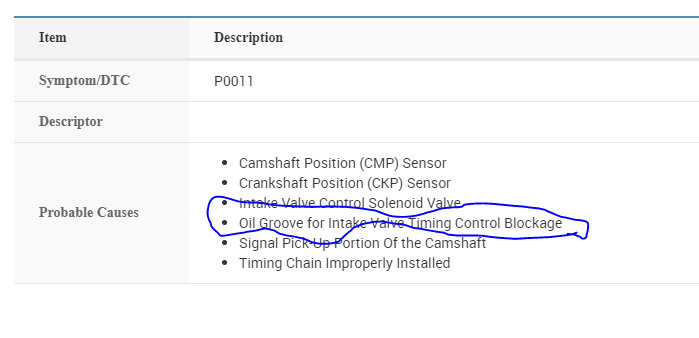

I have narrowed my issue down to a dirty or bad Variable Valve Timing Solenoid in bank 1.
I just need to know where it sits and how to access it!
Nov 26, 2019 at 9:52 AM

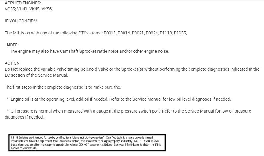

Good afternoon,
What code is set that makes you think you need this part?
I attached the location and also a TSB on the issue as well.
What is the code that is set?

And Roy, thanks for your reply and the diagram.
I suspect it's for an Infiniti I35 (2004) correct?
Is the Variable Valve Timing Solenoid hard to get to?

I need the code that was set that makes you think it is the VVT.
Nov 26, 2019 at 9:14 PM
KARAGHI
  • 6 POSTS
Sorry, I thought I put that in my reply!

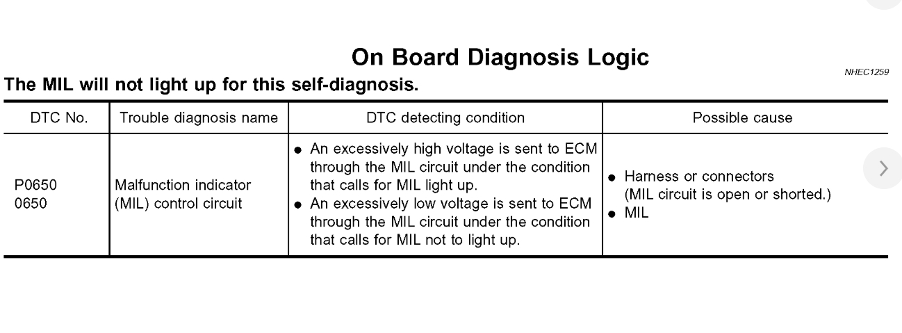

Code is P0011 and P0650.
Nov 27, 2019 at 7:37 AM
Okay, the 650 is for the check engine light. Does the light come on when you turn the key to the on position?
The 11 is for the timing. It points right at the oil passage as I suggested.

So how I would get to that solenoid?
Dec 1, 2019 at 12:02 PM
The first thing I would do is to have the oil system acid flushed to get rid of ll the dirt and debris in the passages. If you replace the solenoid now, it will get contaminated and fail as well.
You need a shop that can do this procedure. It is not an oil change with an additive. It is removing the oil and filter and pressurizing the hot fluid through all the oil passages in the engine to get rid of the debris.
Then you can change the solenoid.
