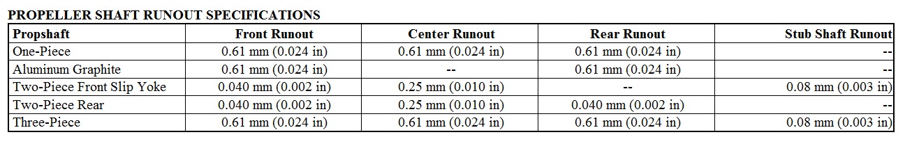

If it doesn't do it in 4wd auto or when front driveshaft is removed then i'd suspect it has to be in tcase which I know you don't want to hear or maybe the driveshaft. Have the runout of the driveshaft checked as well as the pinion in the tcase. There are 5 different tcases so I hope you know which you have. Any driveshaft shop near you should be able to do this. Also change the fluid in front axle if it already hasn't been done the pic i'm sending shows runouts for various driveshafts so a driveshaft shop will know as this can cause a vibrataion as well.

Try to do the checks I've suggested as runout can cause all kinds of vibration noises. Etc.
