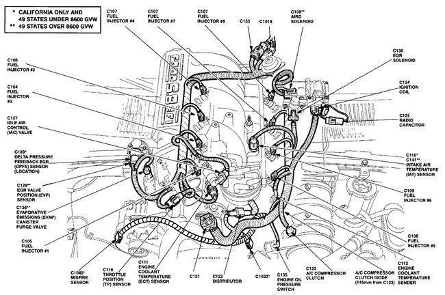

This sounds like you have an engine coolant temperature sensor that is not working right. When this sensor goes out it may not trigger a check engine light. Here is a guide to help you see what you are in for when doing the job with a diagram below to show you the location:
https://www.2carpros.com/articles/coolant-temperature-sensor-cts-replacement

I switched out the engine coolant temperature sensor and that took care of the problem. MAF, vacuum and fuel delivery was not the problem at all.
