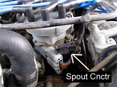

So when you set the timing you did disconnect the spout connector next to the distributor? Here is a pic to see what it looks like. You unplug with engine off and then start it and check timing when done turn engine off and plug it back in.

Yes, that's the way it was done.
