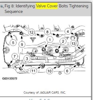

Looking for torque specs on valve cover gasket replacement and manifold gasket replacement could you help me please? Thank you. Kenny
Jul 22, 2018 at 6:00 AM
  • 110,244 POSTS

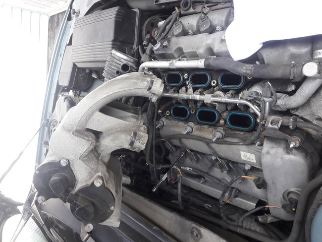

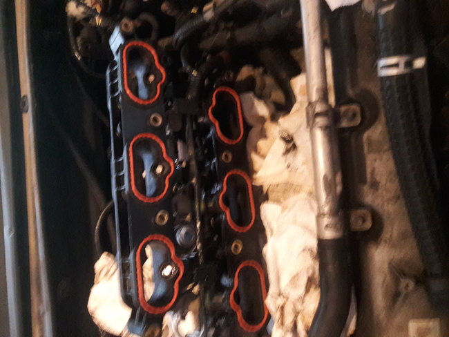

The valve covers should be torques to 10 Nm or 89 inch pounds. I have attached a picture of the torque sequence.

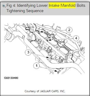

The lower intake is the same 10 Nm or 89 inch pounds. I have attached the torque sequence for this also.

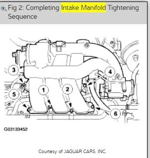

For the upper intake, the torque is the same, 10 Nm or 89 inch pounds. Picture 3 is of the torque sequence.

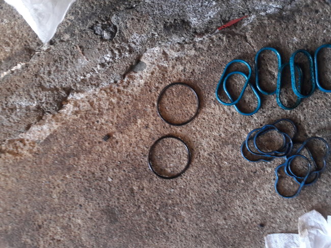

Hey Joe thank you the o-rings are the two on the air intake manifold. See in picture 2 black round on left side.

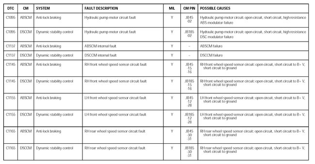

Hey Joe, I am back again. I have a code p1000 in my car not sure what that code means. Question since I replaced everything how many miles is a drive cycle for my car? Thanks Kenny
Jul 24, 2018 at 9:12 PM
  • 110,244 POSTS
Hi Kenny:
I attached the meaning behind that code. I believe it will reset itself once all the drive cycles have completed. This is most likely the result of clearing codes or the battery being disconnected.
OBD SYSTEM READINESS - ENGINE MANAGEMENT
If DTC P1000 is flagged after DTCs have been cleared, all engine management OBD diagnostic monitor drive cycles have not been completed.
If the car is running good, drive it until this resets or all system monitors have reset.
Let me know if you have questions.

Hey Joe hope all is well. I have one more question please. I had a code c1155 which is the front left speed sensor on 2003 Jaguar X Type 2.5 L. I change the sensor the code went out but the ABS brake light is on and I driven one hundred and fifty miles. Code c1155 is out which is great. I have driven one hundred and fifty miles. The ABS brake light is on only code I have is p1000. How do I get the ABS light to go out and the code p1000? Thank you
Jul 27, 2018 at 2:01 AM
STEVE W.
  • 15,345 POSTS
The P1000 code means that not all of the monitor tests like EVAP or Catalyst have run. You would need to use the scan tool to see which one(s) have not run, then complete the drive cycle for it.
On the ABS code, if it is on there is a problem, ABS is a constant monitor system so if you repair the problem the light should go out within a few minutes of drive time.

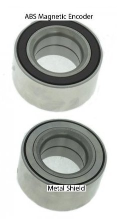

Hi guys, hope all is well. I am still having a problem I have a code C1155 which is the left front wheel speed sensor. I change that. The light went out for about 120 miles then it came back on and stayed on. Then I change the harness nothing happened light still on. I drove two minutes and it came back on and I continue to drive for on 80 miles, light still on. Second problem I hear a whining noise on the right side of the engine when I press on the gas. I am thinking it may have something to do with the AC. Can you help me guys? I surely appreciate it thank you, Kenny
Aug 10, 2018 at 6:13 AM
STEVE W.
  • 15,345 POSTS
The speed sensor issue sounds like a bad magnetic encoder on the wheel bearing itself. They can crack and cause codes. The only good way to see that damage on those style units is to connect an oscilloscope or a very good graphing multi-meter to the sensor at the hub and then rotate the wheel and watch for the signal to change in shape. A common voltmeter is not going to read the break because it is a very small change and only for an instant.

STEVE W.
  • 15,345 POSTS
They are fairly common on that bearing design, they are also somewhat fragile. You need to be as careful as baking a souffle when installing them. Also be careful to install the bearing the correct direction, if you install it with the shield toward the sensor, you get to do it twice. However I would try to test it first. Even a cheap single channel scope will work if you wanted to DIY. A scan tool is somewhat useless as it would not show the break either.

Hey Steve, thank you. It tested out the bearings magnetic so I ordered some I will put them on this weekend. I hope I can get a sticker after this that is the only code I had. But when I first began I had about six codes then I change the coils the plugs the valve cover gaskets the manifold gasket upper and lower clean all the electrical connections change the breather hose which had a big split in the bottom of it change most of the radiator hoses. Then all the codes went away except to C1155. So I should be good. I will keep you informed.
Aug 13, 2018 at 11:07 PM
STEVE W.
  • 15,345 POSTS
Just be careful about the direction and installing the bearing, no hammer use on install, just the correct bearing tools, that encoder ring is real easy to damage.
