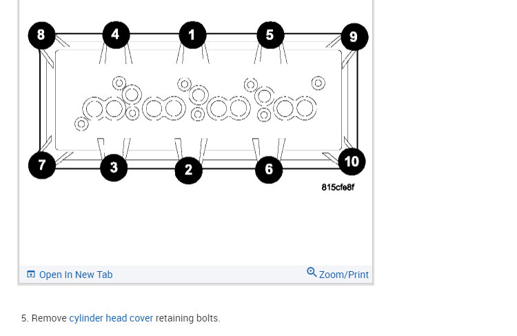

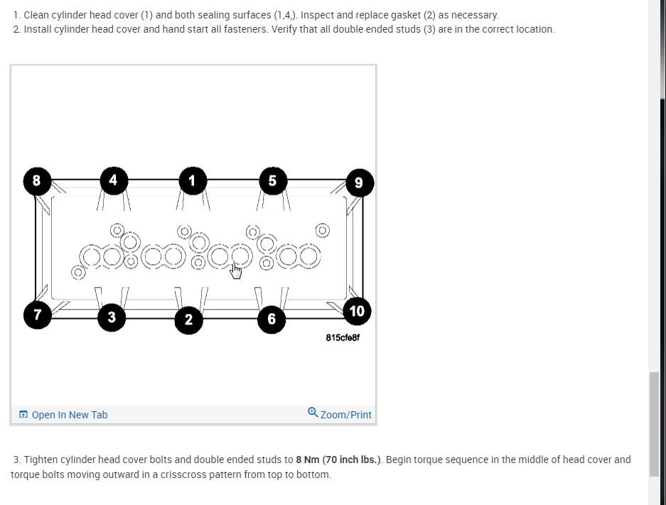

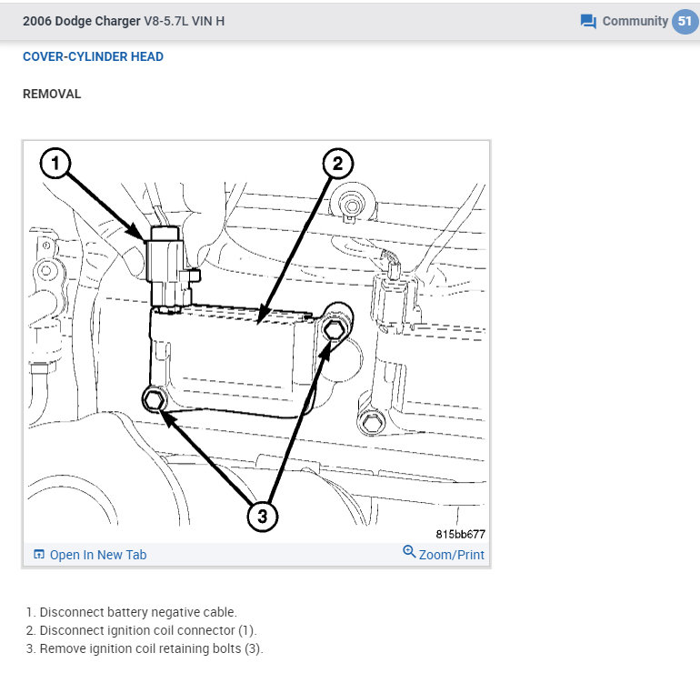

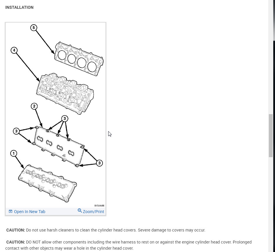

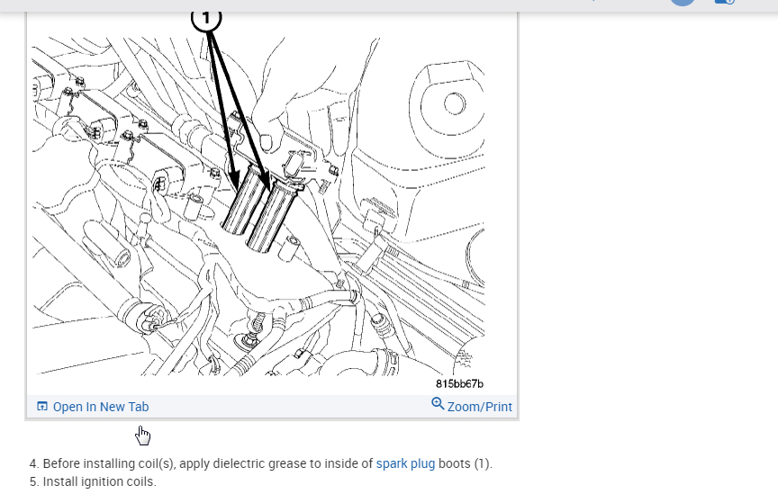

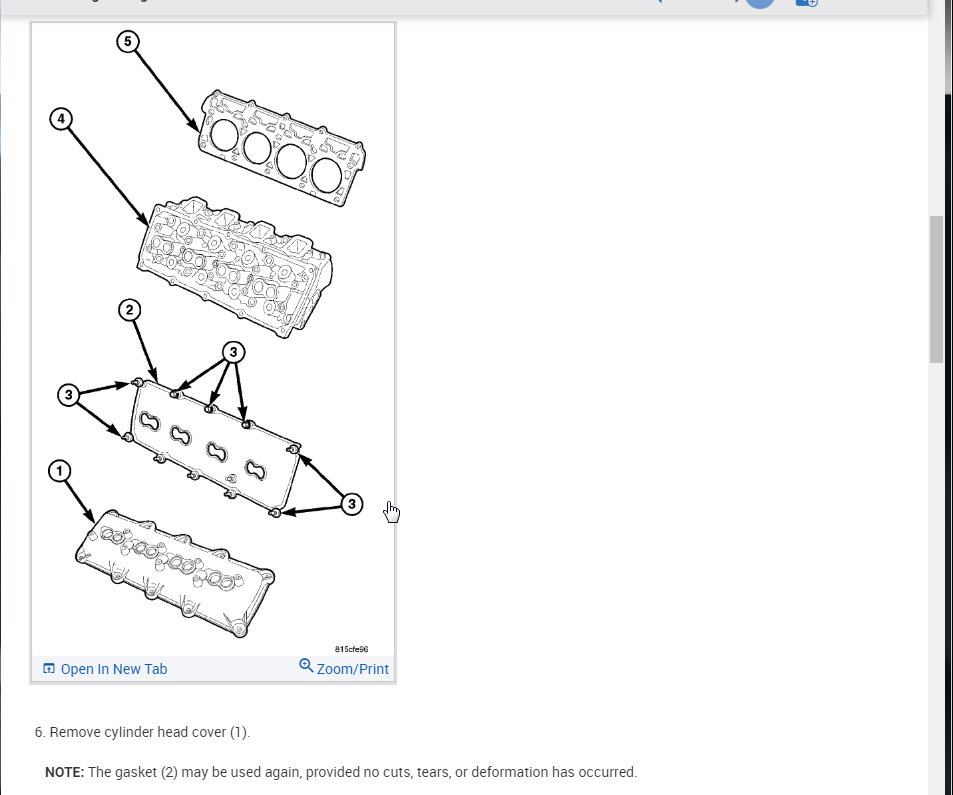

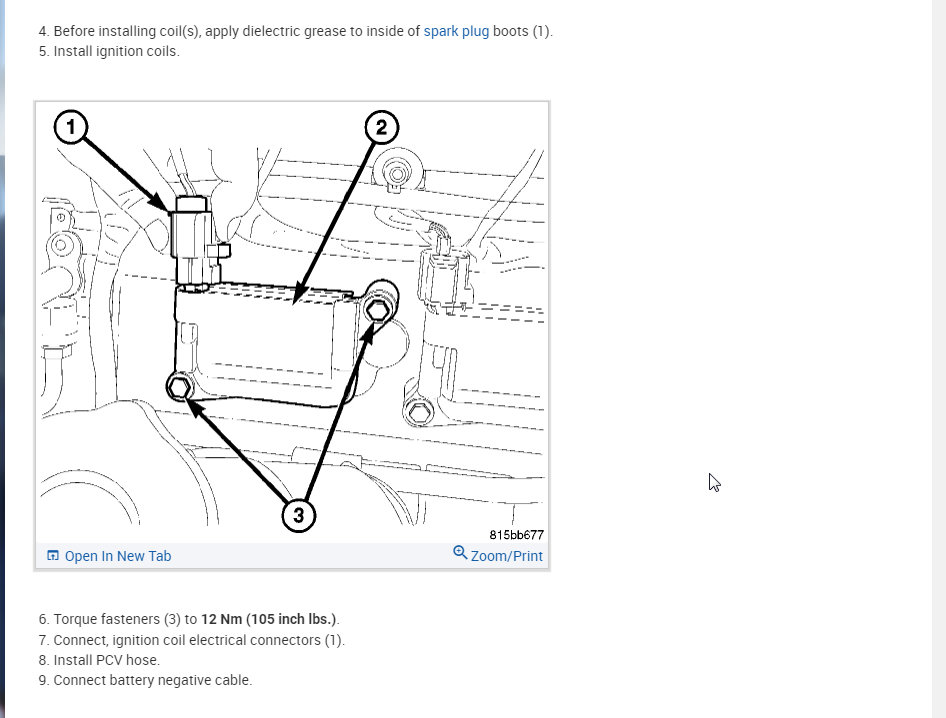

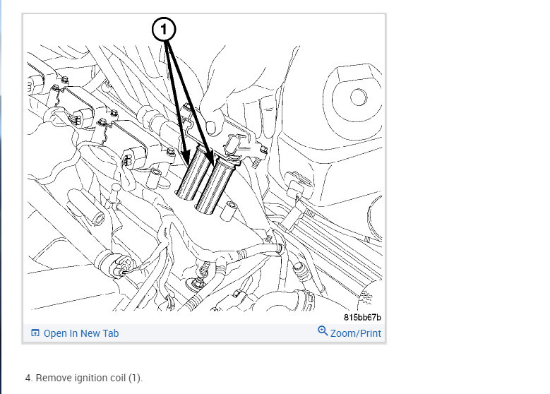

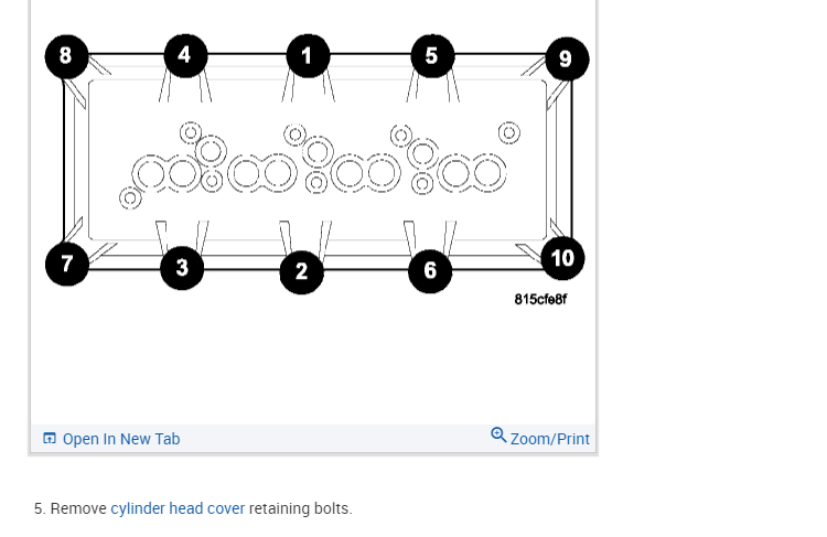

I can't seem to find any write up or a video on replacing the valve cover gasket for the passenger side for this car, all videos for the driver side.
Mar 14, 2020 at 1:30 PM
Here is the process from the manual. I assume you have already seen this. Basically the process is the same as the driver side but you will just have to remove anything that is in the way or on the valve cover so you can remove it.
Basically the OEM didn't see a need to spend the money to give specific instructions on both sides. Keep in mind, this was intended for technicians that work on these all day long so there are some things left to the tech to "figure out."
Let me know if this doesn't help and I will see if I can find something more on this. However, you should not need to remove much just to get the head cover off.
