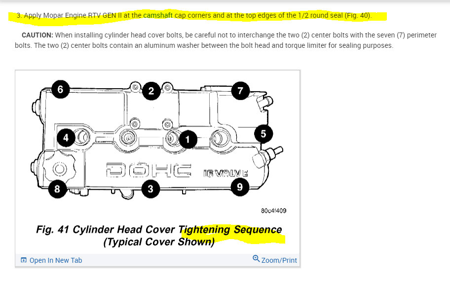

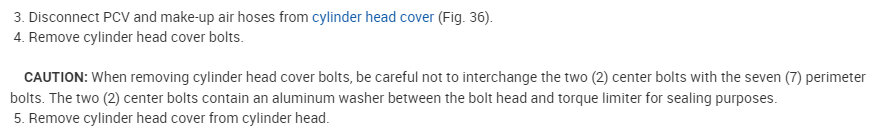

Valve cover, what is the correct sequence to tighten the bolts?
2004 CHRYSLER PT CRUISER
170,000 MILES • 2.4L • 4 CYL • 2WD • AUTOMATIC
KLETIS
  • 7 POSTS

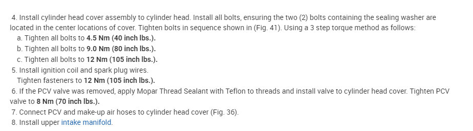

What is the torque spec in inch pounds? Do I need to use I think it’s called gasket sealer? If so what kind? Thank you very much.
Aug 1, 2023 at 12:21 PM
  • 110,244 POSTS

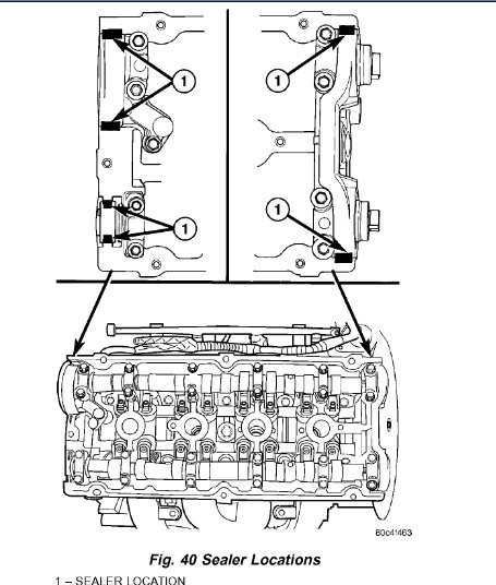

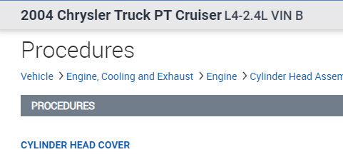

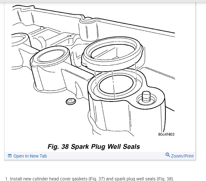

You will need an RTV gasket maker when doing this job. It is only required at certain parts of the valve cover. Make sure all surfaces are clean and dry before you install the gasket.

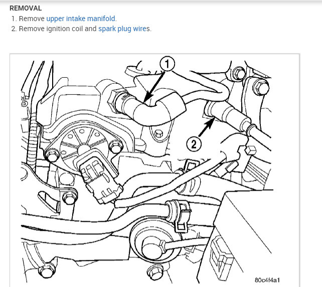

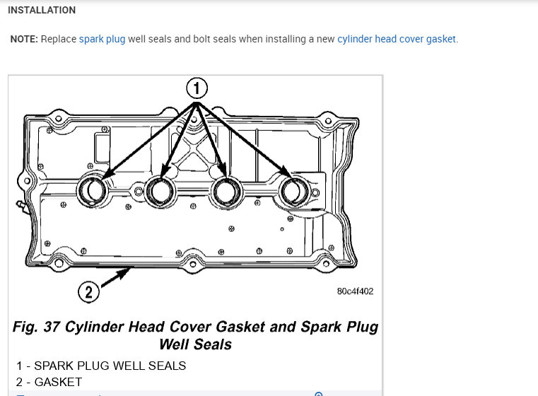

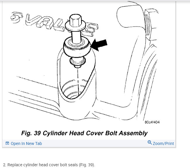

If you look below, I attached the directions for the removal and replacement of the cover. The directions include torque sequence and the manufacturer's torque specifications. Additionally, it shows where to put the RTV.
The very last pic I attached is an example of the RTV you can use. I selected that because most parts stores will have that in stock.

Went easy. would have been quicker, if I would break down and buy a printer. I followed the directions you sent and was done in about an hour runs good. Thank you very much.
