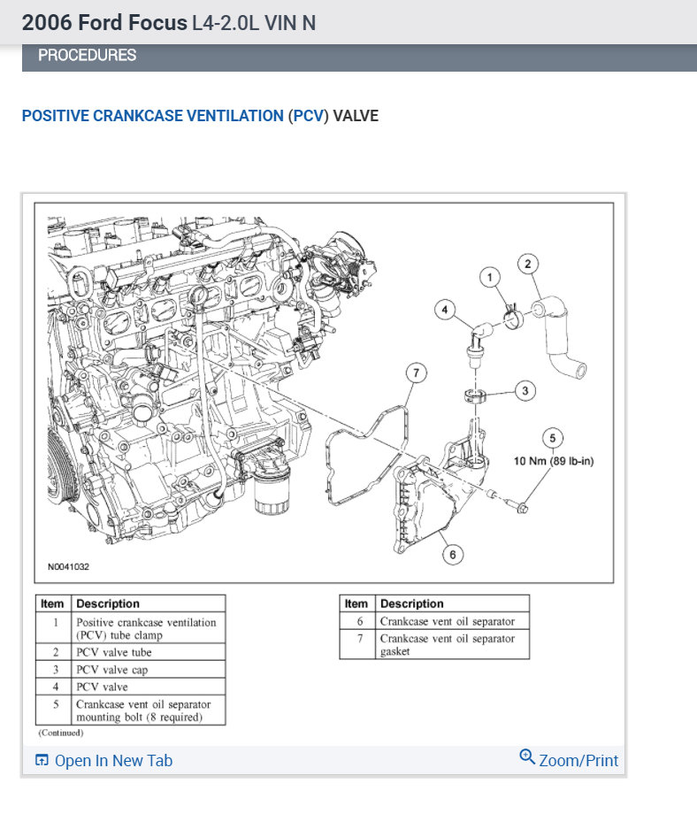

Our 2006 Ford Focus 2.0L has the Engine Light on. The only issue is that, at an idle, it runs rough, then dies. It will start right back up, but the problem is ongoing. A source said that it's possibly a vacuum leak. The source said that the most likely place for a vacuum leak is on the right front of the engine(while standing in front of the vehicle looking at the engine). Apparently, the PCV line has a 90 degree elbow in this area. There is a hissing sound coming from that area. My issue is that I'm not able to locate this elbow or the PCV line. I haven't been able to locate a vacuum diagram. Please help me.

probably a broken piece on pcv or hose. This guide will help us fix it.
https://www.2carpros.com/articles/repair-lean-mixture-codes-p0171-or-p0174-on-some-manufacturers
Here is the PCV and vacuum line diagrams. Check out the diagrams (Below). Please let us know what happens.

Using a can of carb cleaner, I've been able to pinpoint the leak to behind the drivers side of the intake manifold. There is a piece there that the parts store referred to as a vacuum switching valve. It's a small solenoid with 2 vacuum hoses on it. Replacing the hoses didn't fix the leak, so I'll replace the solenoid and let you know how it goes.
