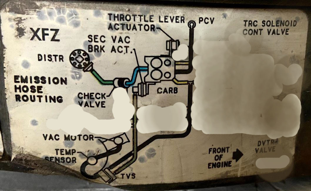

Vacuum diagram for my truck? Would you be able to "decode" it for me?

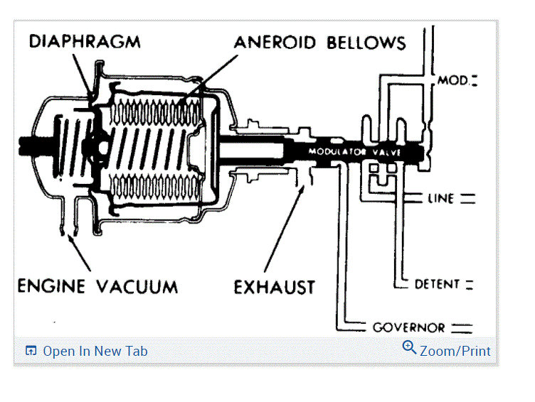

Is it coming from the vacuum modulator on the transmission? If it has a steel line, chances are that is what it is. Look at the transmission and locate the module. See if it attaches to the steel line. If I recall, it will be mounted near where the transmission dipstick tube is mounted. If that, is it, it simply gets engine vacuum.
If the vehicle has a carb (I don't think it does, but don't recall asking), it will mount to the bottom of the carb at a vacuum port.
Let me know. See pic below.

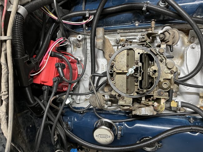

Okay, cool. So, the distributor should hook up to the large vacuum port in the middle of the carburetor in the back side, and then there is a small nipple just next to it, that’ll be for the transmission line?
Thursday, September 30th, 2021 AT 6:56 PM
  • 109,885 POSTS
If it is on the manifold, yes. It's been some time, but I remember the vacuum being attached to the intake manifold behind the carburetor.
Thursday, September 30th, 2021 AT 7:09 PM
TWEBB101
  • 178 POSTS

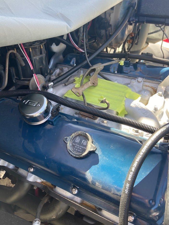

The only one I have on the manifold behind the carburetor is a large vacuum port, and I have the brake booster connected to that.
Thursday, September 30th, 2021 AT 7:11 PM
  • 109,885 POSTS
Okay, try using one from the base of the carb. It shouldn't make a difference. The worst case is a slower response from the modulator. However, I can't imagine it would even be noticeable.
That's a whole lot of engine! LOL
Hopefully, when you get it running, you can videotape it and upload it for me to hear.

To confirm; distributor needs ported vacuum, and transmission line needs manifold vacuum? I think I have them reversed right now.
Monday, November 29th, 2021 AT 9:52 PM
  • 109,885 POSTS
Yes, the distributor should be ported. The transmission responds to a drop in vacuum, so you want a manifold vacuum.
Looks great. Let me know how things turn out for you.

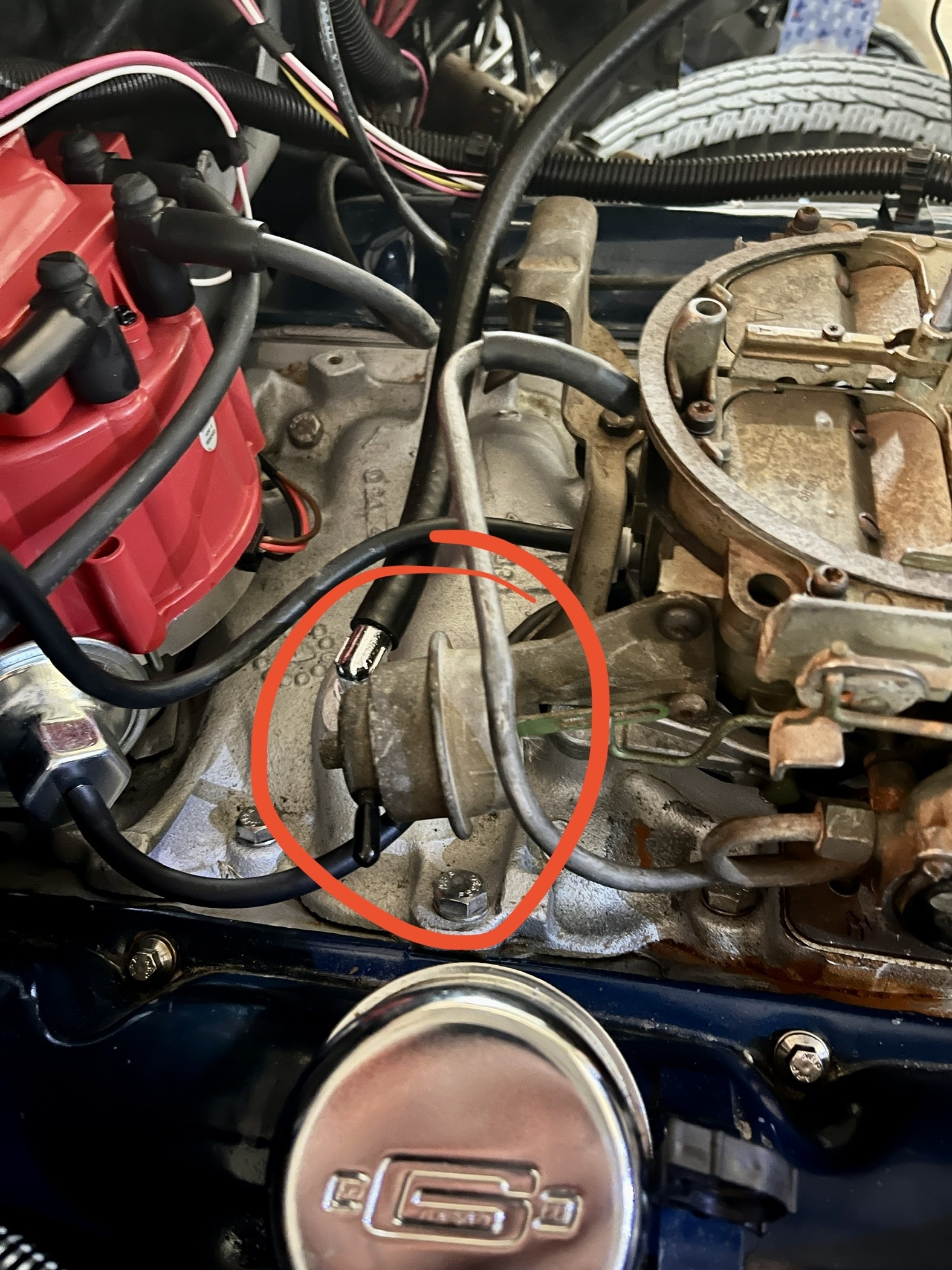

Thanks Joe. What about the rear vacuum break assembly? Ported or manifold? Or just plugged?
Tuesday, November 30th, 2021 AT 9:23 PM
  • 109,885 POSTS
It appears you circled the choke pull-off. That will be a manifold vacuum.
+1
