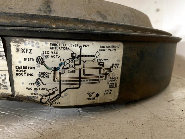

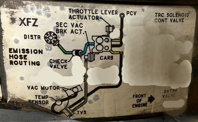

I was wondering if you would mind doing me a huge favor regarding the vacuum diagram for my truck? Would you be able to "decode" it for me, and put it in laymen's terms? I'm looking for something that would say: "run a line from the distributor to the ....; run a line from the PCV valve to the carburetor; etc." something like that. Is that something you can help me with?
Sep 25, 2021 at 8:13 AM
  • 110,194 POSTS
I would be happy to help. By chance, is there a specific one that you are having trouble with?
Sep 25, 2021 at 8:00 PM
TWEBB101
  • 183 POSTS
I just rebuilt my engine, Chevrolet 454 in a 1984 C20, and am getting ready to start it for the first time. I have all the pieces ready except for the vacuum system. I just don’t know all the acronyms. Also, I should mention that I have removed the smog pump system.
Sep 25, 2021 at 8:07 PM
  • 110,194 POSTS
Okay, let's try this. See if this helps.
vac act -- vacuum actuator
TRC -- throttle return control
TVS -- thermostatic vacuum system
DTVS -- distributor thermal vacuum switch
EFE -- early fuel evaporation
The others are common, but if you see one that is unknown, let me know.

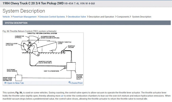

Thanks Joe! That helped me be able to draw out a simple diagram to know where to put the lines. In my rebuild, I removed the AIR Pump, and the stock exhaust (I put headers on instead). So, I think that I can remove the spark TVS, the EFE-TVS, and the EFE, and their associated lines. Is that correct? Also, the TRC solenoid cont valve. I'm not sure what that is. do I need that?
Sep 26, 2021 at 8:55 PM
  • 110,194 POSTS

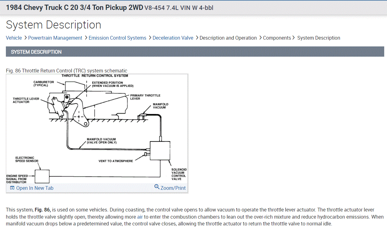

As far as the TRC, take a look at the attachment below. It shows and explains what the circuit is for and what it does.
Let me know if this helps.
See pic below.
Sep 26, 2021 at 9:25 PM

Great thanks. I'm still having trouble understanding the TRC portion. can you help me with that? Do you have a picture of it by chance? Or tell me what it would be connected to?
Sep 27, 2021 at 7:09 PM
  • 110,194 POSTS
The TRC is basically a stopper. It receives vacuum from the solenoid vacuum which gets vacuum from the intake.
If I remember correctly, this was primarily used to help prevent stalling and dieseling when turning the engine off. It's been a while. LOL
Also, you can run that vacuum hose straight to an intake vacuum. It isn't a ported vacuum.
I hope I'm helping. LOL It's been a while since I had the chance to work on one of these. My old 78 is as basic as they come. LOL
Take care and let me know if I can help.
Sep 27, 2021 at 8:44 PM

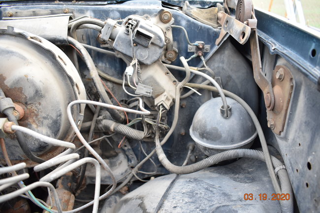

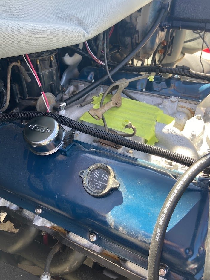

Also, the sphere-like vacuum canister; can that be capped as well?
Sep 28, 2021 at 7:56 AM
  • 110,194 POSTS
Is it a charcoal canister or is it a vacuum hold canister? Where is it located?
Since you really don't have much of an emissions system anymore, chances are it won't hurt to disconnect it. However, I don't know what the state emissions laws are where you are located. Also, it shouldn't hurt anything disconnecting the TRC. If you have stalling issues, then consider reinstalling it.
Let me know what I Can do to help.
Sep 28, 2021 at 6:25 PM
TWEBB101
  • 183 POSTS
Here you go; it's the round sphere on the right side, driver side by brake booster.
Sep 28, 2021 at 6:49 PM
  • 110,194 POSTS
That is a holding vacuum. Basically, it is a reserve tank. If you didn't have it, the component it supplies vacuum to would lose vacuum under acceleration.
Does that make sense? LOL
Sep 28, 2021 at 7:48 PM

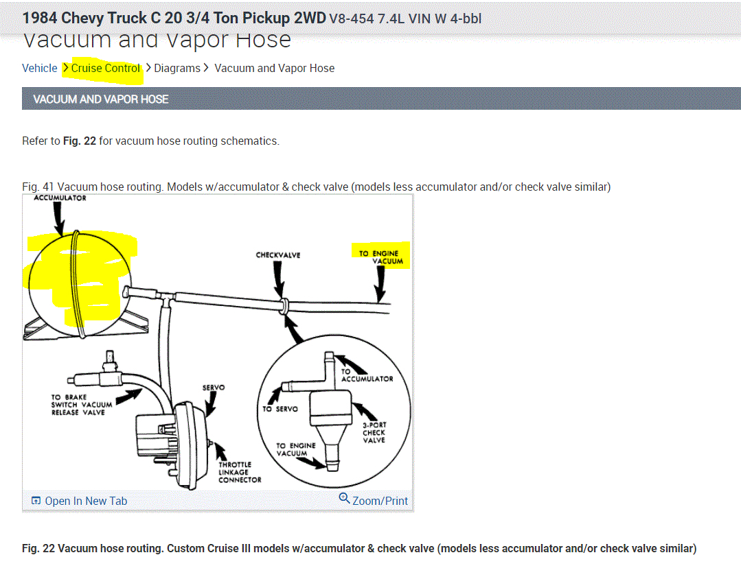

Yeah, it does. How do I know what component was hooked to it? Was there a standard configuration for those? I think it went to the cruise Servo, but I have no idea.
Sep 28, 2021 at 7:57 PM
  • 110,194 POSTS
You are correct. It was for cruise control. I actually was able to find a vacuum schematic for it. Take a look below.
See pic below.
Sep 29, 2021 at 6:41 PM
TWEBB101
  • 183 POSTS
Great, thank you! I don't have the servo in yet, it needs to be replaced, so I'll just cap it for now.

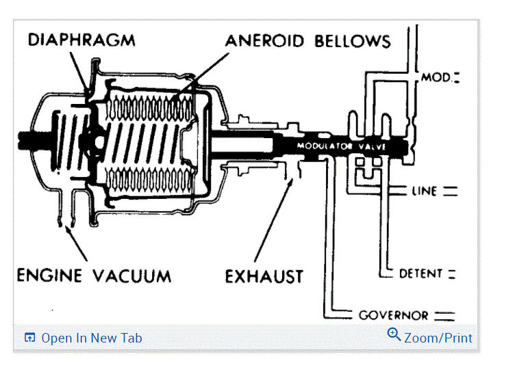

Hey Joe, one more question: there is a metal vacuum line that runs from my THM400 transmission up to the top of the block, by the distributor. Where does that connect to?
Sep 29, 2021 at 8:32 PM
  • 110,194 POSTS
Is it coming from the vacuum modulator on the transmission? If it has a steel line, chances are that is what it is. Look at the transmission and locate the module. See if it attaches to the steel line. If I recall, it will be mounted near where the transmission dipstick tube is mounted. If that, is it, it simply gets engine vacuum.
If the vehicle has a carb (I don't think it does, but don't recall asking), it will mount to the bottom of the carb at a vacuum port.
Let me know. See pic below.

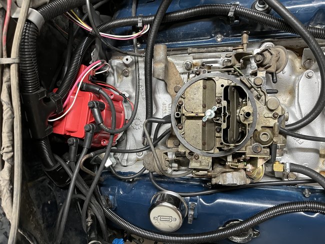

Great, thanks. Yes, it’s a steel line, as you described, and yes, I have a carb. Does it matter what port it connects to on the bottom of the carb?
Sep 29, 2021 at 9:14 PM
  • 110,194 POSTS
I said that backward. The base of the carburetor is ported vacuum. You need a manifold vacuum. There should be a nipple behind the carburetor on the intake that it goes through.
Sep 30, 2021 at 6:09 PM
TWEBB101
  • 183 POSTS
Okay, cool. So, the distributor should hook up to the large vacuum port in the middle of the carburetor in the back side, and then there is a small nipple just next to it, that’ll be for the transmission line?
Sep 30, 2021 at 6:56 PM
  • 110,194 POSTS
If it is on the manifold, yes. It's been some time, but I remember the vacuum being attached to the intake manifold behind the carburetor.
Sep 30, 2021 at 7:09 PM
TWEBB101
  • 183 POSTS
The only one I have on the manifold behind the carburetor is a large vacuum port, and I have the brake booster connected to that.
Sep 30, 2021 at 7:11 PM
  • 110,194 POSTS
Okay, try using one from the base of the carb. It shouldn't make a difference. The worst case is a slower response from the modulator. However, I can't imagine it would even be noticeable.
That's a whole lot of engine! LOL
Hopefully, when you get it running, you can videotape it and upload it for me to hear.
Sep 30, 2021 at 7:19 PM
TWEBB101
  • 183 POSTS
To confirm; distributor needs ported vacuum, and transmission line needs manifold vacuum? I think I have them reversed right now.
Nov 29, 2021 at 9:52 PM
  • 110,194 POSTS
Yes, the distributor should be ported. The transmission responds to a drop in vacuum, so you want a manifold vacuum.
Looks great. Let me know how things turn out for you.
Nov 30, 2021 at 3:42 PM
TWEBB101
  • 183 POSTS

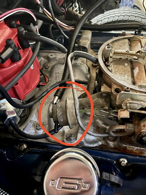

Thanks Joe. What about the rear vacuum break assembly? Ported or manifold? Or just plugged?
Nov 30, 2021 at 9:23 PM
  • 110,194 POSTS
It appears you circled the choke pull-off. That will be a manifold vacuum.
