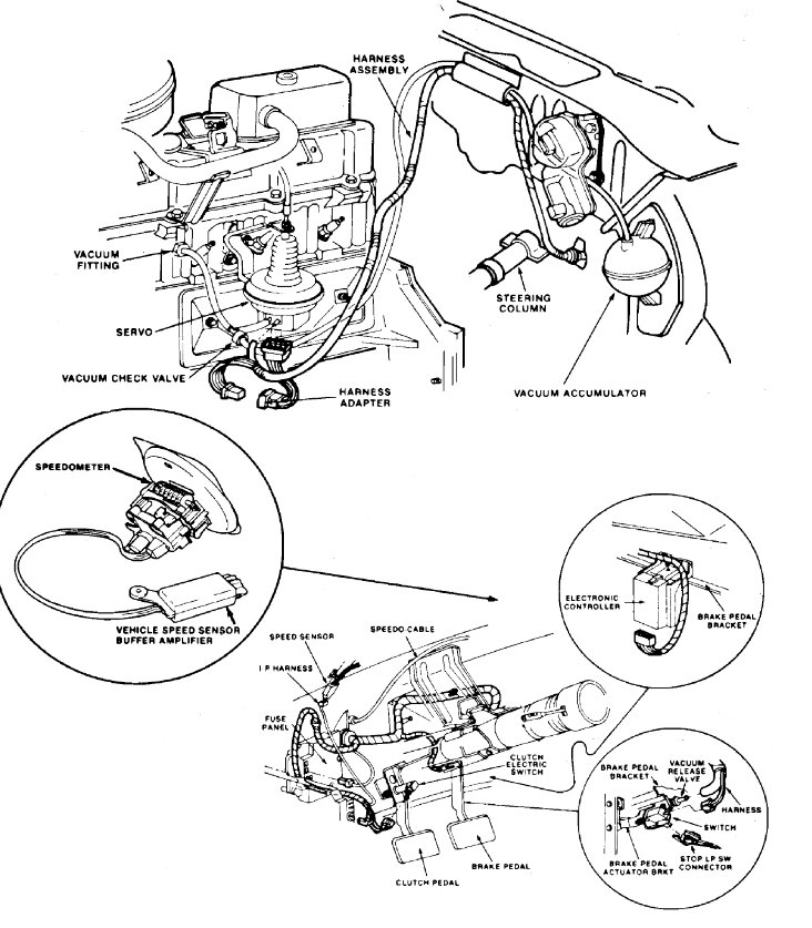

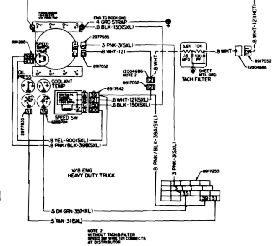

I would start by checking the brake light switch adjustment because this will cause the cruise control not to work. Here are the system wiring diagrams so you can see how the system works and where to check for power and ground.
Check out the images (below). Please let us know how it goes

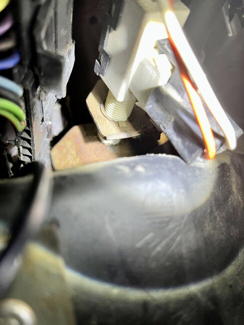

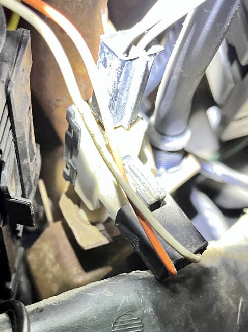

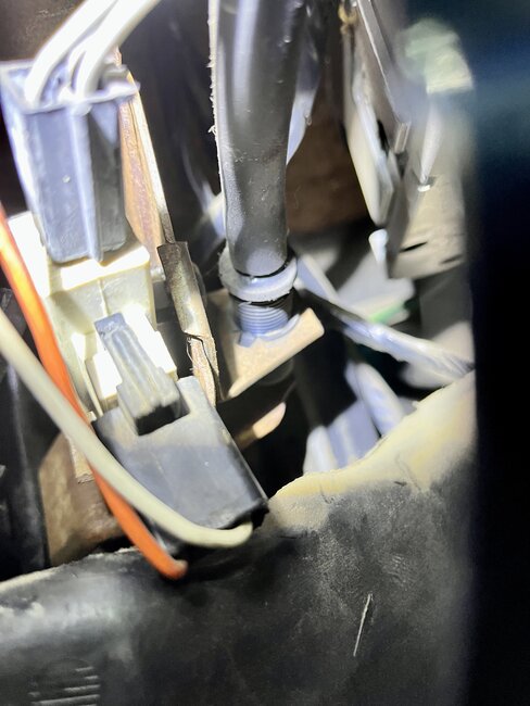

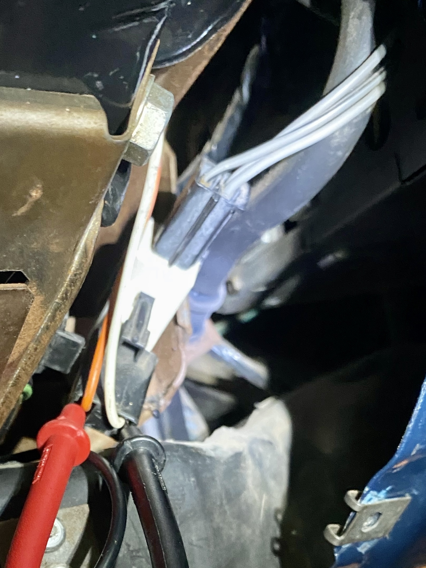

Thanks Ken. I want to update you. I was looking around for the brake switch you mentioned, and noticed that the wire for the cruise, from the turn signal switch, was cut and not even plugged in. (Face palm). So, I replaced that, but still nothing. So, back to square one. I found the brake light switch, it has 2 plugs in it, and seems to be working. The brake lights come on :) haha on the same bracket is a black switch as well; is that for cruise or something else? How do I check them for proper adjustment/functionality?
Jul 15, 2023 at 11:18 AM
  • 55,224 POSTS
Yep, one is for the brake lights and the other is for the cruise control. If the brake lights are coming on the switch is working. But to test the cruise side use a voltmeter on continuity and when you press the brake pedal it should connect.

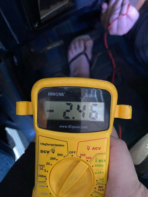

TWEBB101
  • 183 POSTS

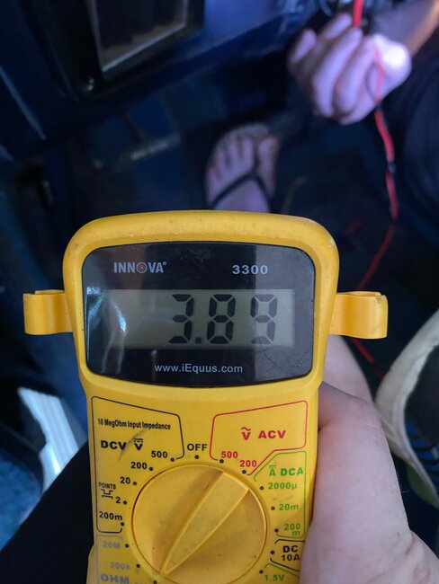

I tested it this morning, and here’s what I’ve found while pressing the brake pedal:
- No readings on the gray plug at all. The gray wires feed into the black hose that’s connected to the black brake switch.
- With red lead on orange and black lead on white: 3.89 ohms.
- With red lead on white and black lead on orange: -2.46 ohms.
Jul 16, 2023 at 4:04 AM
  • 55,224 POSTS
You need to test the switch with the wiring connectors disconnected. Please let me know, test while pressing the brake pedal and not pressing the brake pedal as well.

TWEBB101
  • 183 POSTS
Okay, tested the switch with both plugs disconnected. Bottom plug (orange/white), I got 1 with no brake pedal, and 0.00 with brake pedal, on both combinations of red and black leads. On the top plug (gray), I got the opposite, 0.00 with no brake, 1 with brake.
Jul 17, 2023 at 6:02 AM
  • 55,224 POSTS

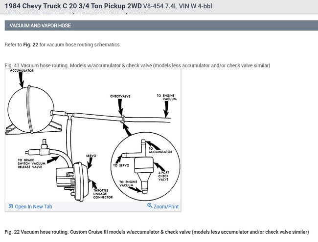

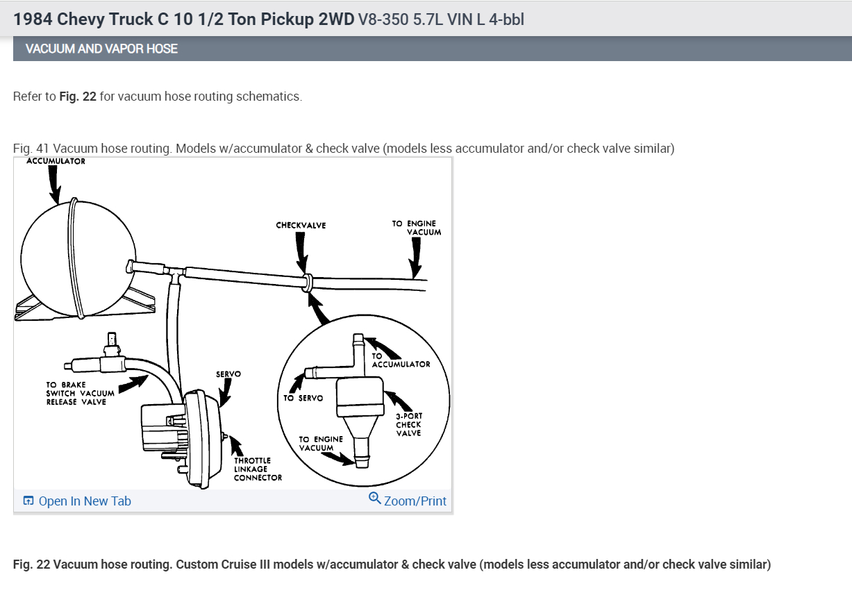

You tested through the switch, correct? let's go over the vacuum lines to make sure they are correct. Check out the images (below). Please let us know what you find.

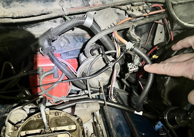

TWEBB101
  • 183 POSTS

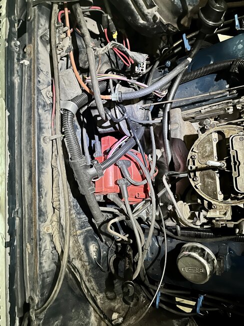

Yes, I disconnected the plugs from the white switch and touched the multimeter leads to the switch prongs directly.
Attached are pics of my vacuum setup currently. Manifold vacuum > T fitting > one end to the brake booster, one end to check valve > one end to vacuum accumulator ball, one end to another T fitting > one end to climate control, one end to cruise control servo. Other outlet on servo goes into a black hose that goes through the firewall to the brake pedal area (I believe.)
Jul 18, 2023 at 9:28 AM
  • 55,224 POSTS

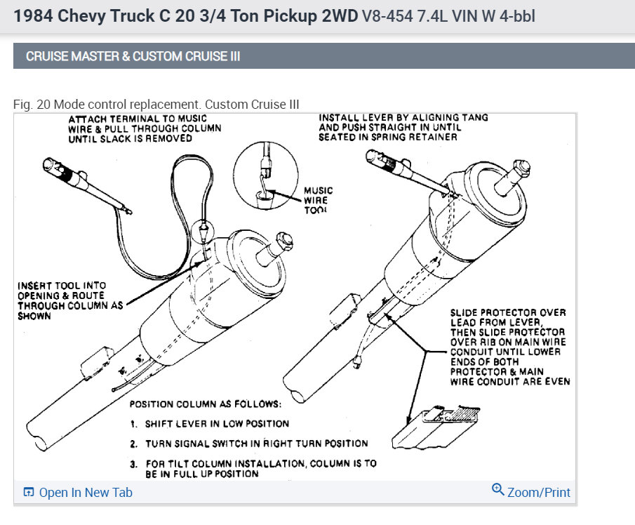

Yep, the vacuum lines look good, you might have a bad/defective servo. But I do remember that the switch stock (blinker handle) would break the wires just outside of the switch. I think I found the wiring diagrams for the cruise control, but it is a little hard to read.

I am sure there is, by looking at the wiring diagrams I would test the signal from the cruise switch and the power and ground to the system. Did you replace the turn signal stock? They had a high rate of failure.

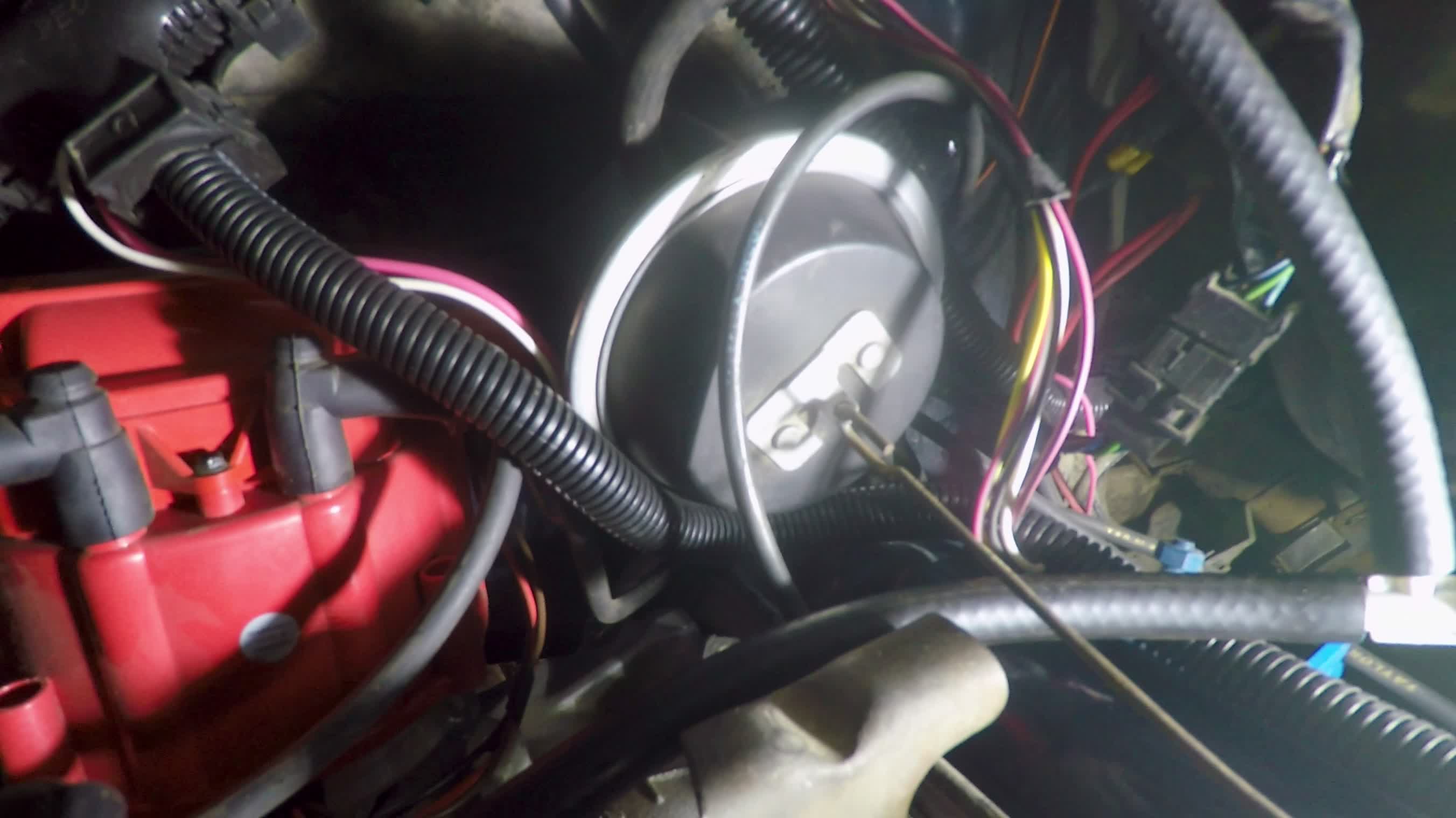

  • 55,224 POSTS
Yes the servo, the cruise control head. That is the only thing that can make the cruise control hunt.
Dec 30, 2023 at 2:43 AM
TWEBB101
  • 183 POSTS

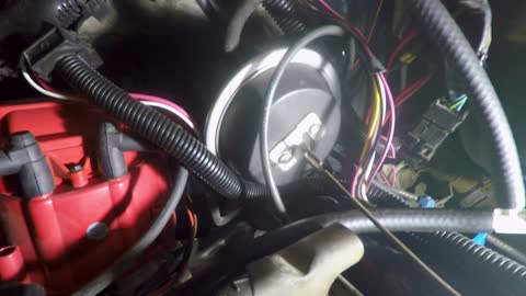

Confirmed: Servo is all over the place. I stuck a GoPro under the hood and got this footage. I have a used one I can try swapping out, but it’s a pain to get those screws back in! :)
Jan 1, 2024 at 5:30 AM
  • 55,224 POSTS
Nice work, this is a common problem with the cruise control hunting problems. I am glad you figured it out. Use 2CarPros anytime, we are here to help. Please tell a friend.
