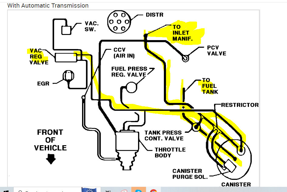

This is probably a stupid question but I'm having a big problem with my vacuum on my car listed above. , my buddy thought he could do my vacuum and really messed
It up and I have tried to put it back with no success, I've looked at sticker on the car and it's not matching what's on the car close but not the same. Motors stock I don't know. Can you help me?

Hello, so you just need a vacuum hose routing diagram for the engine. Has the engine been swapped out in this vehicle that you know of? Hopefully the diagram in service info is not the same as what's on the car. I'll post it here in a minute, and if you have any questions, we can try to give you some direction. Can you take a picture of the top of the engine and post it here so we can see what you are dealing with?
Jun 16, 2024 at 7:51 AM

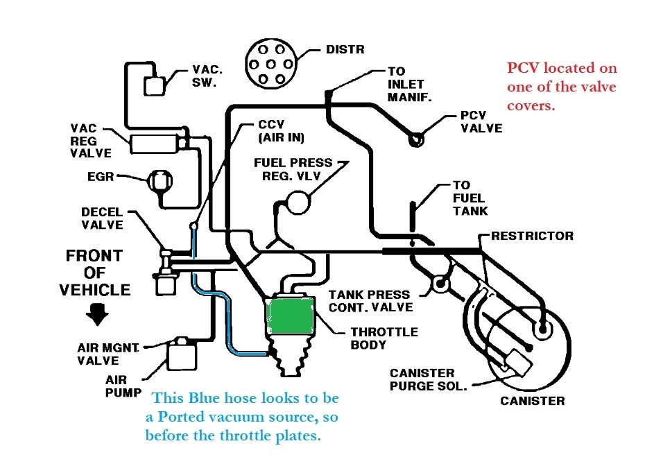

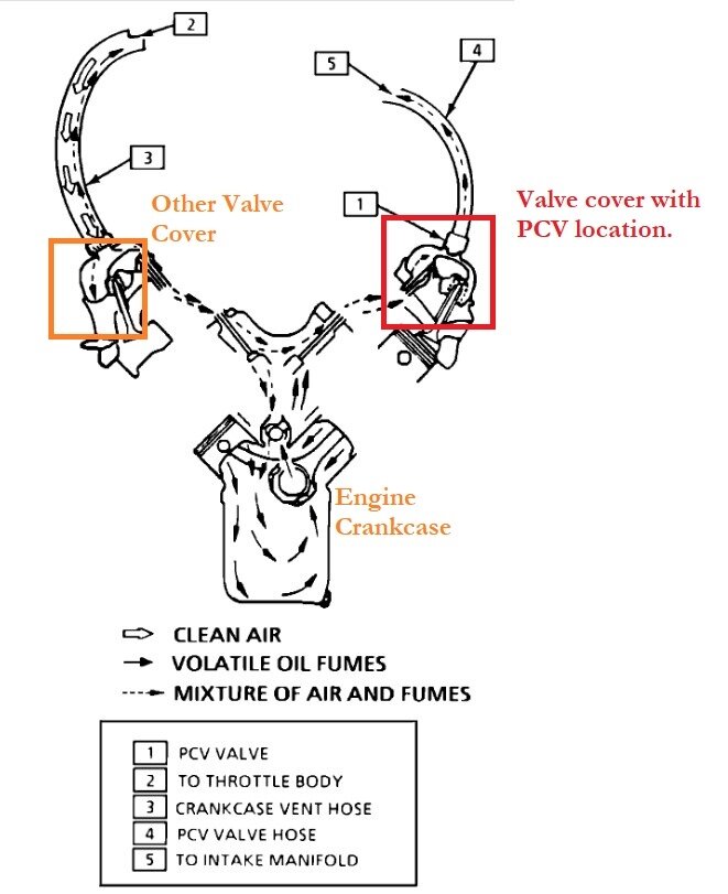

Here is the vacuum hose routing (diagram 1) and the engine valve covers with the PCV valve location (2nd diagram).
Jun 16, 2024 at 8:04 AM

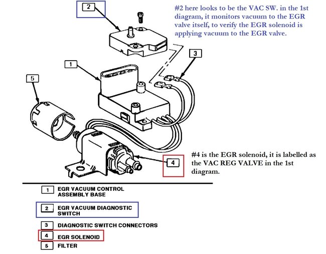

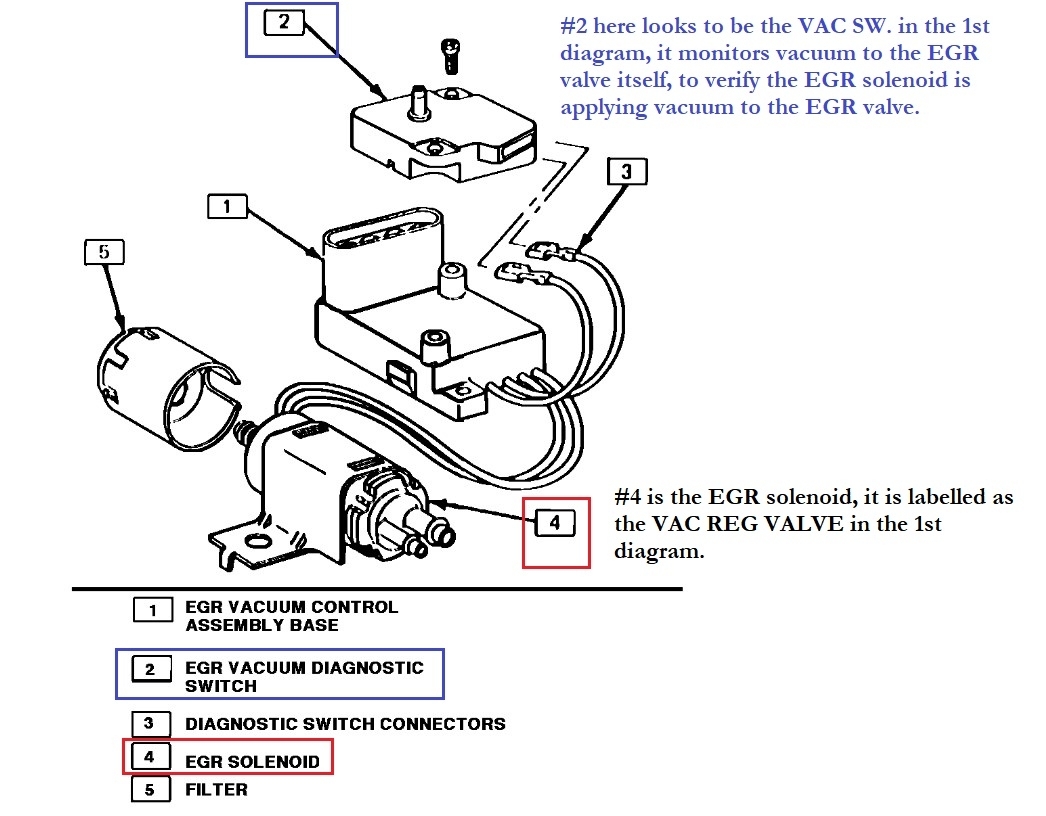

This is the diagram for the EGR valve, with its vacuum solenoid, since this is a bit of different type of setup. It has a vacuum switch (VAC SW) to monitor the EGR solenoids operation.
Jun 16, 2024 at 8:11 AM

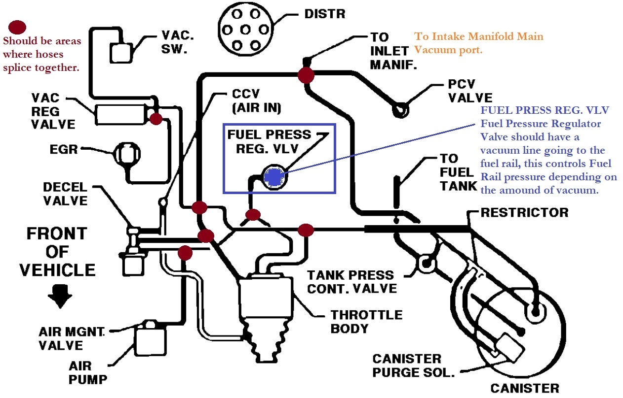

Additional info, hopefully this helps some.
Jun 16, 2024 at 8:24 AM

Okay, let's try again with my car. My buddy really messed up the vacuum on my car thinking he was doing me a favor. Anyway, I have to redo all the vacuum lines on my car listed above 2.8. I look at the sticker under the hood and it is a little different. The 2 big lines coming out of the canister one goes to the EGR, and the second one goes where to fuel tank right, but it has a hose going off it towards the intake that where I'm confused, I try to send a photo, but my phone won't do it. can you help?
Jun 22, 2024 at 7:34 AM (Merged)
  • 110,248 POSTS
Hi:
The three destinations from the vapor canister are the intake manifold, the vacuum regulator valve, and the fuel tank. None of them should go to the EGR.
I attached a pic below. Let me know if that helps.
