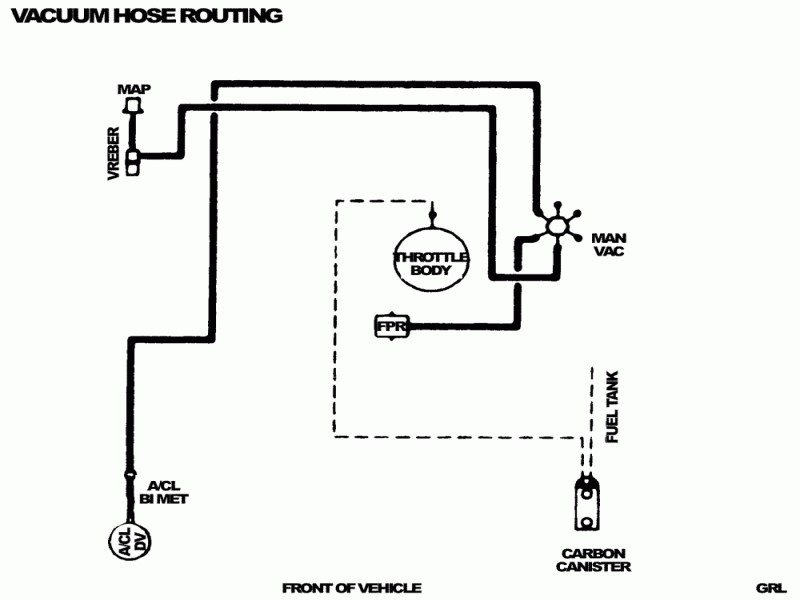

Vacuum hose diagram needed
2002 FORD RANGER
280,000 MILES • 2.3L • 4 CYL • 2WD
HERI.OVIEDO
  • 23 POSTS
I am going to look at all the components that connect with vacuum hoses because I have a fat vacuum leak or faulty part somewhere.

A common area for that vintage Ford to leak is inside the truck on the HVAC system. You may not even hear the leak. A quick way to test that part of the system is to use a vacuum pump with a gauge on it, connect it to the hose from the intake manifold and draw a vacuum, shut off the valve and watch the gauge, if it holds move the controls to other places and see if the vacuum drops on those. If you find nothing there then you can check under the hood. The problem there is the Ford doesn't list a vacuum diagram in the information we have. Instead they put a sticker under the hood showing the lines because they vary depending on options. However a fast way to find a vacuum leak is to use a can of starting fluid or carburetor cleaner and on a cold engine you start it and spray the fluid around anyplace that could leak, like the intake manifold, lines and any suspected location. You will know when you get close as the engine will change from an idle as it gets the extra fuel.

Thanks I will look to the diagram under the hood.
