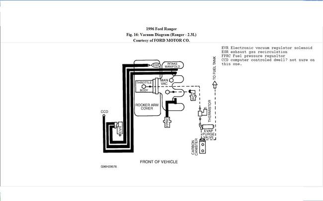

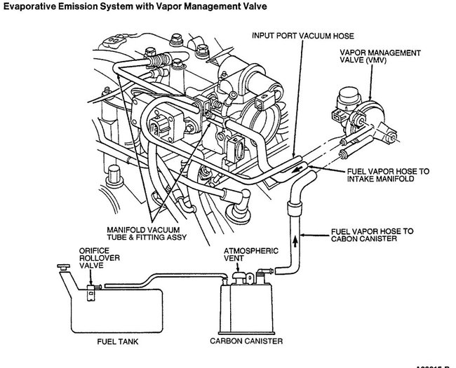

my ranger has a broken vacuum line and i need to know where it goes. i have figured out that one line goes to the purge valve and i don't know where the other one goes. please help......................................................................................
Jan 5, 2020 at 7:54 PM (Merged)
TY ANDERSON
  • 719 POSTS
Here is a vacuum diagram for the 2.3l,3.0L & 4.0L. Check out the diagrams (Below). Please let us know if you need anything else to get the problem fixed.

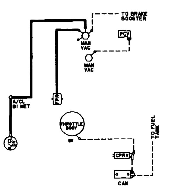

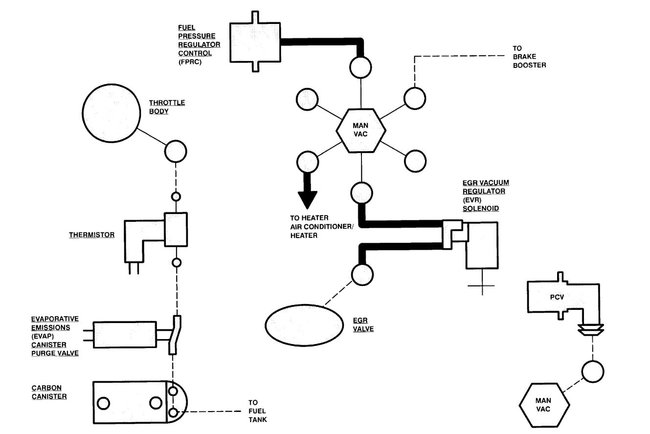

changed the heads and cannot remember where the vacuum lines go
Jan 5, 2020 at 7:55 PM (Merged)
HMAC300
  • 48,601 POSTS
there are 2 different routings im sending both
HMAC300
  • 48,601 POSTS
screwed p both are the same on first reply

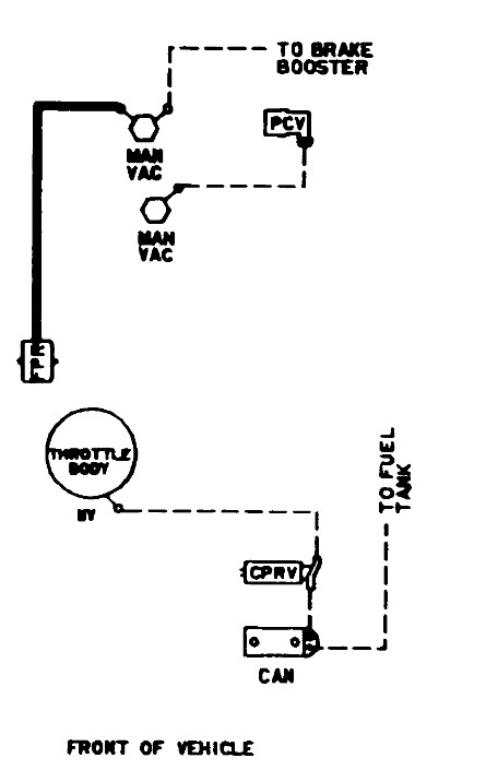

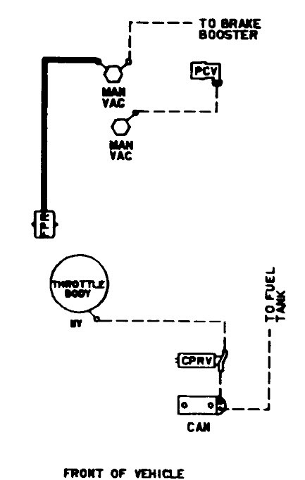

How can I download a schematic showing the vacuum line configuration for a 1990 Ford Ranger XLT with the 4.0 engine? Where can I download a schematic drawing of the vacuum line configuration
WRENCHTECH
  • 20,761 POSTS
See if this helps
