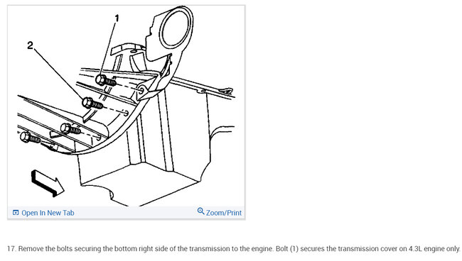

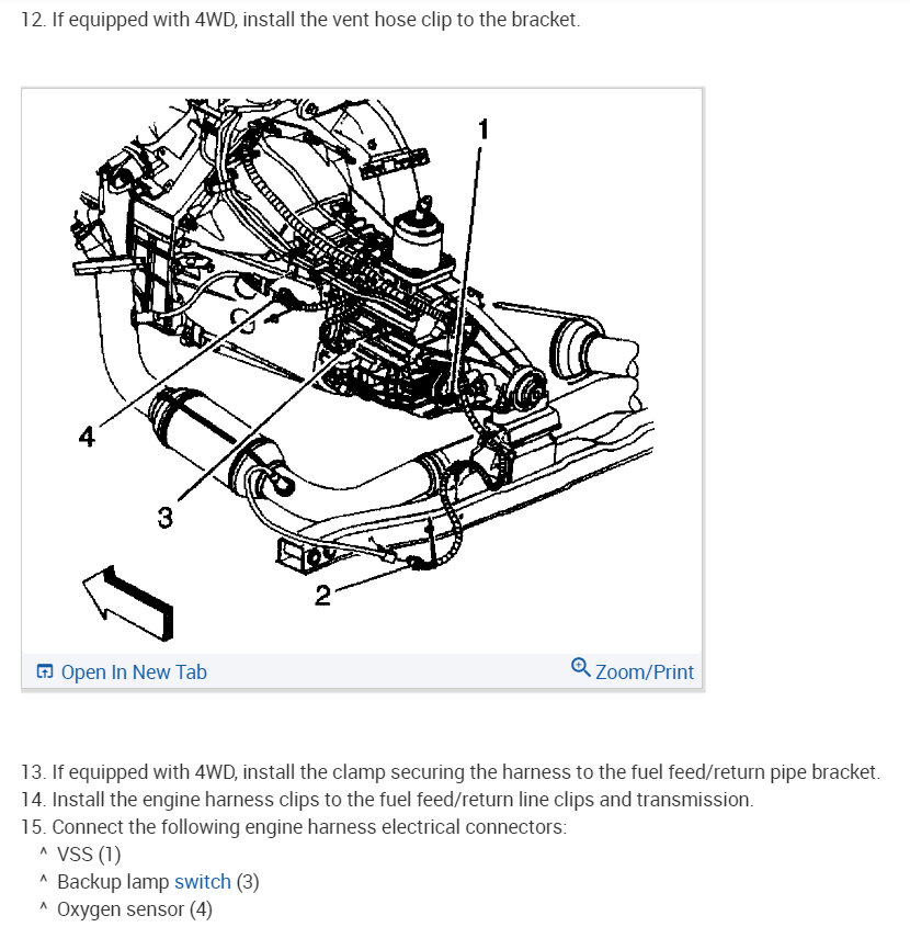

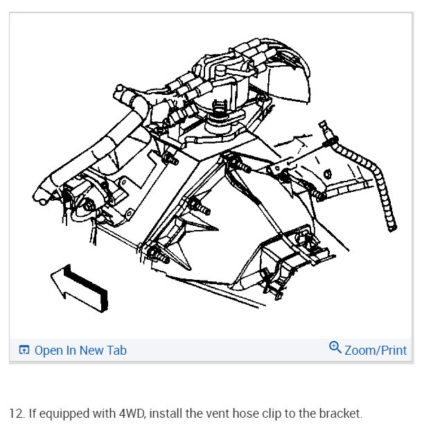

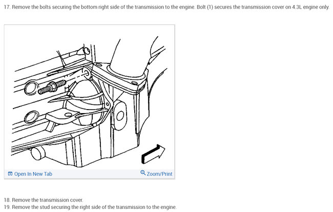

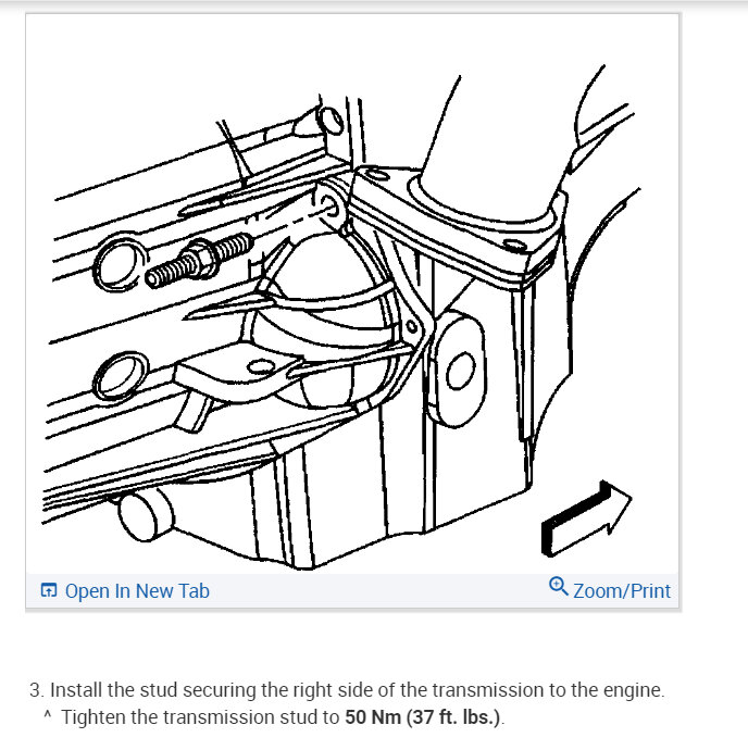

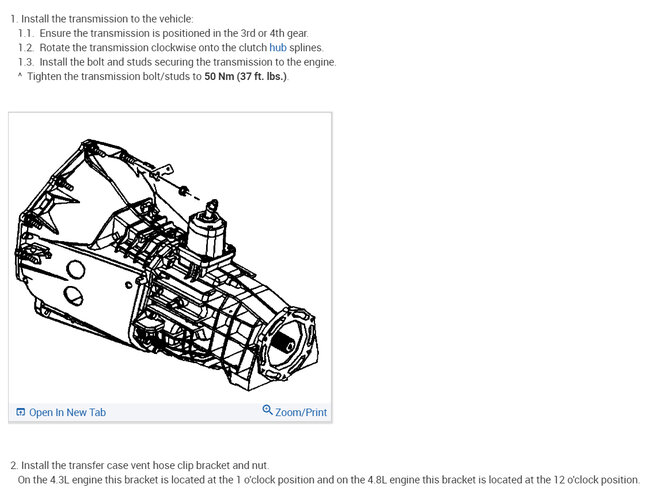

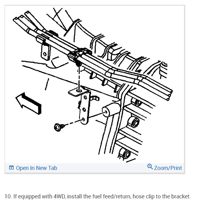

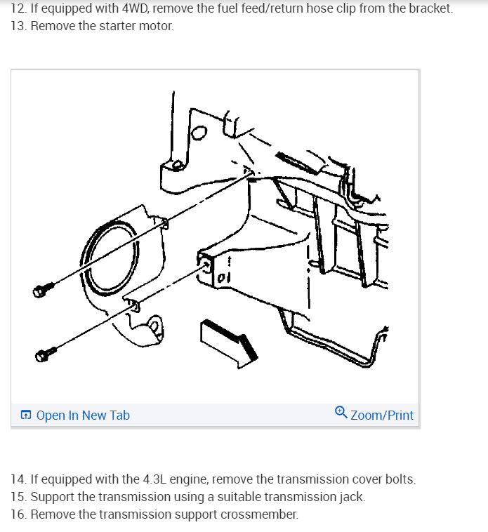

That could be, also the clutch disc can only be installed one way so if it is backwards, it will cause this problem as well. Either way the transmission needs to come out to see what's going on. Here are the instructions and a guide to help you get the problem fixed:
https://www.2carpros.com/articles/clutch-doesnt-work-sometimes-or-not-at-all
and
https://www.2carpros.com/articles/how-to-replace-a-clutch
