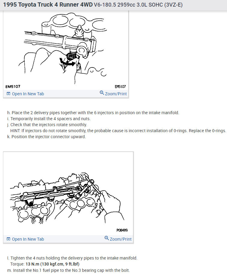

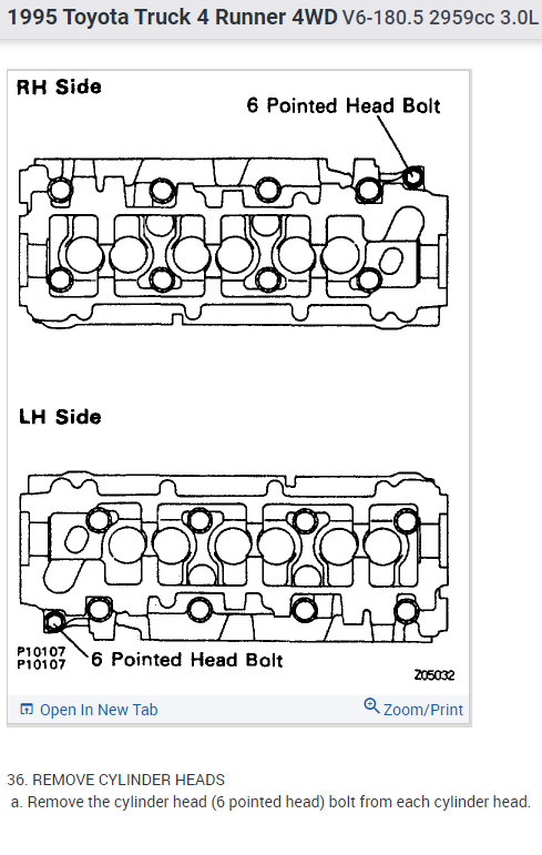

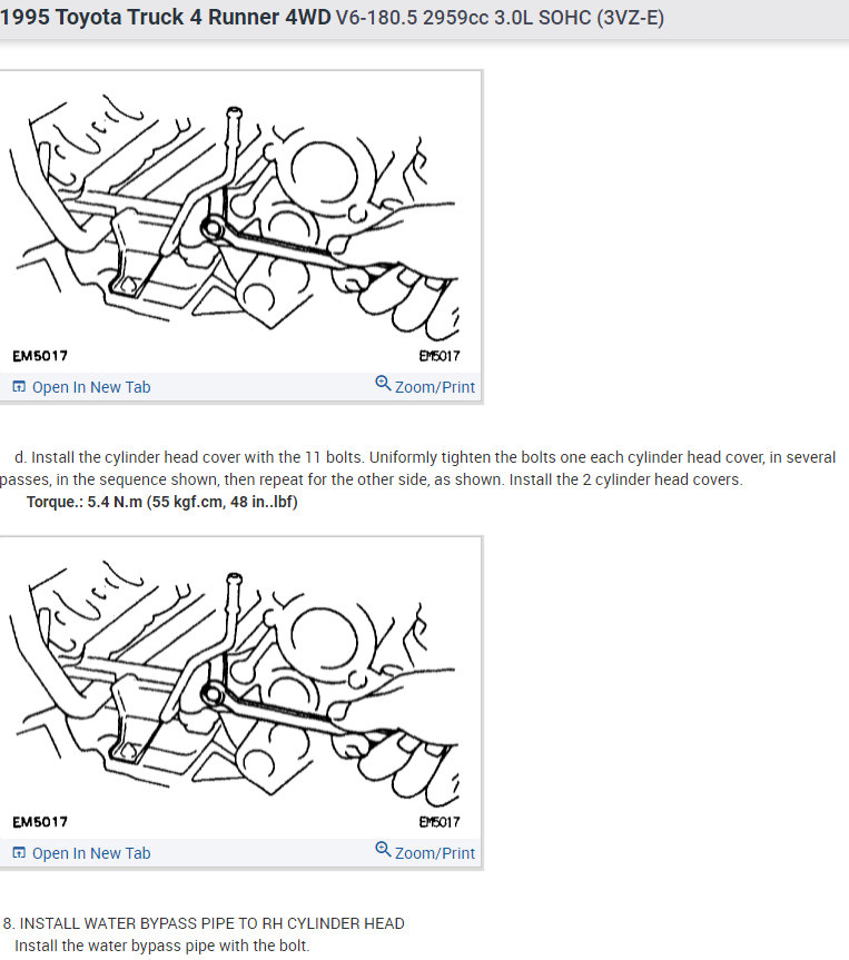

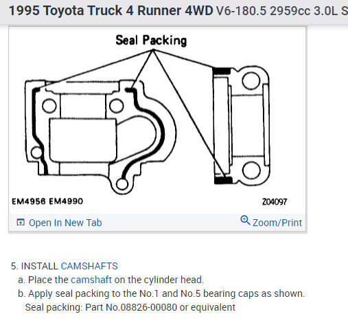

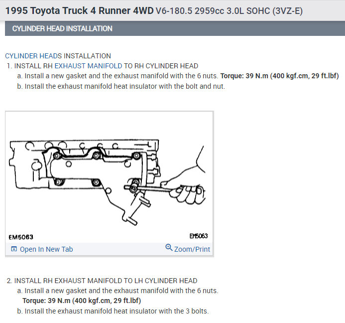

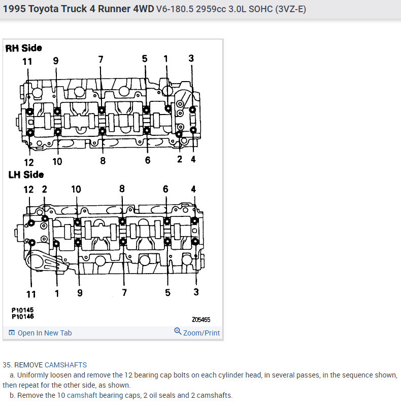

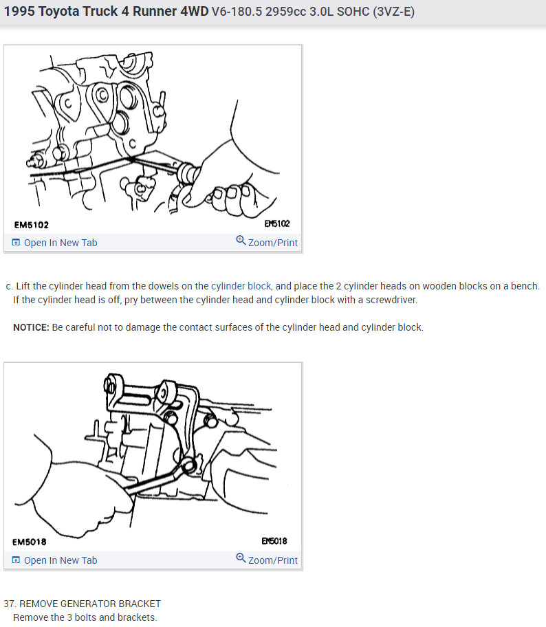

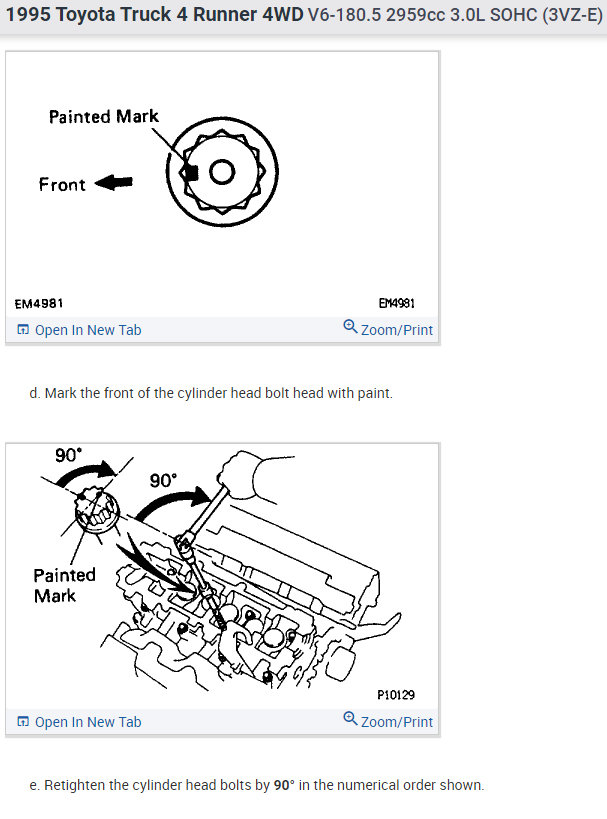

With no power until 20 MPH, did compression check to find....Right side all 3 at 175 lbs. (Plugs stark White).Left side all at 75 lbs. (Plugs all black). Would "Liquid Head Gasket Repair" be a viable option ? Thanks for your time & response.

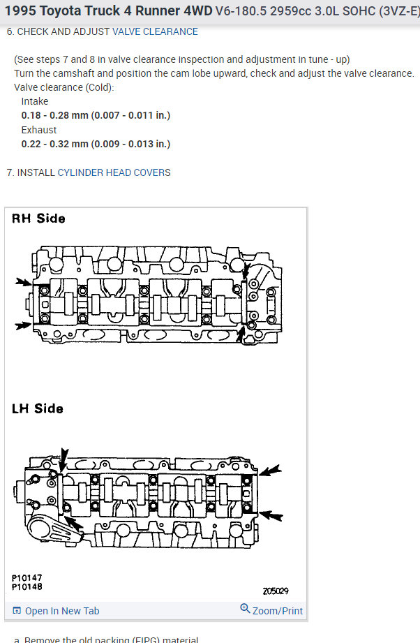

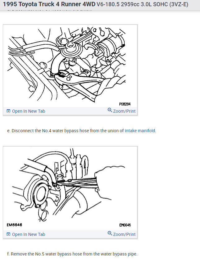

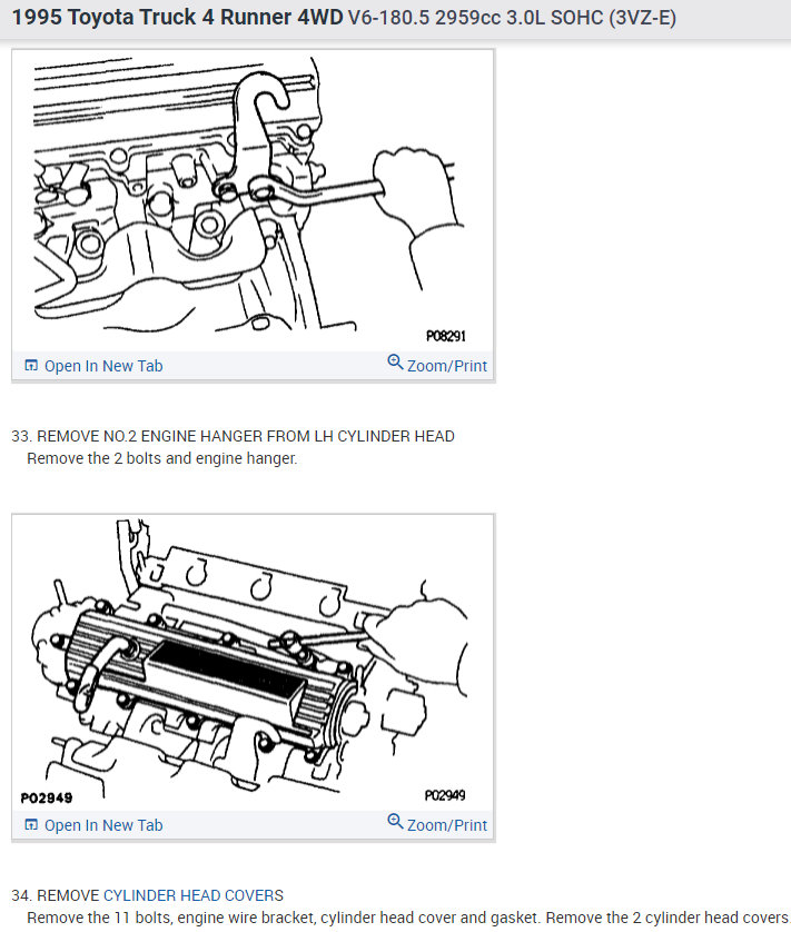

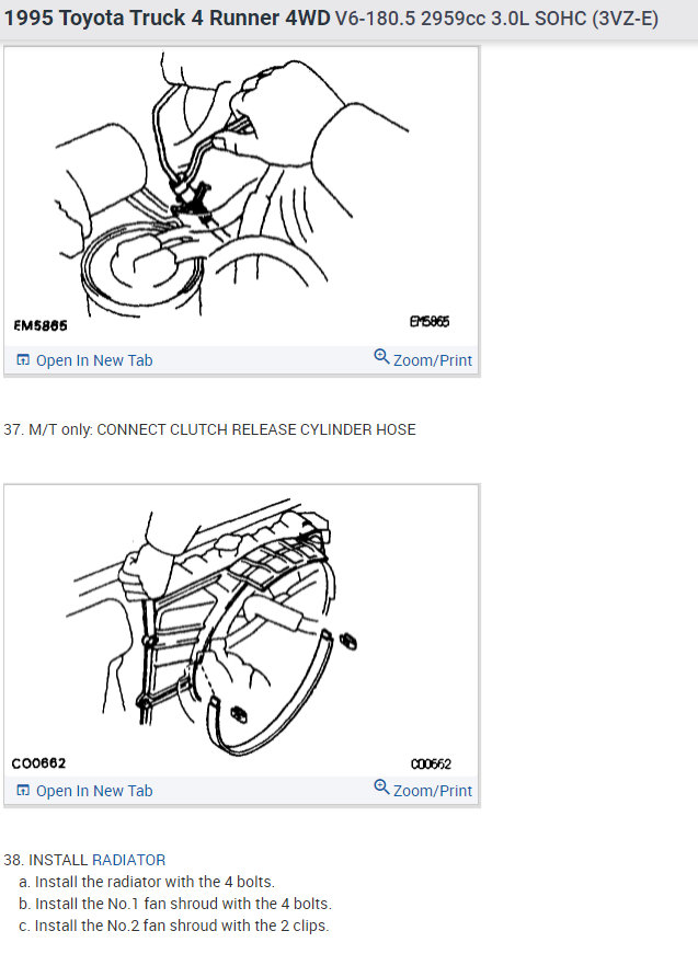

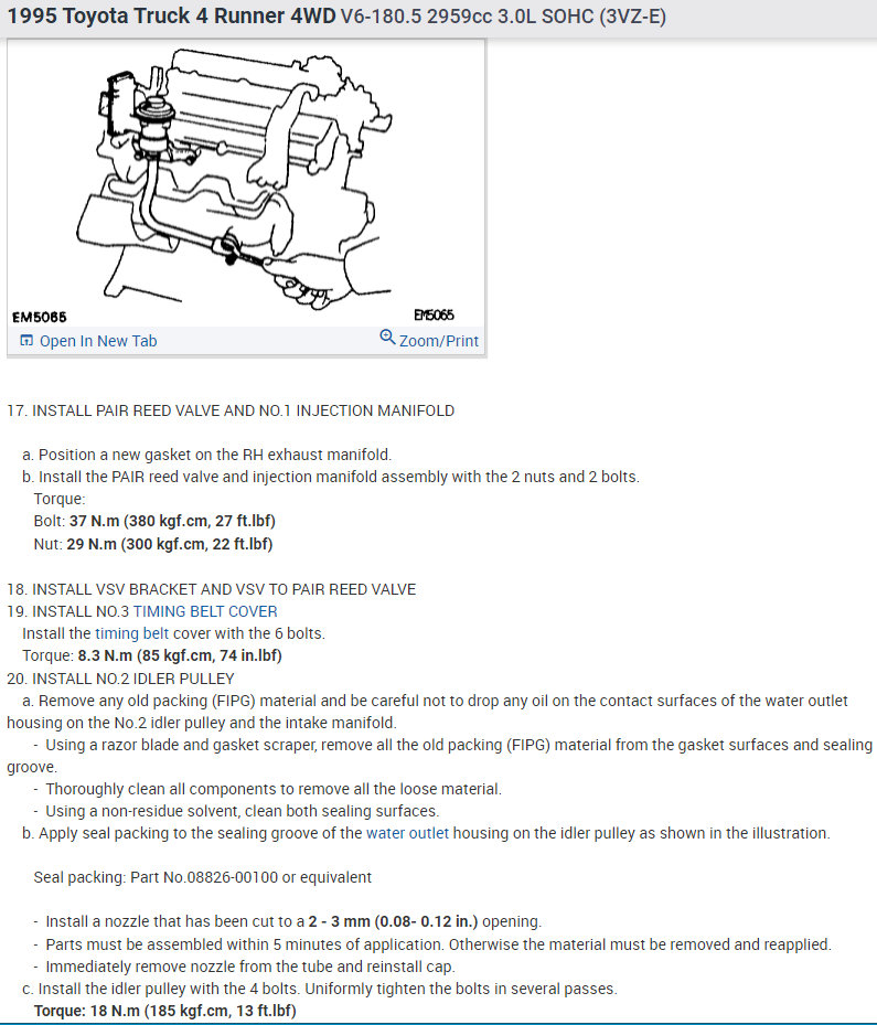

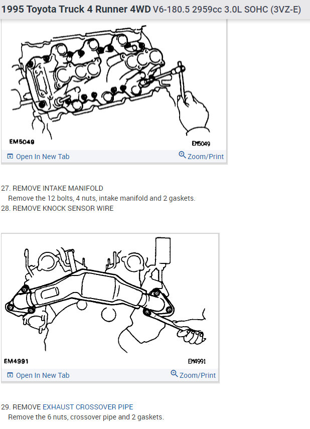

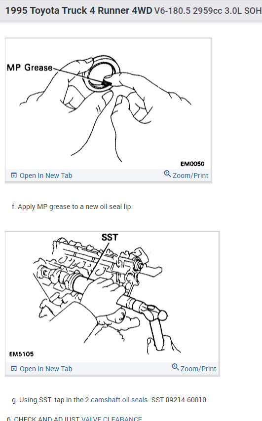

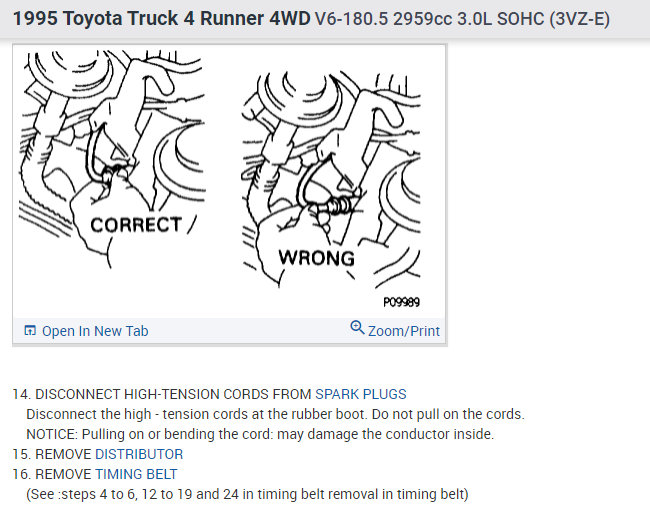

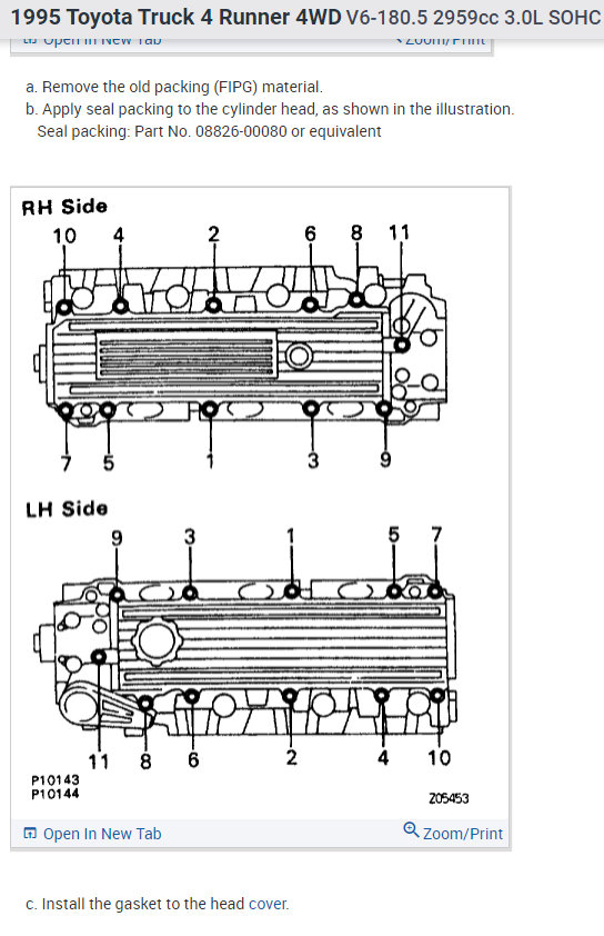

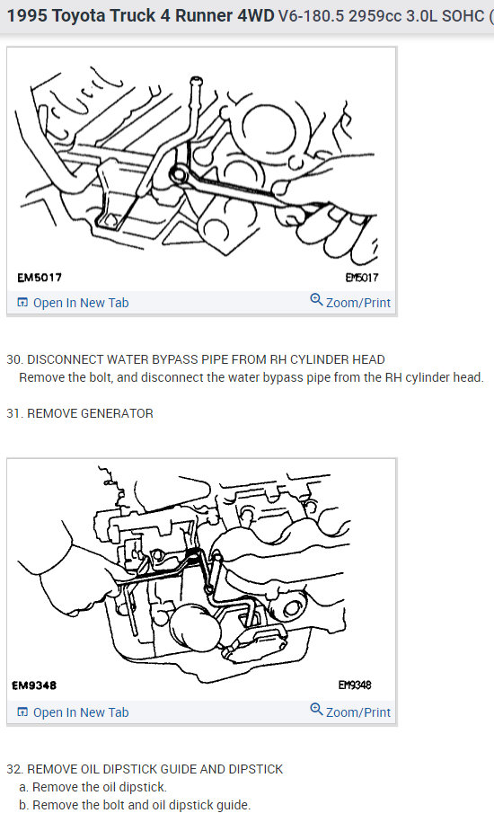

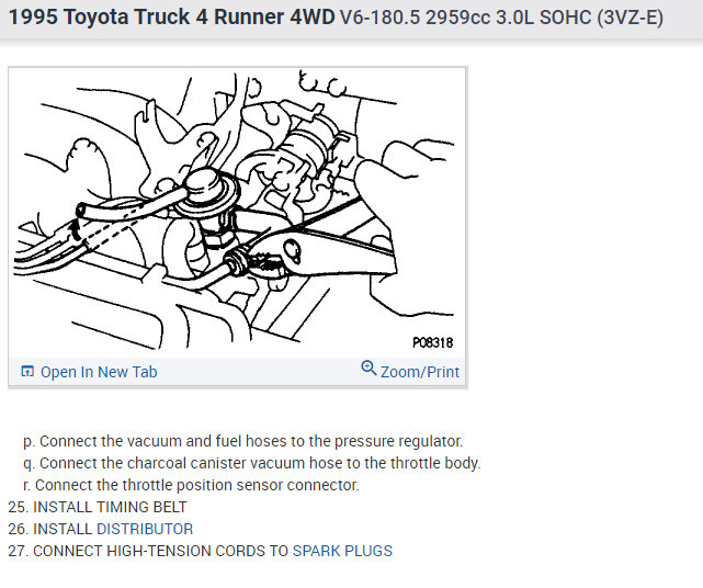

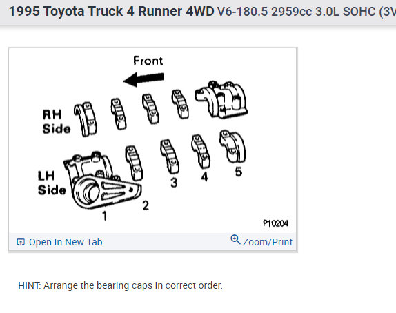

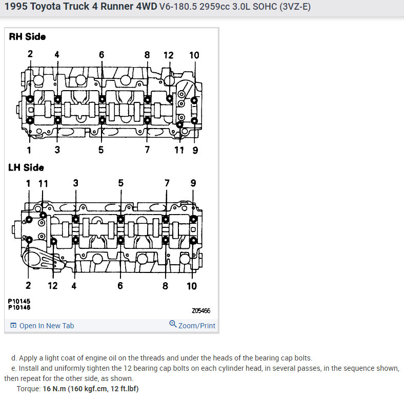

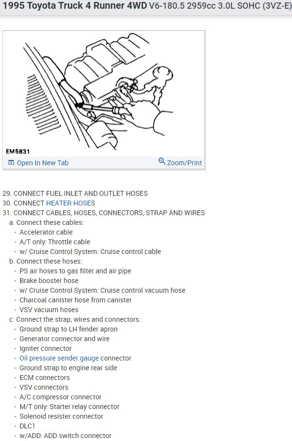

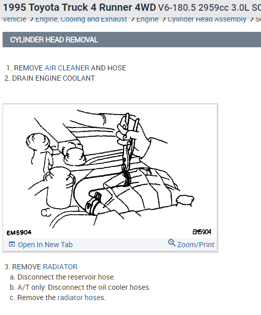

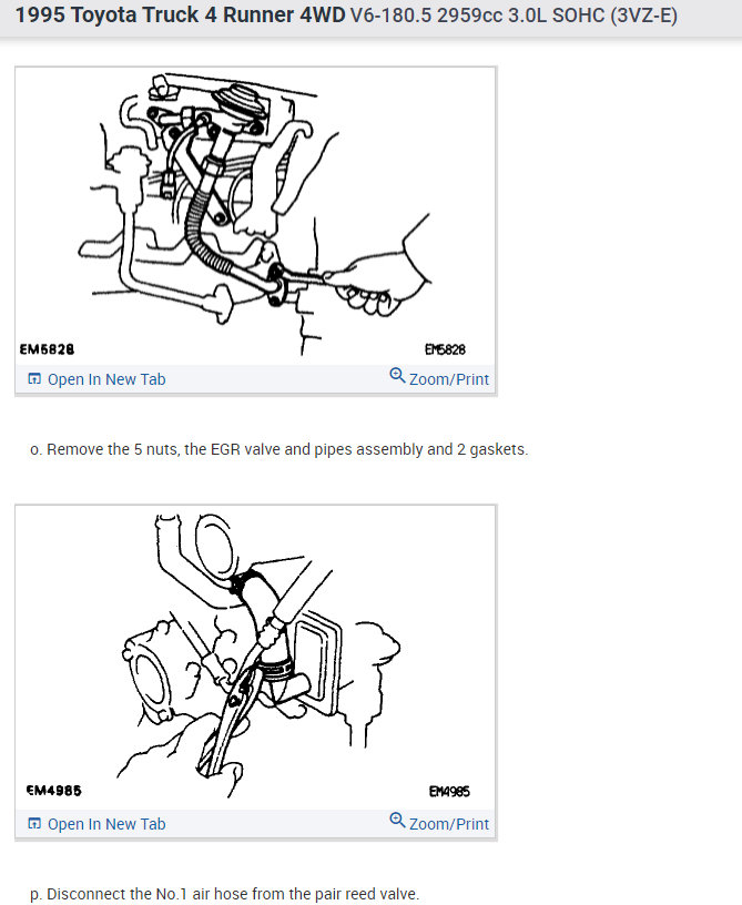

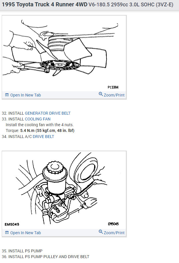

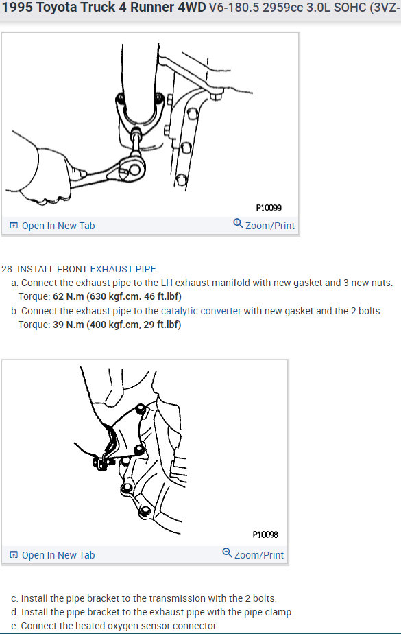

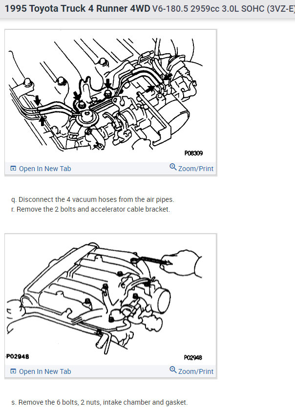

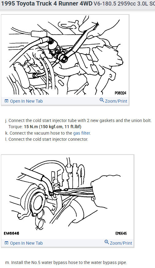

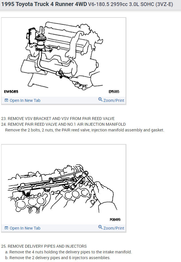

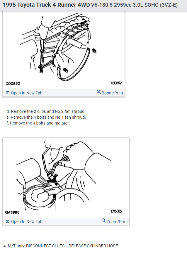

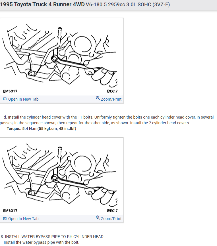

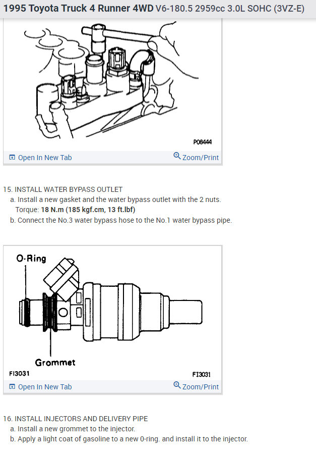

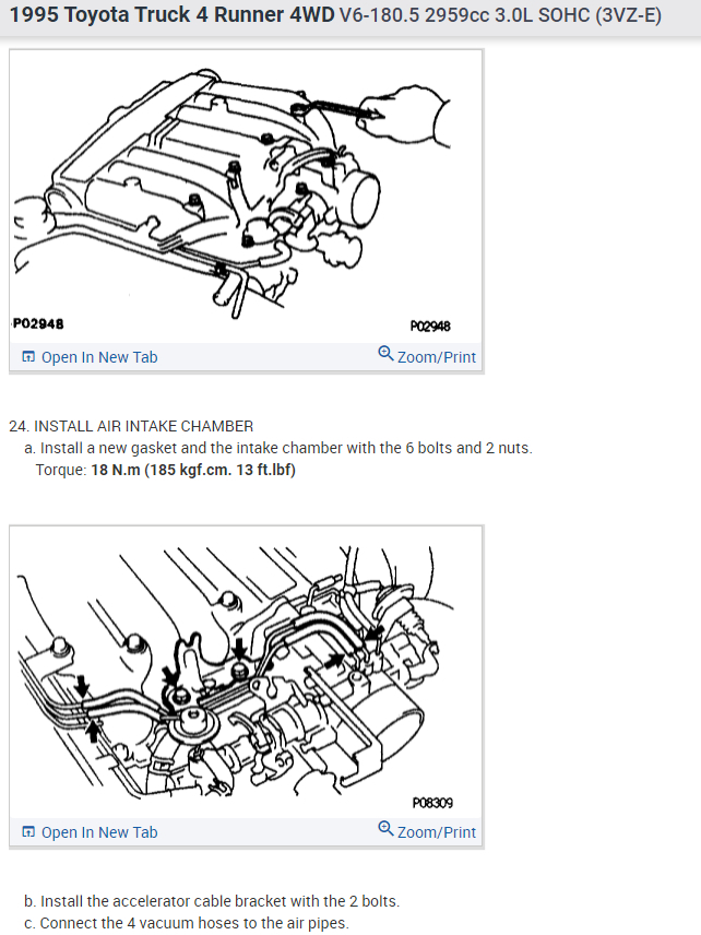

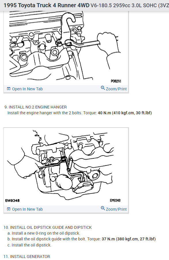

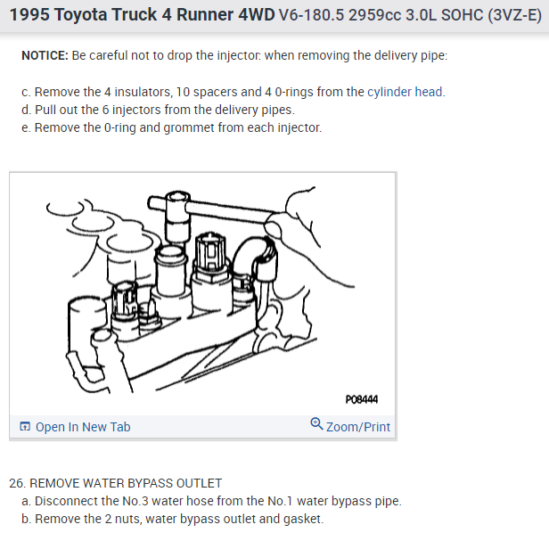

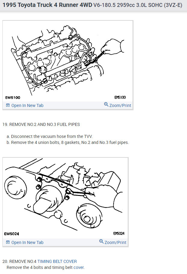

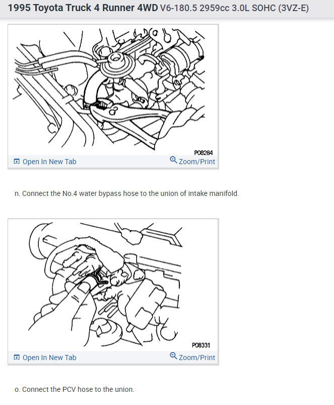

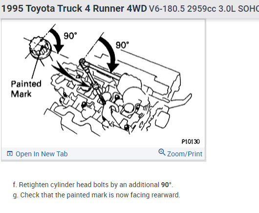

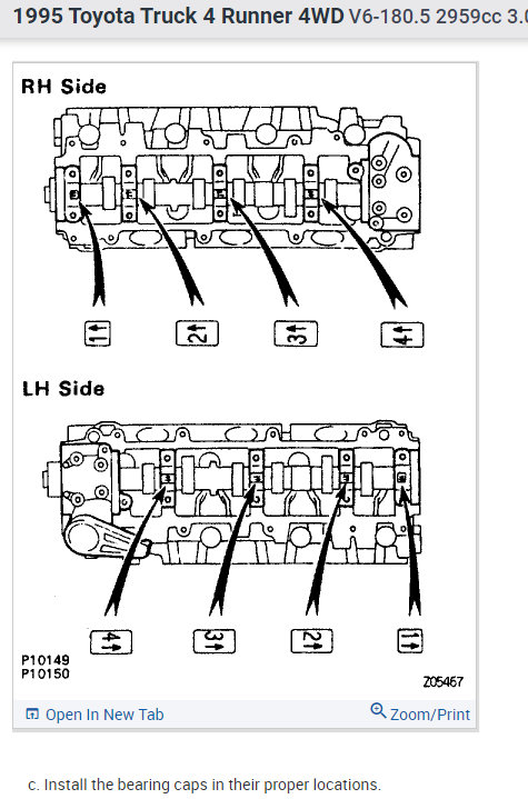

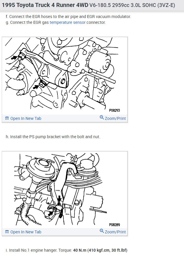

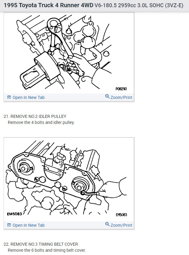

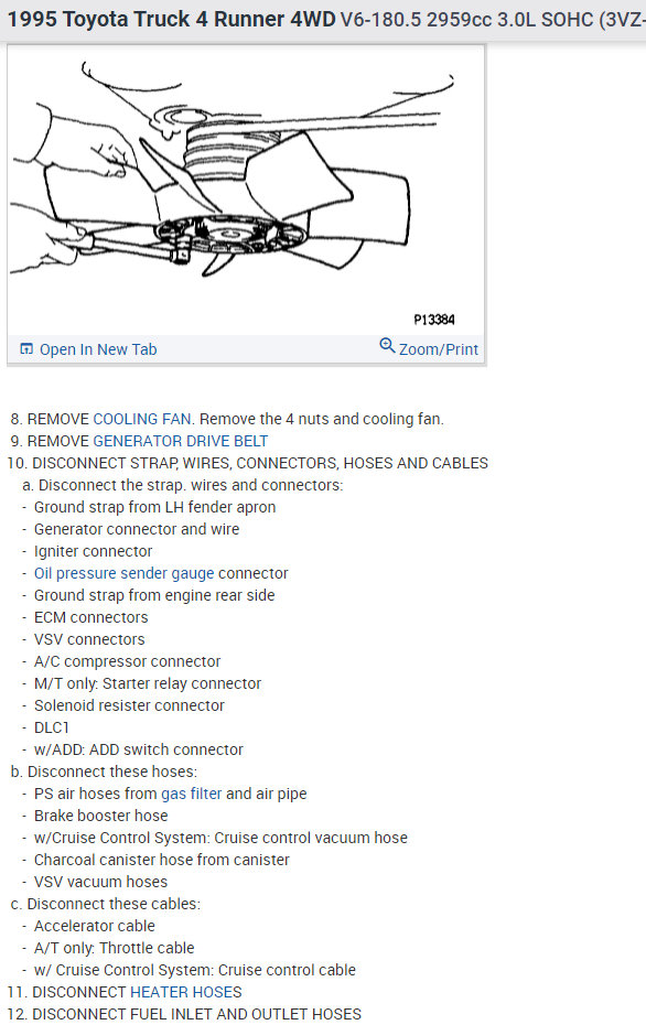

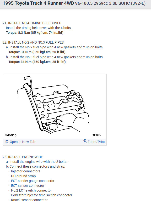

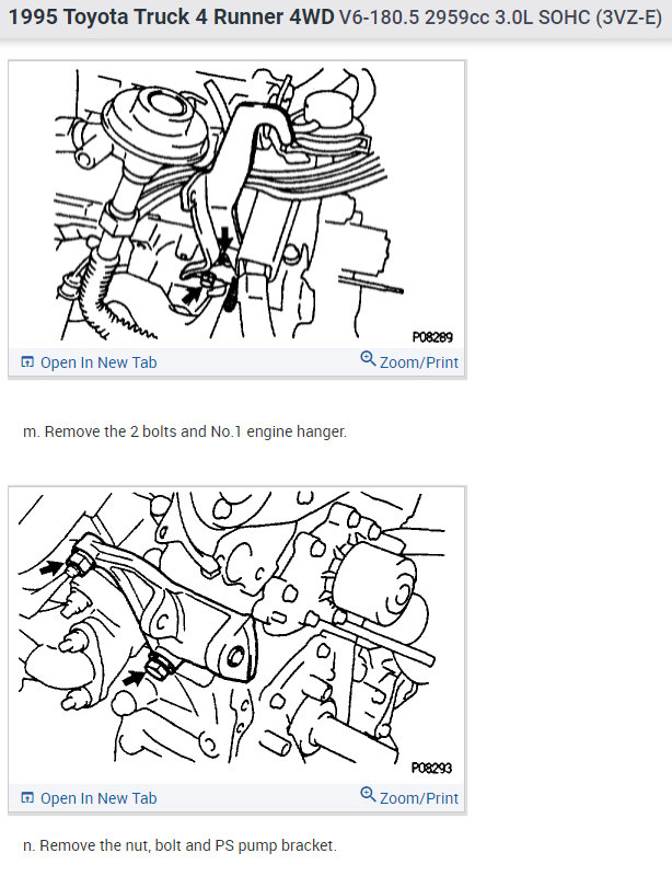

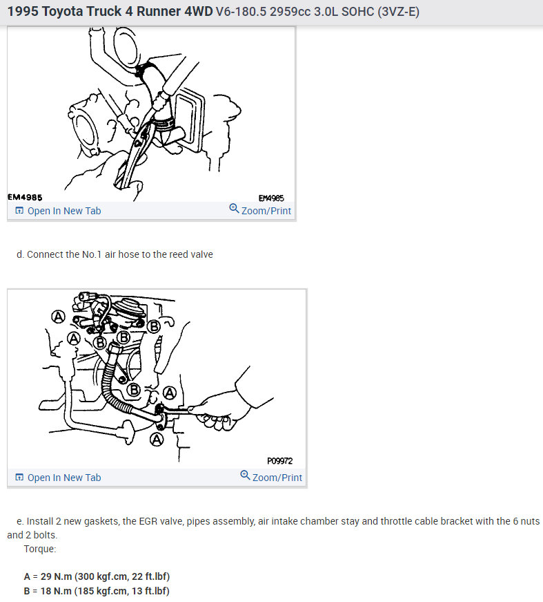

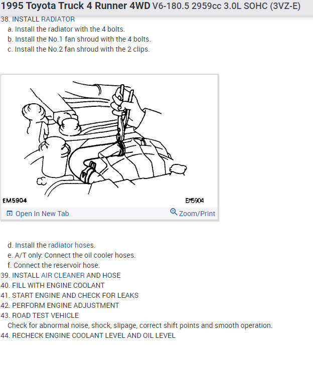

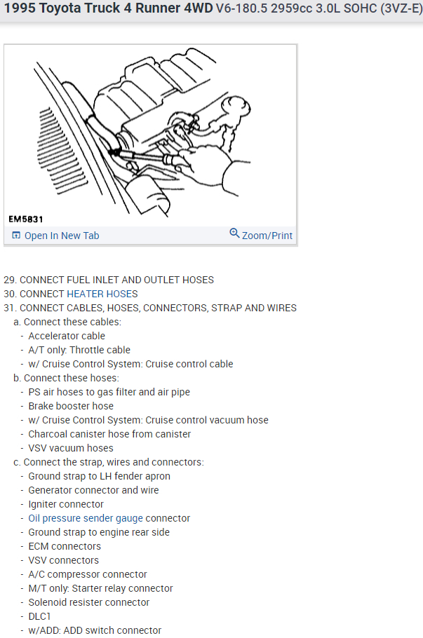

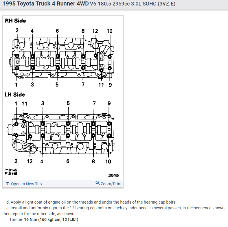

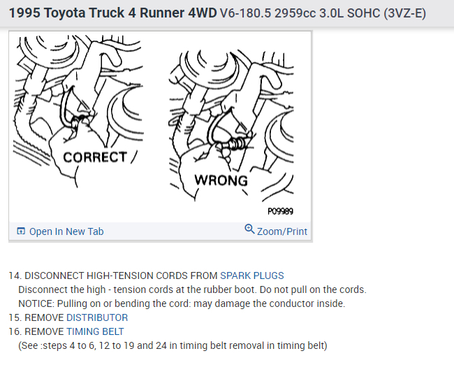

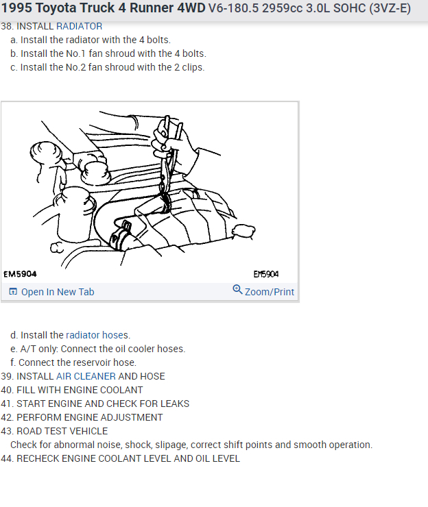

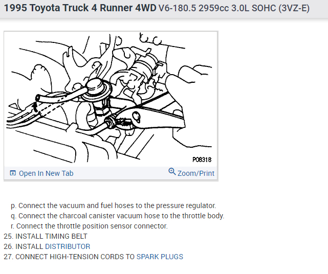

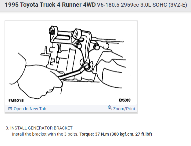

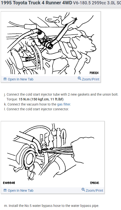

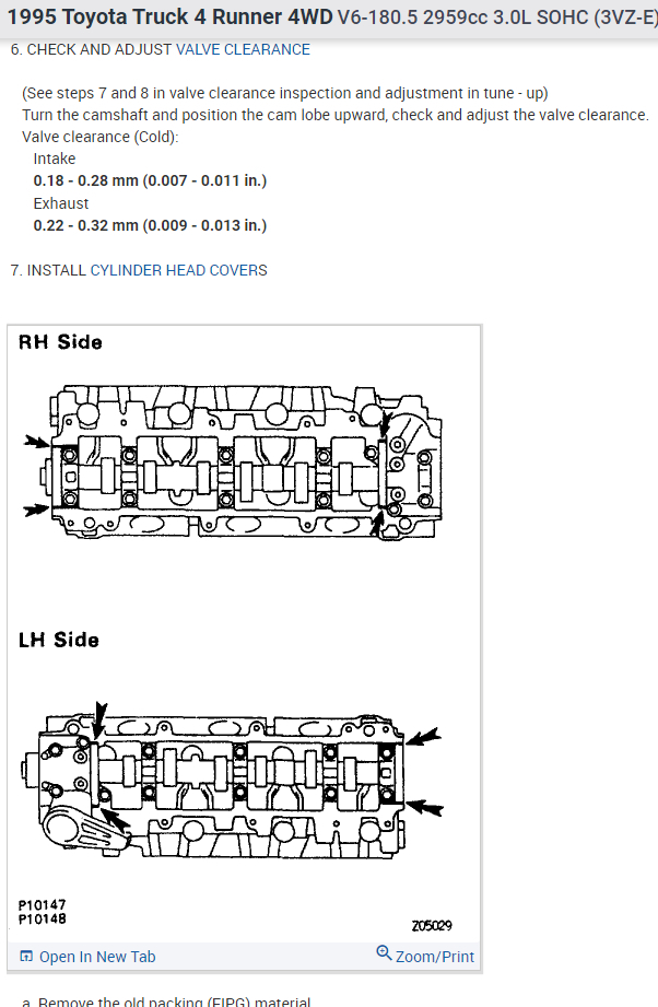

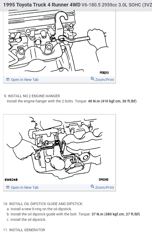

Ideally if you have a blown head gasket the best course of action is to replace the gasket and make sure the head is in good shape.
As far as using chemical sealers it is surely up to the debate.
Here is a helpful video we did on the chemical sealer:
https://youtu.be/Xi41RFMP8Ow
You can draw your conclusion from there as whether to use the sealer or not.

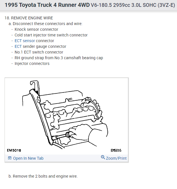

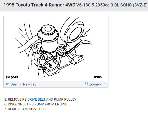

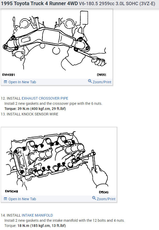

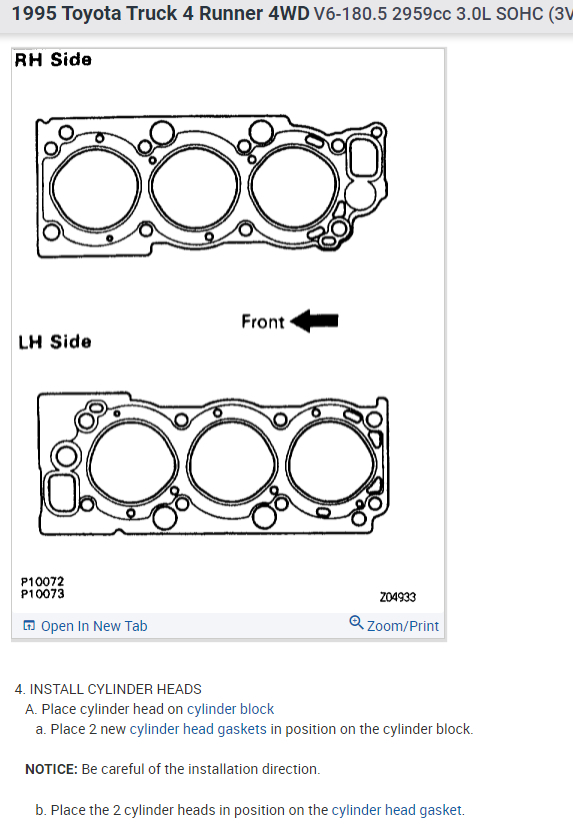

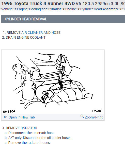

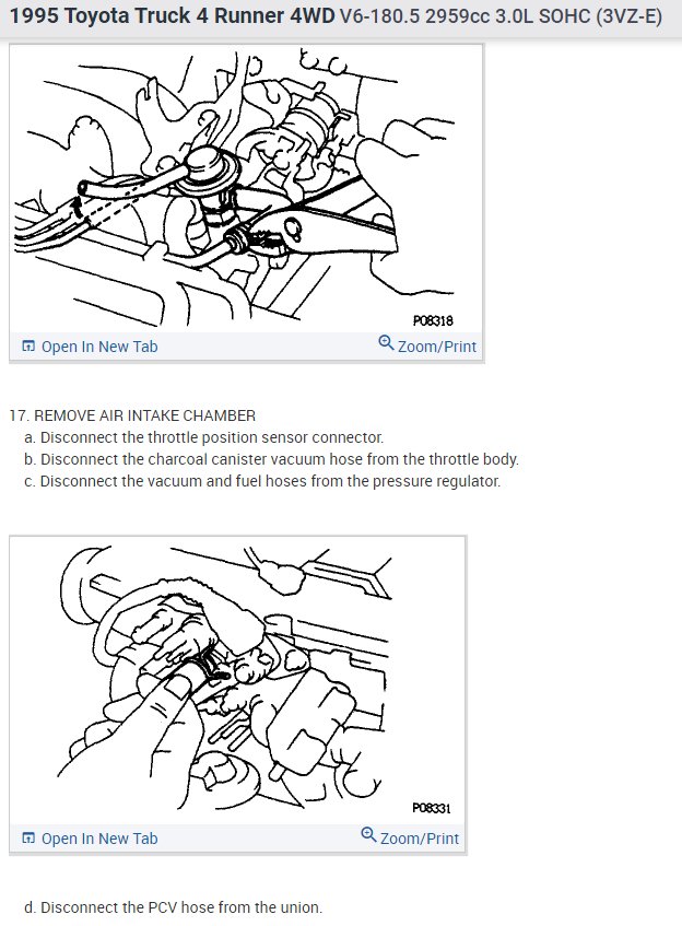

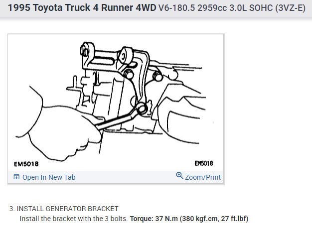

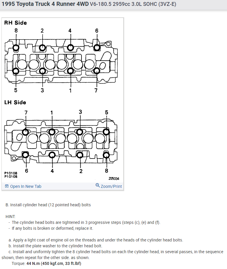

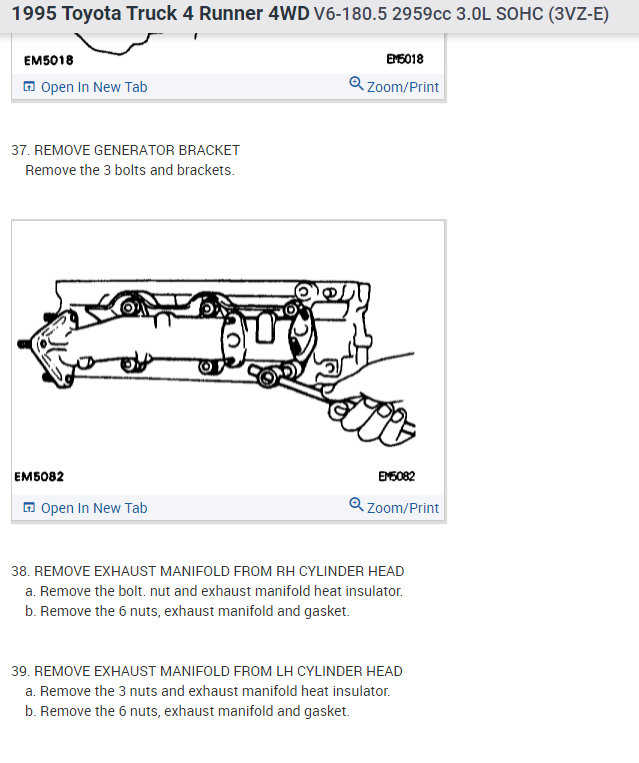

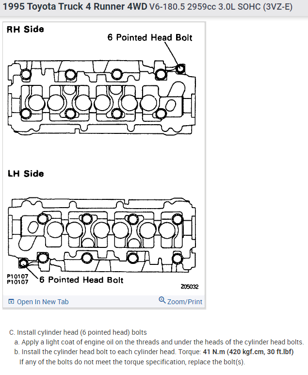

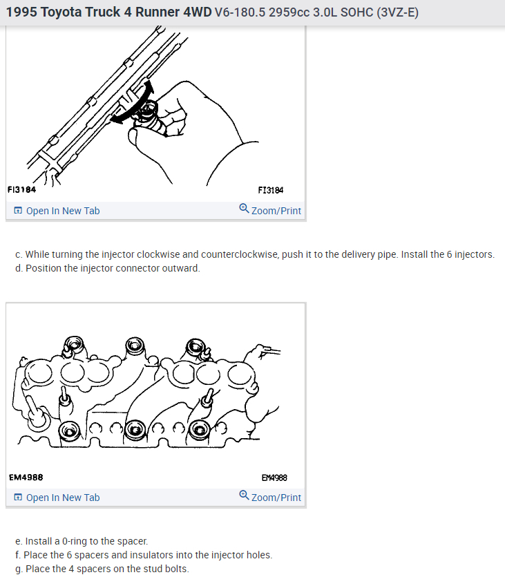

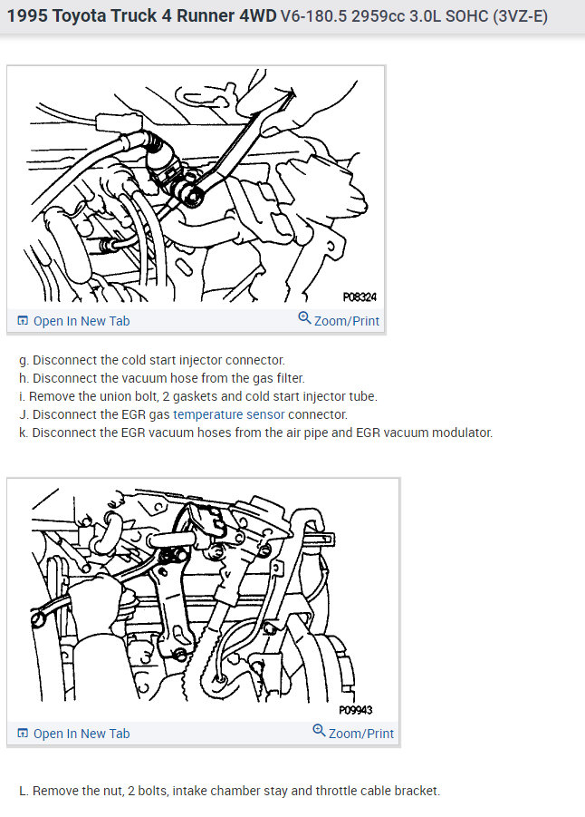

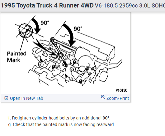

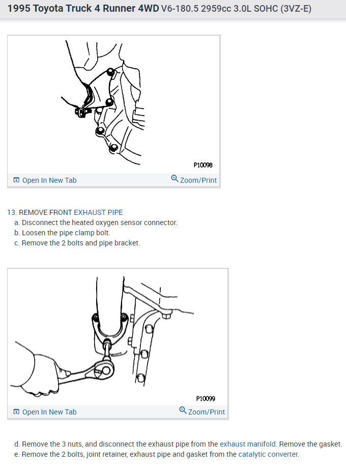

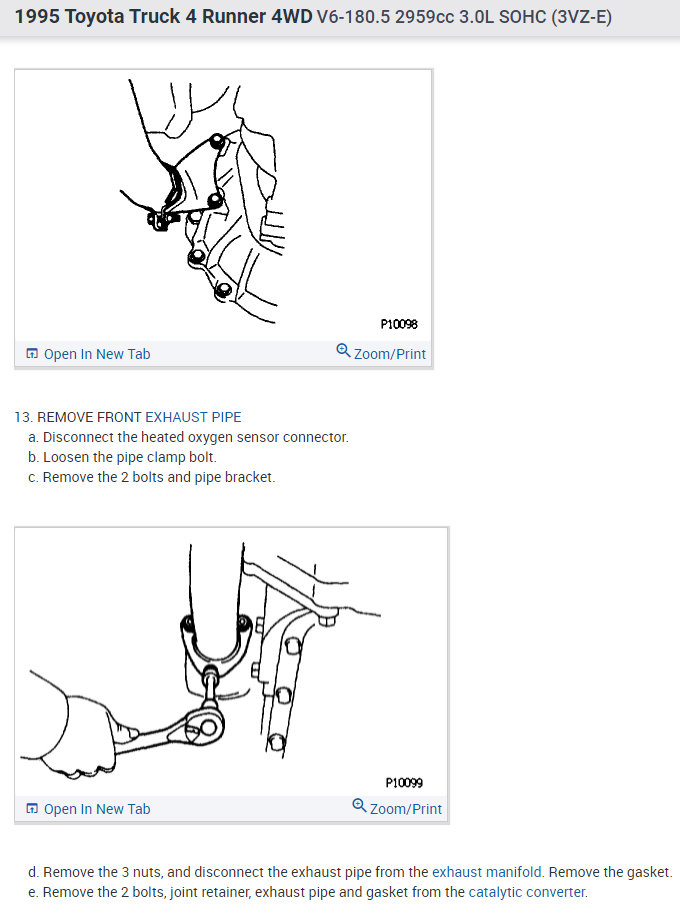

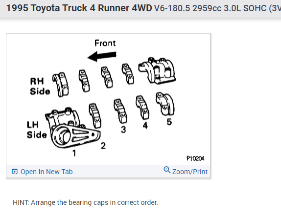

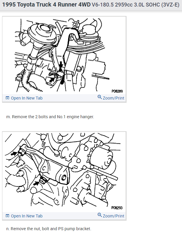

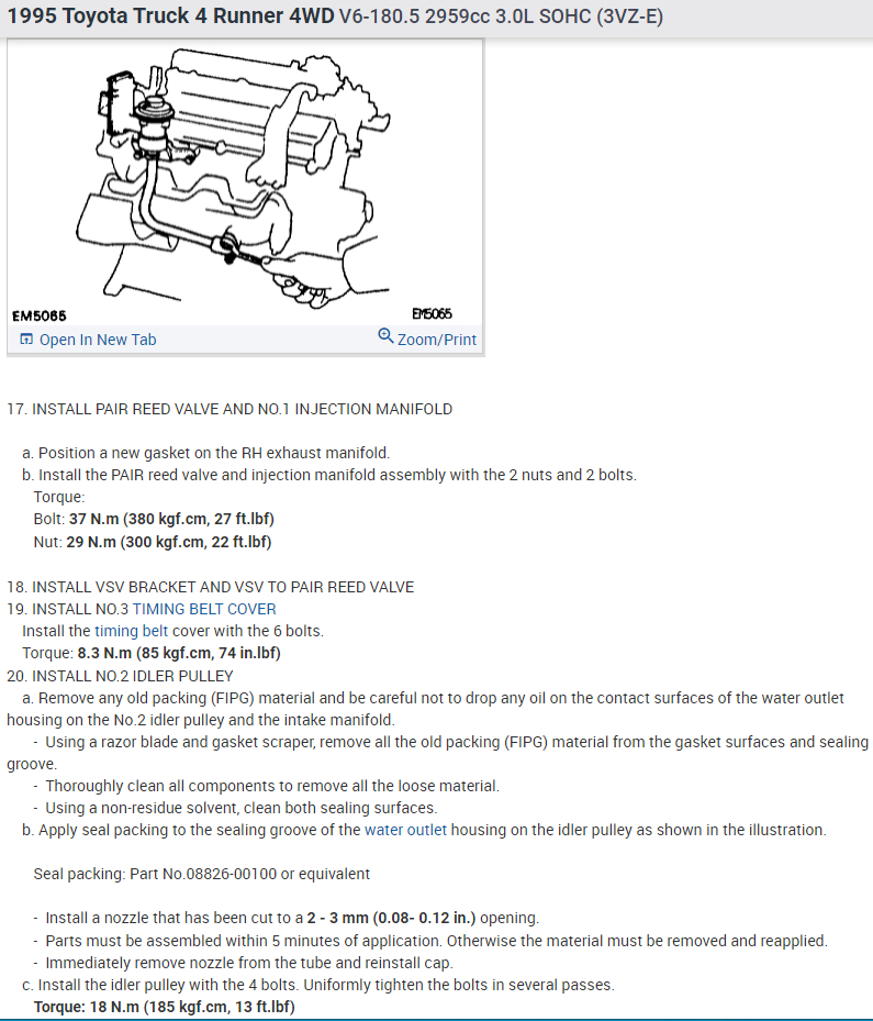

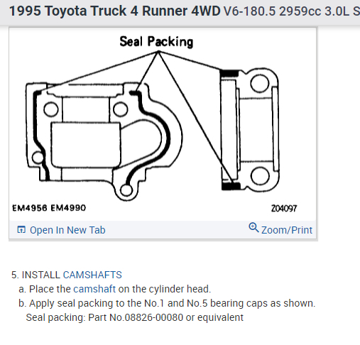

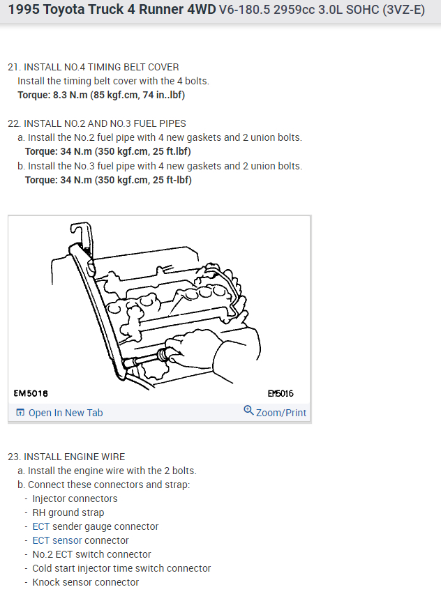

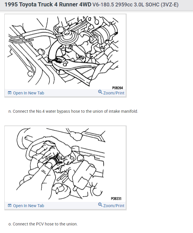

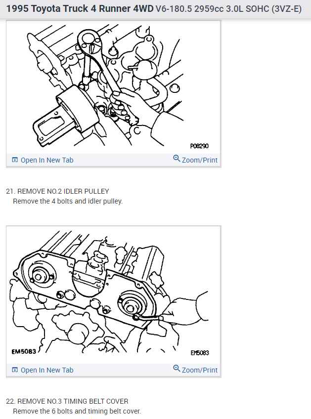

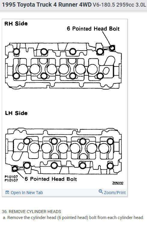

I have attached the head gasket replacement procedure for your reference.
